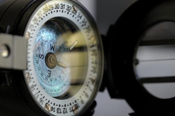

    Hi everyone,
    I recently acquired an M73 (above) from an auction website. I had used one while in the infantry 20 years ago and have been in love with it ever since. The numerous prismatic compass threads on this forum, along with other websites, have brought me up to speed with many of the technicalities of this great military design.
    Close examination of the particular copy in hand has however raised the following questions:

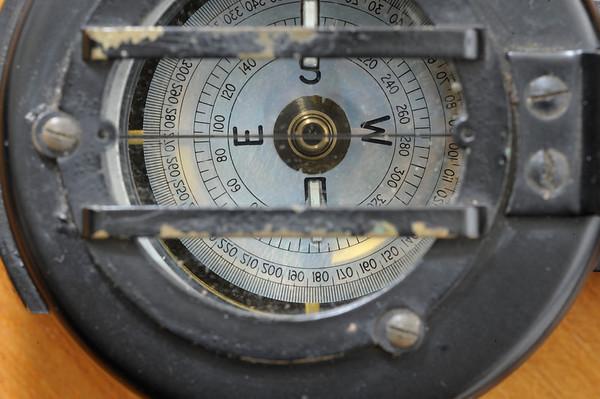

    1. When viewed directly from the top such that the hairline is aligned with the lubber line, the card pivot is slightly out of alignment with the hairline (image below). The tiny holes on the cover for tying the backup thread are also slightly out of alignment with the hairline. Do these misalignments indicate that the compass has been tampered with before, and how badly does it compromise accuracy?

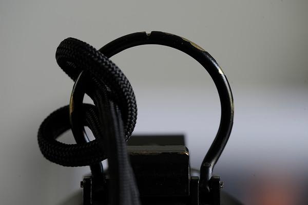

    2. On this and some other compasses I've seen online, the thumb ring has a notch at its midpoint (image below). Is this a manufacturer marking indicating a particular batch? This particular compass is engraved on the back with "M73 Pat Appl" and nothing else. As is evident from the images it is the degree version.

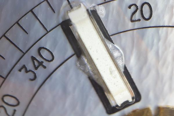

    3. The tritium capsule on the card has been affixed with a crude lump of adhesive (image below). Was this a substandard replacement job? The tritium on this compass is no longer luminous.
    4. From the images above does the card look like real mother-of-pearl? It has the green-pink sheen and is translucent. I read somewhere that later prismatics used a substitute.
    I would be grateful to hear opinions and other esoteric trivia of the M73 and its relations. Thank you!

    First, the tilted card. The axis hole in the card is slightly larger than the actual axis and this allows for the card to be moved slightly so that it will balance exactly square on the brass axis before it is clamped up. I wouldn't worry about it too much unless it becomes impossible to read the car through the prism when taking a bearing. There is a facility to focus the card readings but if you can't get it in focus..... Never noticed one where the line doesn't accurately align with the small holes you show. Will the error you show make a vast distance? I'd say no, not unless you are driving a great distance across the desert using compass stops as guidance. The notch on the thumb ring is used for aligning the compass with the grid lines on the map. That glue does look a bit scrappy but it won't make any difference to the operation of the compass. If you go along the Ayer Rajah Road where our big REME Base Workshop was, you'll find zillions of these radium dials buried where we just dumped them. No such thing as health and safety radium regimes in the 60's!!!!!
