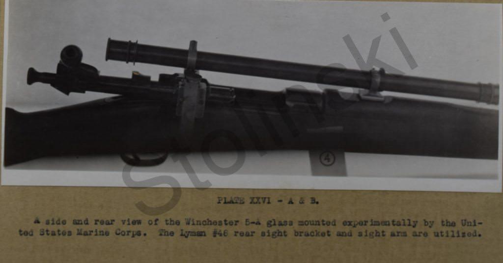

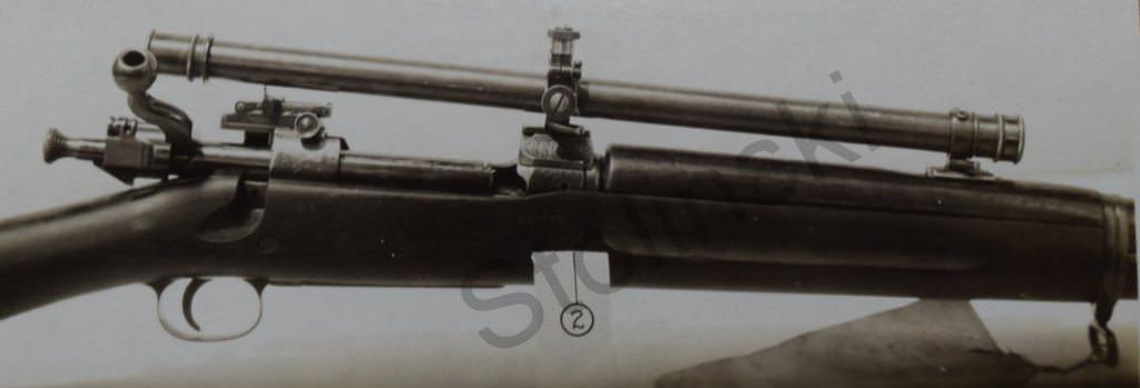

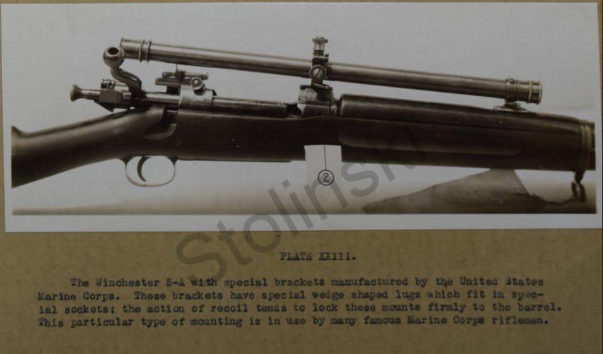

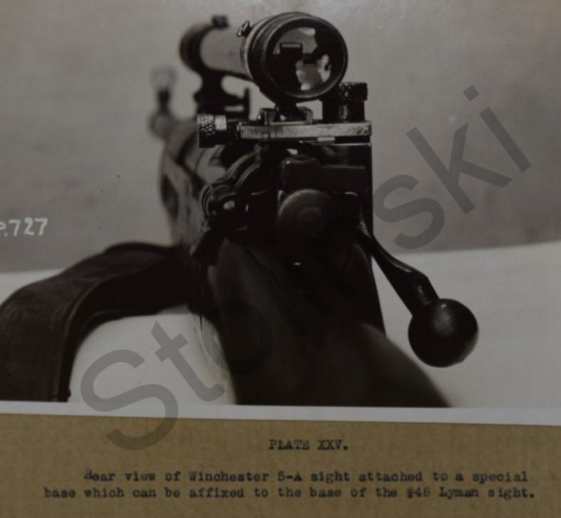

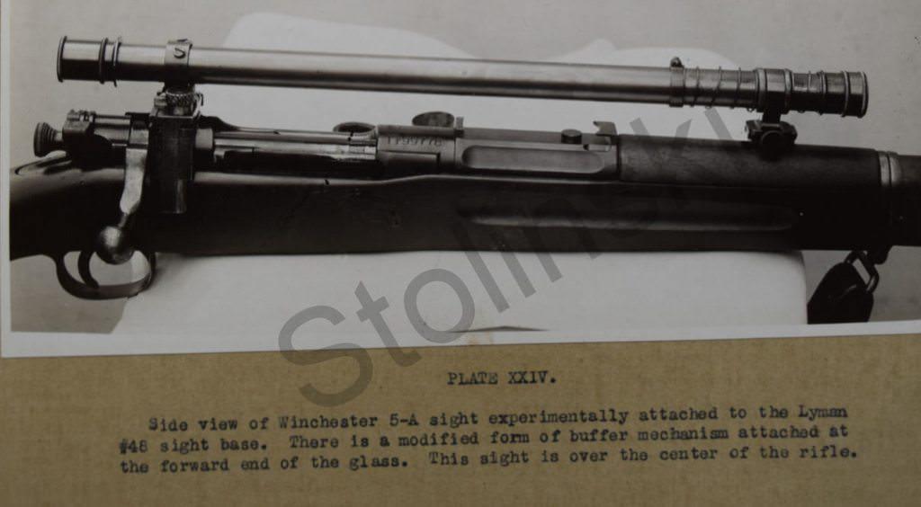

    Andrew Stolinski found these pics in the National Archives in a 1923 Telescopic Musket sight report for the US Army. It was basically detailing all the potention sniper/target variants that were out there.
    It's intersting to note that these rifles are total bubba jobs. A 1917 bolt handle welded on a 1903 bolt body. Lyman 48 receiver sights used to adjust the fixed tube A5 scope like a micrometer. Bent bolt handles to clear the scopes. Custom handguards and just weird combinations.
    Also I've seen a lot of rubber buttplates in trial photos such as this. Just a lot of items that I've heard many people say over the years were never possible.
