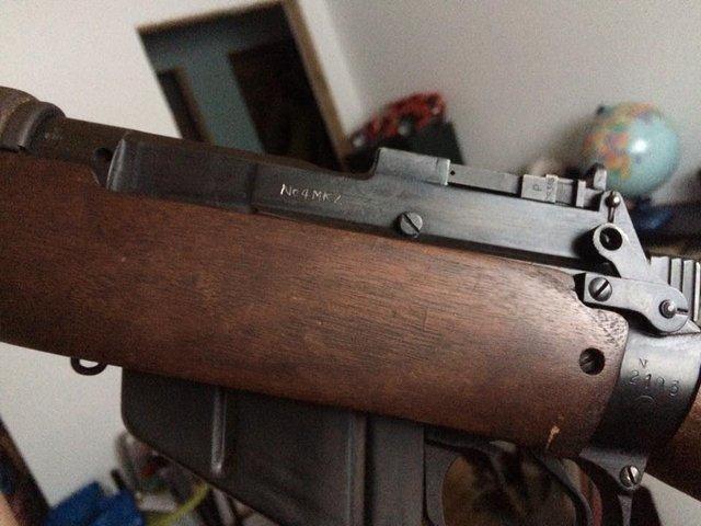

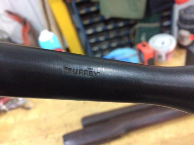

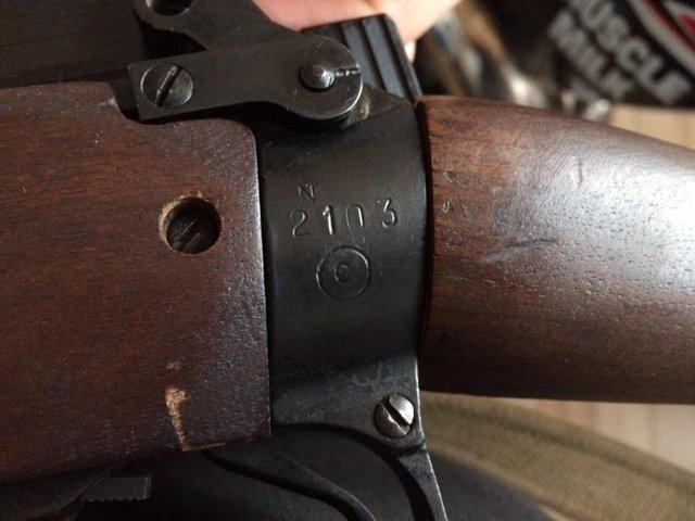

    These pictures have been doing the rounds on Facebook because the owner isn't sure what they are or represent.
    I've certainly never seen the circle with a C inside on the wrist strap of a No.4. or indeed the word SURREY stamped on the barrel.
    Canadianicon target rifle?

    Quote Originally Posted by Strangely Brown View Post
    Canadian target rifle?
    https://www.milsurps.com/images/impo...standard-2.jpg
    https://www.milsurps.com/images/impo...standard-3.jpg
    https://www.milsurps.com/images/impo...standard-4.jpg
    "Surrey" was a model / grade of sported rifle... marketed in Canadaicon
    The N prefix and lack of proper Britishicon manufacturer codings seem to be a mid/late '50s "commercial" No4Mk2 which has been previously discussed here.
    The "circled C" is not a Canadian military/competition marking, it would be an "oval C".

    Interesting to see more pictures of this one..

    07-01-2025
    07:45 PM
    I have a similar rifle with serial N1767, I was told by the previous owner that it was part of a batch of about 50 rifles hand assembled[new parts] for Service Rifle competition in the early 1960`s,my one was used in the NZicon Navy,don`t know who or where they were assembled. There is another similar rifle here in NZ. All the woodwork of mine is matching, hand numbered in pencil. Stuart.

    07-01-2025
    05:45 PM
    Maybe Naval issue, both "Surrey" and "Stuart" are names of ships.

    07-01-2025
    12:45 AM
    The "Surrey", "Suffolk" and "Sussex" conversions were low-budget sporterizations of No.1 and No.4 Rifles made up in the 1950s and perhaps 60s. I always thought they were done by Parker Hale, but perhaps not?
