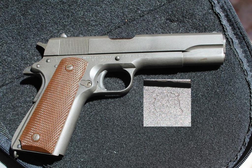

    Good Day,
    I was wondering if the knowledgeable folks on this forum could advice me on the originality of the finish on this Type II RR. Comments and opinions would be greatly appreciated. Thank you and Happy new Year!

    Nice looking pistol...

    Your Remington Rand was buffed and re-finished by parkerizing. The original finish was Dulite Blue.

    Nice gun, but it looks refinished to me.

    A refinish would probably be expected on these, though, right? Did they go through a rebuild after the war?

    Thing is...I've done lots of these in the past and there's no way to tell. I glass bead blasted them and parkerized them in both black and grey so they looked good. The stampings were still clear and they looked new. People could easily suggest they were unissued or arsenal refinished... I say there's no way to tell when this was done or by whom.

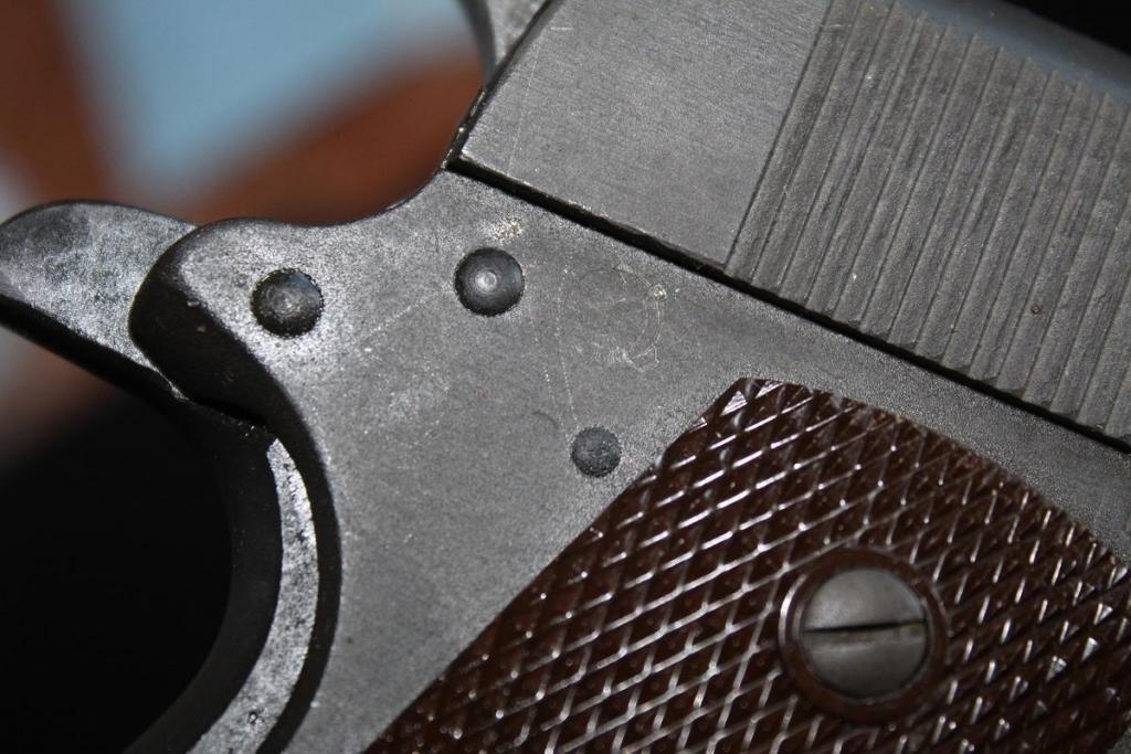

    Jim. The first thing I look at is the OC canons. They were applied after the pistol was blued.....so they should show raw metal. Sometimes you have to tilt them around a bit but the marks always show up.

    A better picture. I took it in the sun room and tilted it around a bit.

    Quote Originally Posted by John Wyatt View Post
    Very correct. It was DuLite and is not now.
