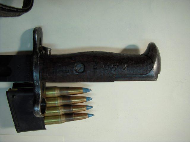

    I acquired a 1905 Springfield Armory bayonet, the right side grip has a faint point up arrow followed by a Z and the numbers 6074 (just like the article in the second post), I believe this to be part of the Lend Lease to New Zealandicon during WWII. There are no markings on the blade to indicate the lend lease but the grips appear to have been there.
