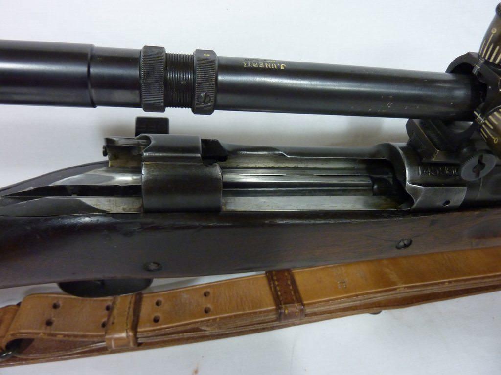

    I have a NM 1903 made in June 1928. It does not have serial number.
    I am interested in getting any information about this rifle.
    I have attached photos

    I can neither confirm nor deny that your rifle is a 1928 NM, but I make the following observations and comment for what they are worth.
    1. The 1928 NM should have a headless cocking piece and a reverse safety and yours does not.
    2. Your stock is cut for the very early Lyman 48 not used in the 1928 but may have been cut by the owner who converted it to a sporter.
    3. The bolt is not polished as it would have been on the 1928NM. From the last picture, the bolt appears to be straight handled which may indicate a SHT bolt.
    4. Someone has grafted the pistol grip and pistol grip cap on to what appears to be a type “S” stock
    5. Since your rife has had all of the markings removed (quite common in the day before the NFA) it is not possible to date your receiver. You do not show the barrel date, if it still exists, nor do you mention the star gauge mark if there is one.
    6. There is an end cap on the fore end, but I cannot see the barrel channel to see if it is filled an any way
    There are many who are more expert than I who can probably provide more complete and accurate info/
    FWIW

    Why do you believe it's a NM?
    An easy way to tell if the receiver is a NM is the rails of the receiver are polished, or otherwise in the white. Your's appear to be parked, but the pics aren't the best.
    Now if your whole receiver was refinished, it would not show the rails being polished. And without a serial hit to NM in the SRS, there is really no way to prove a receiver is a NM. All that would be left as a clue if refinished is if the barrel was star marked and had the star guage number on the top of the barrel. But they fitted star guaged barrels to standard receivers all the time. You could order them that way.
    So really without the rails looking like this below, and not having a serial to confirm it as a documented NM. There is really no way to prove it.
    ---------- Post added at 06:38 PM ---------- Previous post was at 06:33 PM ----------
    Cosine26 was spot on with his analysis as well. From these pics it appears to be more of a sporterized standard rifle.
    Is there a star guage record number on the top of the barrel, usually under where the handguard would be. It should be a letter followed by a number, like say B 123 or G 1245 . A letter and number combination like that.

    It the receiver was actually made in 1928, it should be of nickel steel. If of SA manufacture the letters "NS" will be stamped on the flat behind the recoil lug on the bottom of the receiver. If the receiver was made at Rock Island, it would be before 1928 and, if of NS would be stamped "NS" on the front of the receiver ; however, it is necessary to remove the barrel to see it. It also looks to me (hard to see) that the stock lacks the forward stock bolt which would make the stock fairly early - well before 1928. The butt plate is hard to see but it may have the fine checkering present on pre-WWI rifles.
    I do not know where they came from, but many of the old SHT receivers were available on the commercial market before WWII and were used by some small companies to make cheap sporters. The markings were removed to hide the fat that they were of the SHT. R.F. Sedgley Co. was noted for this and offered many but none used the "S" stock. Look through the preWWI American Rifleman magazines and you will see them advertised.

    I don't see any (or much, anyway) that the OP's rifle appears to be a National Match. I would say more likely, a former service rifle modified.

    Good chance this is an R.F. Sedgley sporter rifle. They did nice work and sold them off at decent prices.
