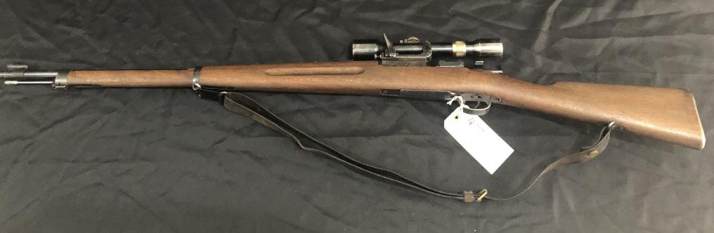

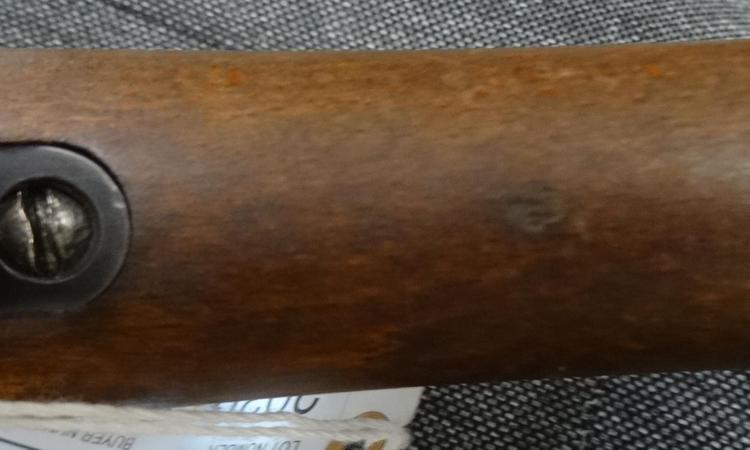

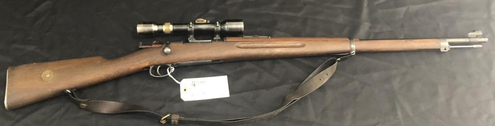

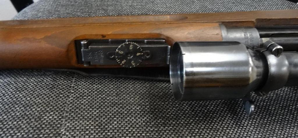

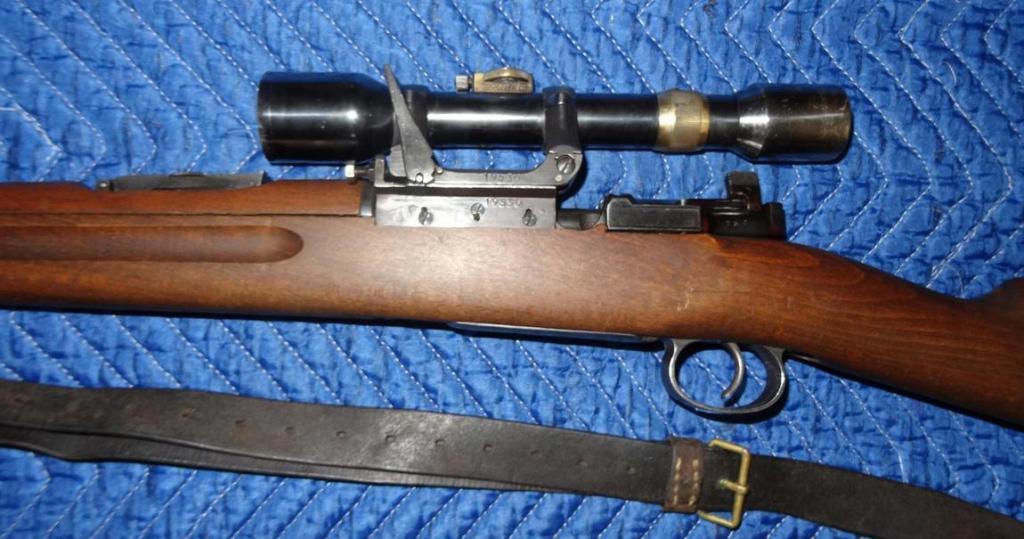

    I went out on a limb this weekend and bid on a Swedishicon M41B at an online estate auction. The auction pics were few and not that great and the description very spare, but I bid accordingly.
    Here are the pics...
    Description advised that it is a "Mauser Carl Gustafs 1899 Sniper Rifle".
    I'll post better pics and description when I get it, but anyone have any thoughts based on the auction pictures?
    Thanks.

    thus far it looks really good. certainly one of the best milsurp vintage sniper rifles. The AJACK scope is real deal as well as that mount. Staked correctly. Those are some of the best scopes re: glass quality. Correct font for the mount and base from what I can see. the Scope is a 1941 year (~2000 made in `41, 2000 made in `42). The scope turret looks properly proofed. Not sure about the stock but it appears not to have been sanded. Should be the cartouches behind the trigger guard. Small parts will probably be mismatched as they usually are but it could be correct. Bolt is blued which is correct for the B version. Stock disc will uncover the bore quality, but based on the stock, it could be really nice. Sling is incorrect for this rifle but it's better than nothing. BTW: buying an M41/b is never going out on a limb unless its a fake and this one appears to be the real deal. nice grab

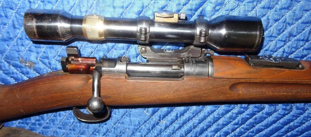

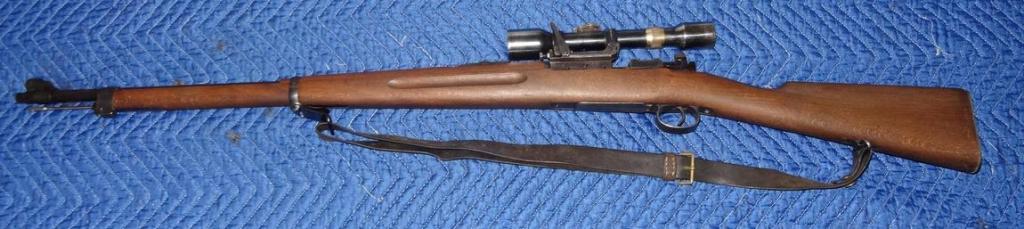

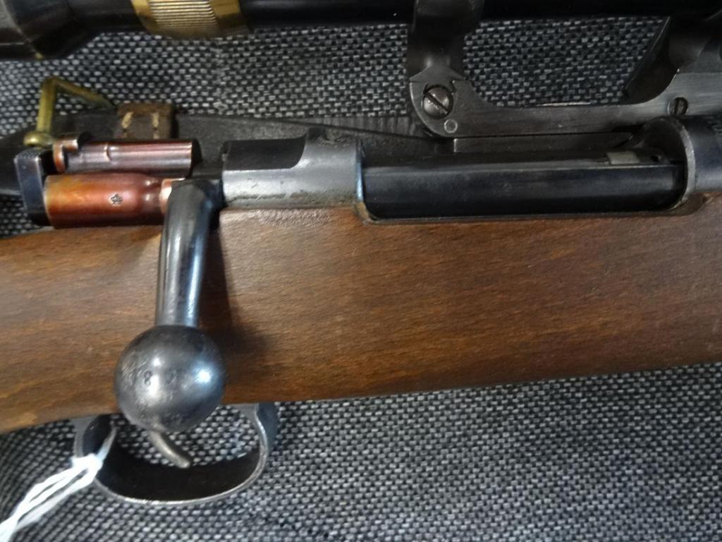

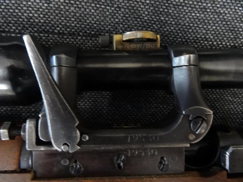

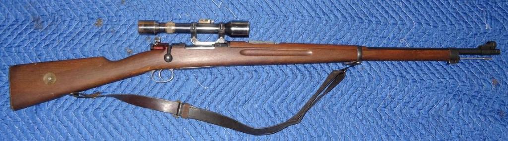

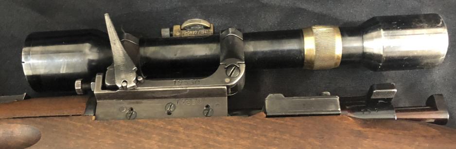

    The M41B arrived at my FFL today. I got a chance to grab a few pictures before it went into the safe for the 10 day "cooling off" period.
    It looks legit...
    Bolt is blued and matching (body). The bolt sleeve, cocking piece and safety match each other, but not the bolt body.
    There is an M55 adjustable rear sight mounted
    Base and scope mount serial number match (19530) and appear to be correct for the receiver date (1899)
    Stock apprear to be beech replacement (common for these rifles, I'm told) and has a single crown cartouche behind the trigger guard.
    Scope and mount appear to be correct for the M41B
    Anyone see anything out of place?

    Hardening, not "bluing"
    Yes, that really does look convincing.
    Quote Originally Posted by speckles View Post
    To avoid possible misinterpretation, it is not a decorative or protective surface "bluing" but a result of the hardening treatment of the steel (high nickel content ???). My S&L target rifle has the same bolt coloring, as does the trigger on my LP08 (a.k.a. Artillery Luger).

    I could swear one of the swedish armorers once said they used a dulite black oxide for the bluing process to protect against rust on the steel. I think I can find the thread somewhere but I remember the high nickel content will leave the steel a plum color.

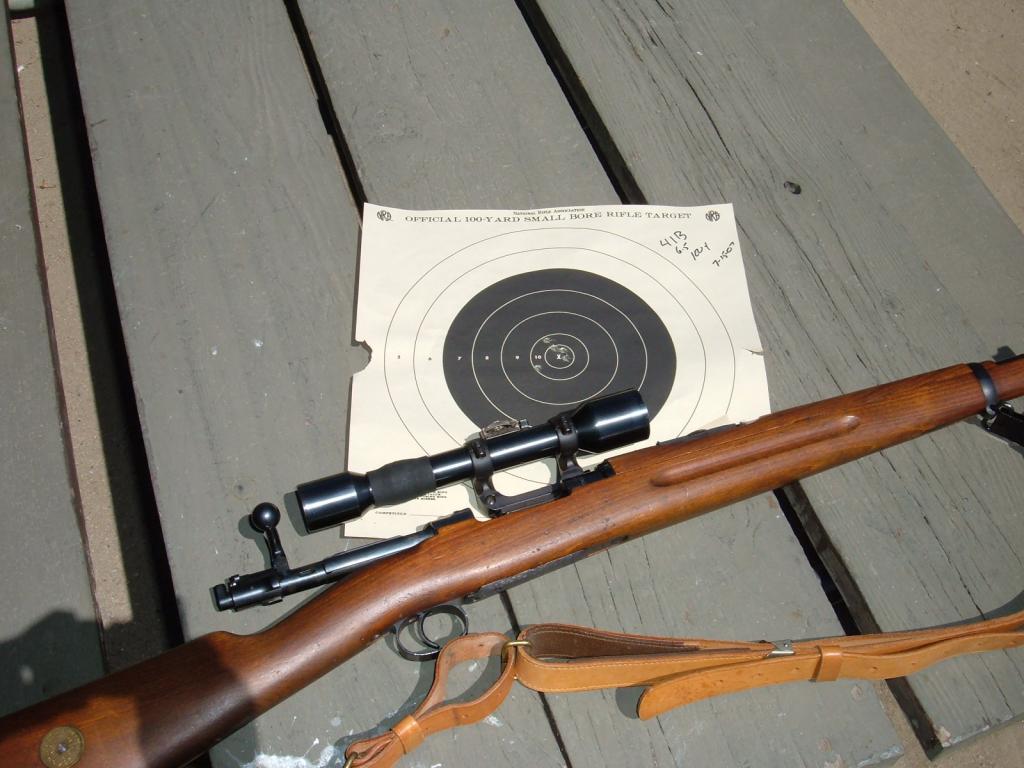

    Nice looking rifle and great grouping, MJ1
