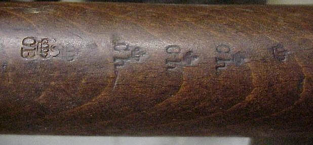

    1. Trigger is not numbered, but will usually have a crown stamp:
    There are actually 3 different types of crown stamps depending on where the part was manufactured. If your parts are all CG they will have a straight up crown with a flat base like shown in the photos above.
    2. The first crown on the stock behind the trigger indicates that the rifle was test fired and sighted in. Each additional crown with a letter or letters below, indicate repair work has been done and at what facility. There may be multiple stamps here.
