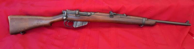

    Looking for any info on this heavy barreled Enfield.
    Is it common to see a heavy barrel on an Enfield receiver? The barrel is dated 1943.

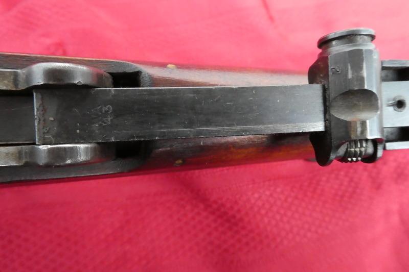

    The rear sight leaf has WA 43 stamped on the bottom and the bolt does not match.
    Let me know what you guys think.
    Jon

    Hey it looks like a genuinely rebarrelled 'H' SMLE. I see plenty with Heavy barrels but they all lack the 'H' stamp on the very front of the butt-stock like this one. I see a big old date stamp or something on the butt-stock which I am guessing is either an FTR or a normal repair, but either it might be when this rifle got this barrel and was changed to a 'H' rifle. Then it looks like someone turned it into a No5 look-alike.

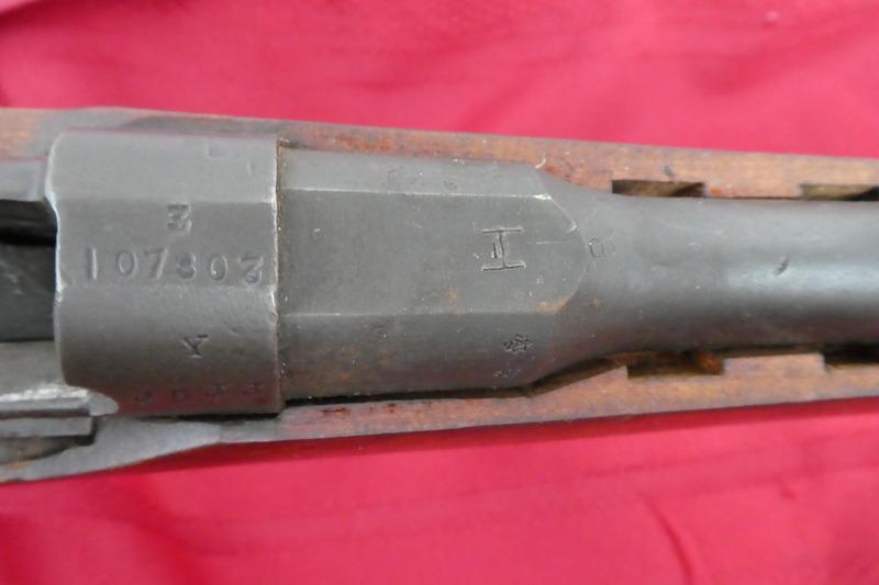

    Butt stamped R* over* MA* over* 3/47 which I take it to mean that this rifle was set up at Melbourne Arsenal Mar 1947 under a refurbishment program. H on knoxform. Barrel not serial numbered.

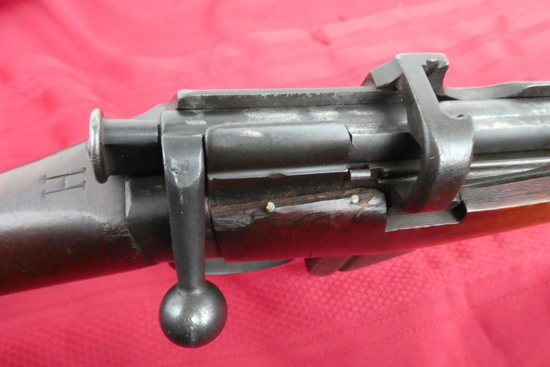

    Rearsight* made MA 43 but never serial numbered. H on wrist top. Britishicon bolt*
    numbered 500, not numbered to rifle BUT the rifle has that greyish Australianicon finish and so does bolt rib and handle.Rifle arsenal greased on parts under wood.

    Bottom of sight leaf has WA 43 = "WA Wellington Annexe" and 43 is when the leaf was made?
