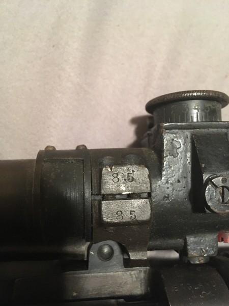

    The serial # on the underside of the stock near the muzzle is the same as the ones on the bolt handle & receiver ring, the scope serial does not match & neither does the # on the mount. The stock is really Beautiful, however the 3rd sling keeper is missing from in front of the magazine. The screws on the front pad are peened [1 each] I can't tell about the rear pad because I really don't want to remove the mount just to see, basically I don't want to mess my new baby up. The leather connecting "arm?" that connects the front & rear lens covers has ripped off, wasn't there when I bought it but these covers look way too good to be old so I'm guessing that this part is a repro.
    This screw is painted red, any idea why? I found out that a painted red W means waterproof & a painted blue B means bloomed, but haven't read anything about a red screw.
    Also don't really know what Bloomed means LOL.

    Superb score. Yes, do ask about scope case (steel or canvas), wooden rifle chest "No. 15 Mk. I" and even the M1907 U.S. leather sling (dark leather, original, often dated 1918, with brass claws). Do not be afraid to remove the scope. Lay rifle across your knees with the two big round knobs uppermost. Gently turn them counter-clockwise. When both are disengaged from the scope pads (but still in the bracket, lift off the scope.
    If you cannot find the sling that came with it, watch for a genuine (preferably) U.S. M1907 leather sling (standard for WWI and early WWII). Brass claws for WWI are preferable but steel claws WWII dated one is fine as both versions were used. You can use a replica M1907 of course but they are very pale compared to the originals.
    For the record, here is information on your rifle and scope to make it easier to search for in the future. Please correct me if I have made any mistakes.
    YOUR RIFLE: F37263 (on body, bolt and fore-end), Fore-end number with correct by not having prefix letter and is lengthwise. Made by BSA Shirley (M47C) in 1944. Has "TR", "S", "S51" and "T" markings. The wrist is stamped with the number of the scope that was assigned to it at Holland and Holland (S51 was their wartime code.) was 16668
    YOUR MISMATCHED BRACKET AND SCOPE: Bracket has "JG" (Rose Brothers) SN to rifle R33899 and scope cradle caps 84/84 85/85
    Scope No,. 32 Mk. III OS. 2039 A Serial number 16726 made in 1944 by AK&S. This model apparently was first issued in October, 1944.
    Unusual FEATURES: There appears to be "1945" stamped very faintly above the rifle serial number on the bracket. On the underside of the grip it is stamped with maker's initials "S.L" over a large upside down "V" as in ^ over a 6-pointed star. (Weedon? - Usually found on overhauled rifles I believe but rifle appears to still be matching butt,body. bolt. fore-end.)
    It is a typical mismatched set as sold surplus about 1970. The main large surplus dealers reportedly did not know or care about matching scope to rifle. I checked my research database and there is no sign yet of rifle R33899 that matches your scope and bracket, or of scope 16668 that matches your rifle.
    Eventually if you dismantle the rifle for detailed cleaning and examination you should find:
    1. On butt, once out of the body socket, the numbers of the serial number 37363 stamped into the top ledge. Instructions for removing the butt are on my web site at: https://captainstevens.com/military/...i-t-furniture/
    2. On barrel the year (e.g. '44) and serial number
    3. On inside of hand guards and fore-end, possibly the last three digits of the serial number in pencil.
    ONE CAUTION: DO NOT FORCE THE TURRETS! The grease in them often hardens. If force, it can cause damage. If they do not turn easily, contact Brian Dickicon in South Carolina http://bdlltd.com/contact/

    Quote Originally Posted by NearSightedSniper View Post
    'Bloomed' is a coating on the lens's to improve light gathering
    The red screw on the scope is a desiccation screw
