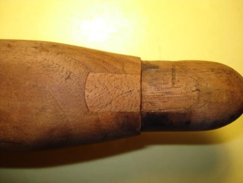

    Weapons techs have been known to put WarPig1976's Dutchmen of solid wood(that's literally a wood insert) in years. Not veneer though. Veneer is thin stuff and costs too much.
    painter777's big picture of the crack(1st picture) is easily fixed with a needle style epoxy applicator and a clamp.
