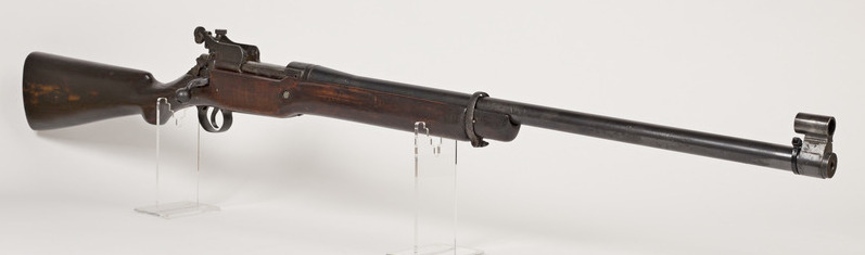

    It somewhat is "known" that Estonia had Enfield P.14 rifles in usage as sniper rifles. So far though no one could tell me which scopes they used and how these rifles actually looked like.

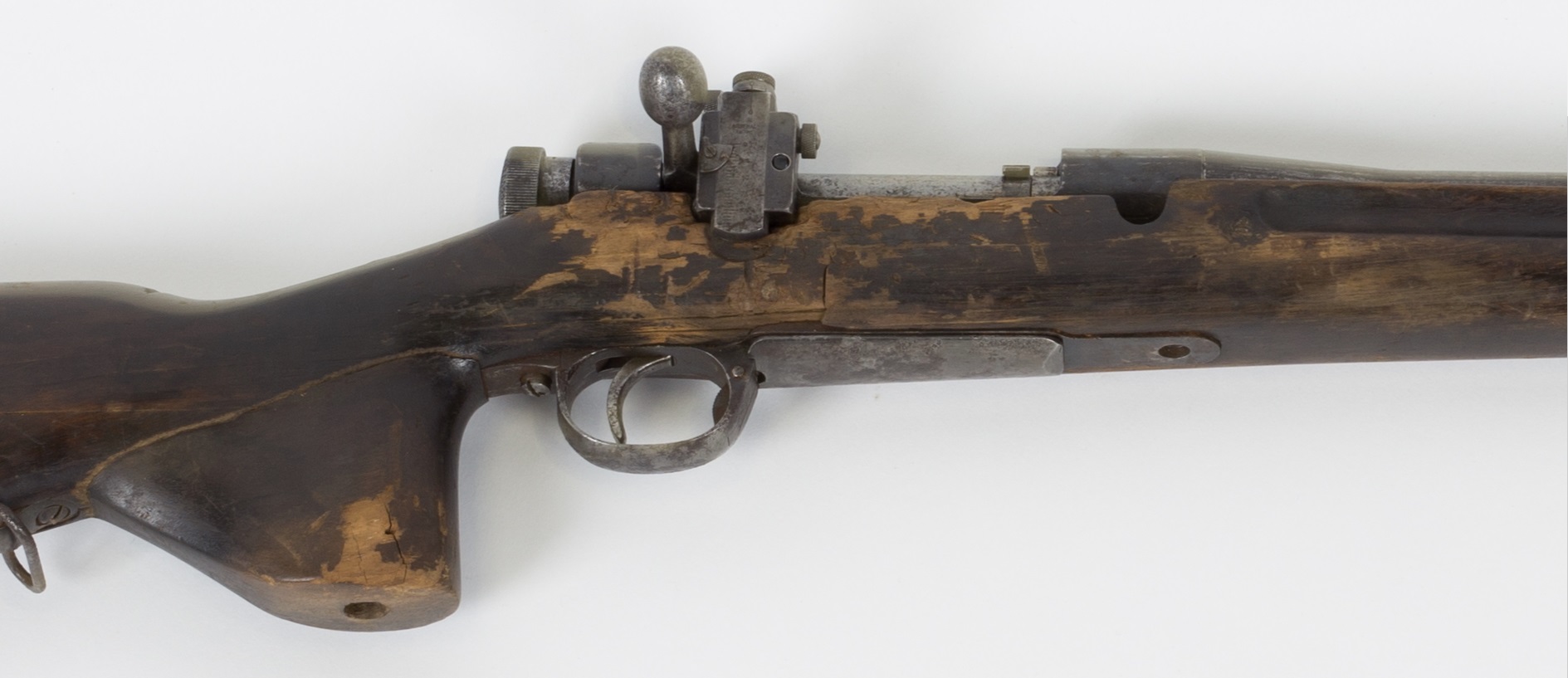

    For not being able to speak Estonian, some other parts are very tough to understand and read. But for what I could gather, most of what Estonia used as "sniper rifle" was not a rifle equipped with scope (since those were more expensive than the rifle, like three times higher than the actual rifle), but with a peep sight. Plus that the Estonian "sniper rifles" were set up using the Mosin Nagant M1891 action, as well as Japanese Arisakaicon M1905 and Enfield P.14 actions. The modifications usually included heavy barrels and a cut down stock. And actually I was able to find picture sources for such an Arisaka as well as Remington P14 peep sight sniper rifles in the possession of public museums in Estonia:
    Arisaka Sniper: Museums Public Portal - Arsenali sõja-täpsuspüss M1931, ümber ehitatud jaapani Arisa...
    Enfield P.14 Sniper: Museums Public Portal - Arsenali sõja-täpsuspüss M1931, ümber ehitatud inglise Enfie...
    I'm still trying to learn more on the rifles with scopes. Aside of a single contract for 100 scopes only that Estonia ordered with Carl Zeiss of Jena in Germanyicon in 1937, which were delivered in 1939 and were mounted by Tallinn Arsenal factory - accordingly on Mosin Nagant, Arisaka and P.14 actions. If these were also modified actions (like with different barrels, cut down stock, etc.), I honestly don't know for the moment. But maybe more information will turn up in future.

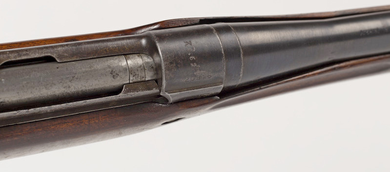

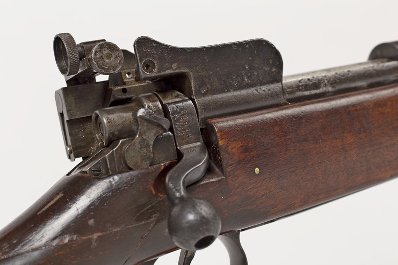

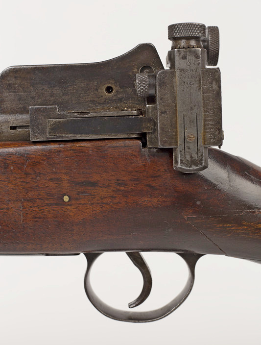

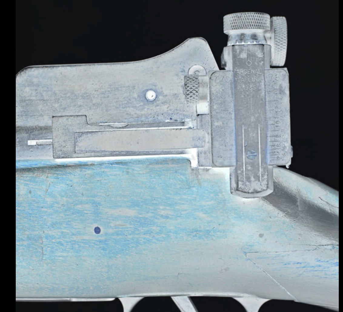

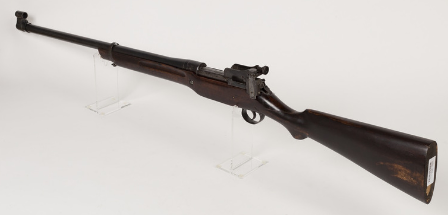

    Interesting, but given that the stock has been so extensively reworked, or entirely replaced from the wrist back (note the joint), the configuration of the barrel and the type of sights fitted, I'd guess it was a target rifle rather than a sniper's issue.
    The fact that there was no standardization on one type of rifle would also suggest target rifles for inter-service(?) competition etc. rather than sniper's use.
    One can see a Parker Hale or A.J. Parker sight appears to have been fitted to the P14 before the present one - which is marked "ARSENAL TALLINN 1935".
    Another question would be why the Estonians were converting such rifles to 7.62x54R when their standard service cartridge was .303BR ? Perhaps using up stocks of that cartridge in competition rather than their service cartridge held as war stocks?

    I quoted the answer for the caliber. More than half of their rifles were 7.62x54R caliber, hence it would be logical for me to modify others to the same caliber.
    Regarding target use/sniper use: Estonia was not the only country to prefer fine adjustable peep sights as sniper rifles compared to scopes. Norway did the same (aside of the 1910 contract for 500 scopes by Voigtländer) and continued this until post WWII. Even the M59F1 Norwegianicon sniper rifle had the peep sights as primary sights and the scope as an aid put on the side. And if Estonia only had 100 scopes as late as 1939 it seems logical to me they did use fine adjustable peep sights for snipers prior to that.

    It's certainly not impossible or without precedent, as you say, but the look of stocks, barrels and foresights would make target use the most likely bet IMHO.
