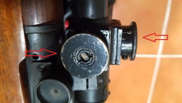

    Pic below of what I think is the drums. Sorry if I'm incorrect. But if so, these should rotate freely left to right? Will it have a clicking noise when rotated?
    Thanks again
    Jr

    Yes those are the range and deflection drums. They should turn freely with slight resistance. You should "feel" it click as it turns, accompanied by a slight audible click.

    Great. He will be checking that for me soon. If they are frozen any est. on a repair?
    Thanks
    Jr
