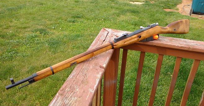

    Long story short I got this rifle from my brother a couple of years ago who had bought several M91/30 of various years of production from a local shop. I had wanted a 91/30 but life got in the way and it seemed ever time I had some spare cash something always came up so I missed out on getting one when they were cheap.
    I had already own a really nice M44 which he didn't have so he sold me one of his 91/30s to finance the M44 purchase. It's a 1933 Tula HEX receiver all parts matching and the bore is basically between a grade 1 & 2 not perfect but close.
    The only thing I didn't like about the rifle was the stock finish which was starting to show its age so I refinished it to make it a blonde stock which I had always liked, plus you can see all the stock marking much better with the lighter finish. While I was at it, I free floated the barrel bedded the action and corked the front barrel rest.
    I think she turned out nice.

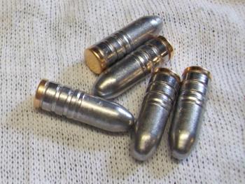

    I haven't put any jacketed rds. through the rifle since I've owned it, I've been casting my own handgun and rifle bullet for more years than I can remember so I just want to make this a cast bullet shooter only rifle and find a couple cast bullets it really liked and stick with them.

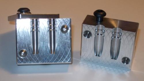

    The Lee .312" 185 gr. RN bullet is a good bullet in this rifle, the mold actually cast pretty close to .314" and thats what I size it to after powder coating, My favorite bullet is the Accurate .314" 215 gr. FN mold I picked up a couple of years ago. It's not really designed to be a long range bullet but more of a hunting type bullet that will hit hard an crush bone without breaking up if you use the proper alloy.
    Accurate .314" 215 gr. FN mold & bullet coated with clear PC.

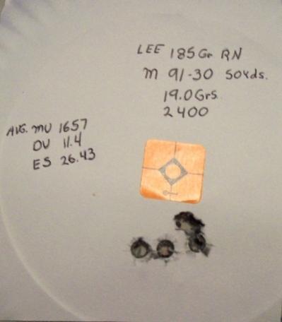

    First 5 shot test target.
    Lee .312" 185 gr. RN Clear PC.
