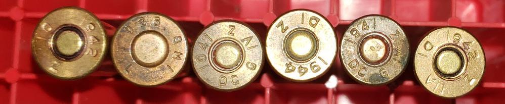

    Hi Everyone
    Have some 303 rounds I would like to identify. Any help is appreciated. Thank you in advance.
    Is the ammo collectable? Should I shoot it?
    1st
    Brass case, copper bullet, magnet does not stick.
    Headstamp: "1942" or "1943" at 12 o'clock, "DI" at 7, "Z" at 5.
    Red tip. Tracer?
    2nd
    Brass case, silver bullet, magnet sticks to bullet. Horizontal crimps half ay down neck
    Headstamp: "SMI" at 12 o'clock, "936" at 7, "L" at 5.
    Red tip. Tracer?
    3rd
    Brass case, silver bullet, magnet does not stick.
    Headstamp: "1941" at 12 o'clock, "DC" at 9, "G" at 6, "IV" at 5, "Z" at 3.
    White tip.
    4th
    Headstamp: "1944" at 12 o'clock, "DI" at 7, "Z" at 5.
    White tip.
    5th
    Headstamp: "1941" at 12 o'clock, "DC" at 8, "G" at 6, "iv" at 5, "Z" at 4.
    White tip.
    6th
    Headstamp: "1942" at 12 o'clock, "DI" at 9, "VII" at 6, "Z" at 3.
    This has been polished cleaned. Looks like there may have been a colour on the bullet tip at one time.

    1) DI - Defense Industries Verdun Canadaicon 1943 DOM Ball round Mk7 (Z = Nitrocellulose propellant)
    2) SMI - Societa Francaise des Munitions 1936 DOM! As for the L it may mean drill round as thats all I could find on it.
    3) DC - Defense Industries Quebec Canada 1941 DOM G = Tracer IV = Mk 4 Z = Nitrocellulose propellant (White tip! could only find Red, Blue, Black)
    4) DI - As (1) 1944 DOM Mk 7Z Ball round
    5) DC - As (3)
    6) DI - As (1 & 4) Standard Ball round.
    DOM = Date of Manufacture
    The silvery coloured projectiles are just nickle as copper was in short supply for obvious reasons.
    Best to take pic of the bases much easier for us less typing I'm pretty sure I've got them right others may come in.
    Note * They will all be mecuric primed if you shoot them (Which I would'nt) you'll need to have warm soapy water down the barrel from the chamber end then clean as per usual method for fouling, as the salts from the primer will start rusting your barrel pretty much straight away as for the rounds put up on a shelf as a display dont clean them leave the patina om them.

    The DI Z ammunition will be Boxer primed, non-corrosive.

    Thanks everyone. Although I am confused about the red tipped ones. Are they only ball? I would assume that they would by tracer or...?
    ---------- Post added at 11:40 AM ---------- Previous post was at 11:38 AM ----------
    Also is this some kind of home made hack job where someone tried to make some kind of HP/SP round????

    SMI Societa Italiano Metallurgica, Italianicon
    Red tip and L in hs on Italian .303" IDs tracer

    Go here. It's just about where the ammo was made.
    Cartridge Headstamps
    Defense Industries Verdun used 'DIV'. 'DI' and 'DIL' is Defence Industries Montreal, Quebec.
    "...They will all be mercuric primed..." No, they won't. The best .303 Ball I've ever fired was 1944 vintage DA(Dominion Arsenal). Non-corrosive.
    "...Should I shoot it?..." It'll be collectable if it's in the original box. Most ranges will not let you shoot trace of any kind. They think it starts fires. Does if the range is really, really dry.
    "...tried to make some kind of HP/SP..." After both Wars, hunting ammo was both scarce and expensive. Ball, as in FMJ, ammo has never been allowed for hunting. Some hunters tried to turn cheap milsurp Ball ammo into hunting legal ammo by cutting off the points of an FMJ. It doesn't work as the jacket is thicker and isn't designed to expand.

    As promised, but as usual took me some time!
    Legacy Member Light Infantry's Avatar
    05-26-2025 @ 05:24 PM
    93
    10:28 PM
    Here you go!!
