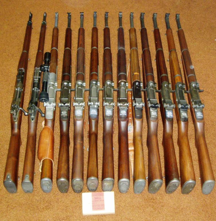

    photos of my mid 1942 M1 rifle
    M1icon rifles will always have receiver color variations based on many factors from service use, oil and cleaning to camera angles and light. here are some photos of my mid 1942 receiver, barrel is May 1942 dated and stock is short channel SA GHS (faint cartouche) Type 1 lock bar sight is originalAttachment 111685Attachment 111686

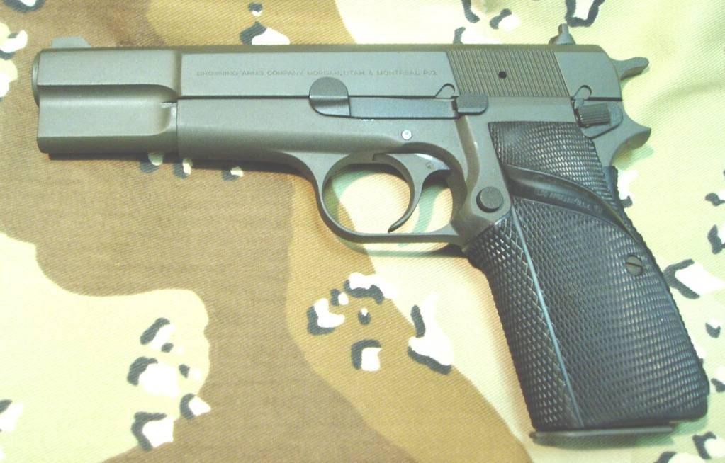

    Zinc was used during WW2, manganese came later. If an M1icon went thru a rebuild/refinish after the switch to manganese, that's what it got.

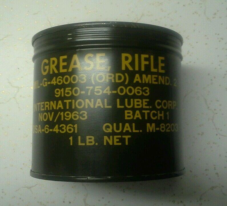

    The color you get will depend on several factors. With fresh solution and correct immersion time, it will be a very dark slate gray. If you spray it with WD-40 while it's still hot, it will get even darker. You can even achieve the WW2 green tint by swabbing with the old green GI rifle grease. That's what I did to the Browning High Power pictured below years ago.
    As you can see in this pic, the color can vary quite a bit. The really light gray M1D was dry packed after refinish and the solution was probably not fresh either. The black one is manganese. It came from the CMPicon that way.
