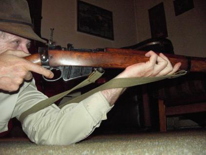

    Try the "spot weld" (something I was taught as a recruit at Fort Dix when the M14icon was brand new). The cheekbone rests on the thumb of the firing hand, providing consistent head position.
    The "combless" Lee-Enfield stock was designed for an upright head position that was in fashion during the late 19th century and early 20th. Face contact is along the side of the jaw rather than high on the cheek. In the offhand position, it's actually a reasonably solid and comfortable position once learned.
    The observaton that this is very different from US rifles is accurate only for US stock designs adopted after WWI. As can be observed in the image below, the critical distance from line-of-sight to comb is actually slightly greater with the original 1903 Type S stock than with the Lee-Enfield. The '03 Type C and "scant" stocks do have a higher comb, as do the similarly-dimensioned M1 and M14 stocks.
