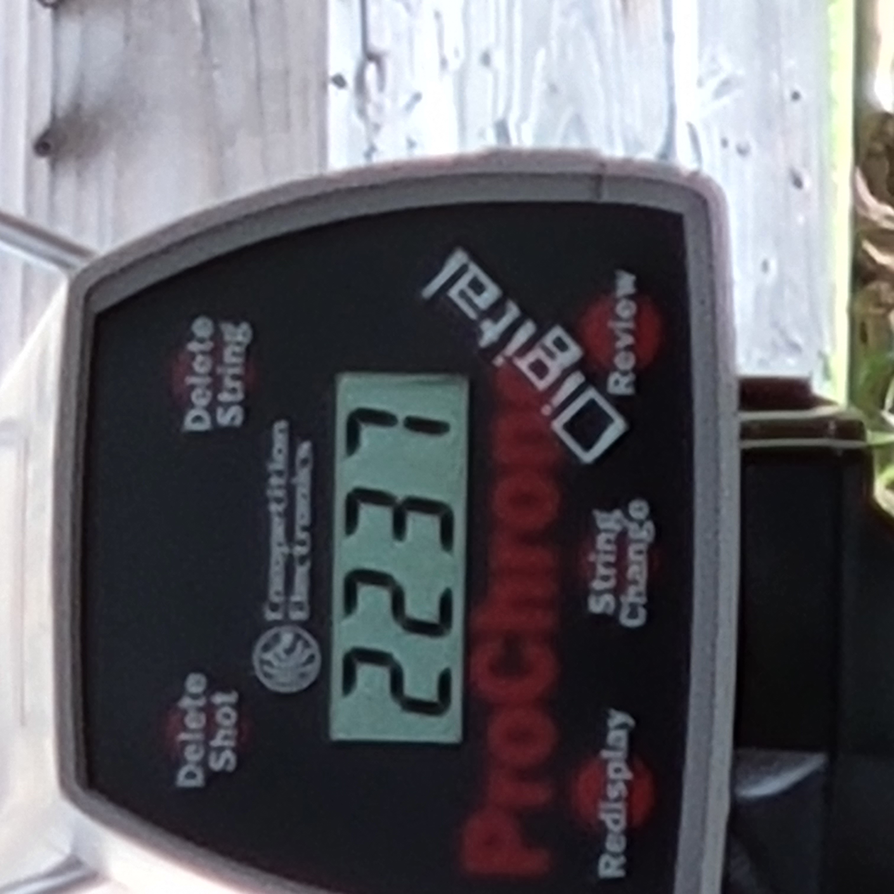

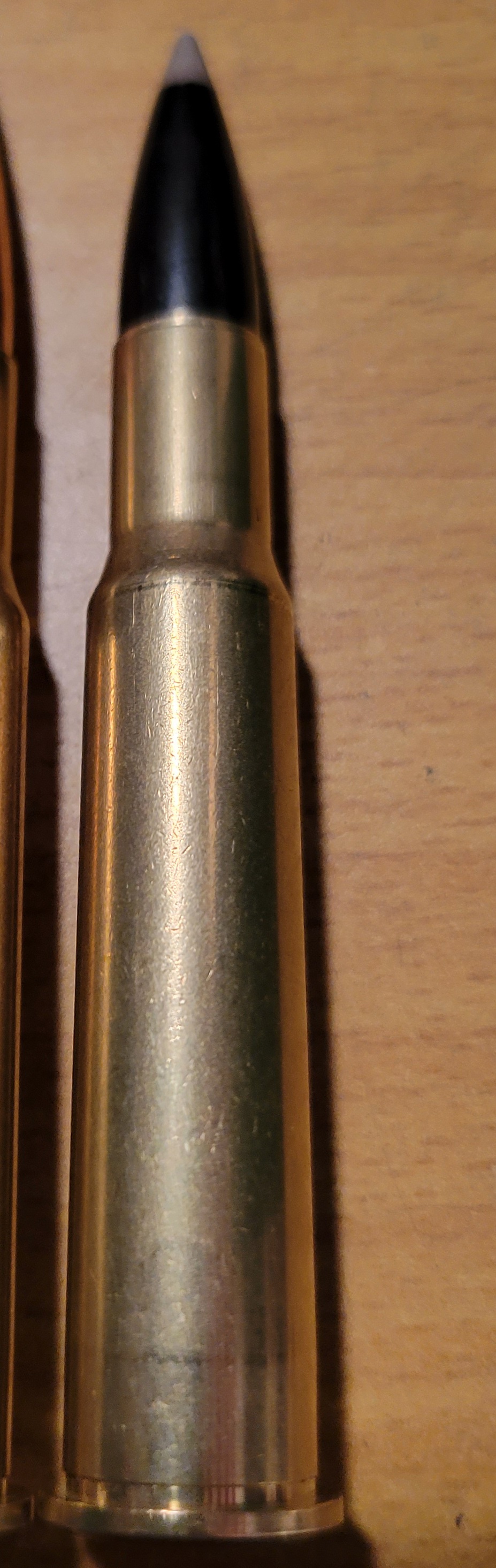

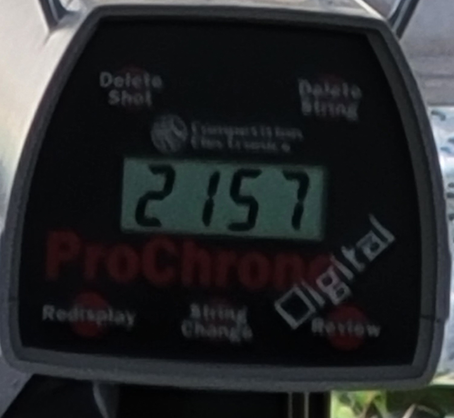

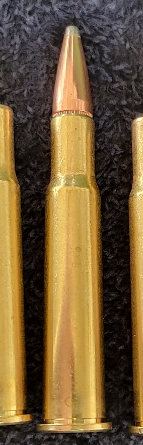

    With the shorter barrel I wouldn't be so concerned about using a slower powder. You would do very well with a 180gr bullet and a 4895 or a 4064 powder.. I have a 1903 rifle with the 1901 sight. Having a 30" barrel the slower powder does it justice. It gave this result with IMR 4350 pushing Hornady 180gr flat base Spitzers between 2100 and 2200fps on the orange dot. The green dot is Nosler 180gr Silvertips same powder and charge weight but giving another 100 fps and slightly better accuracy.
