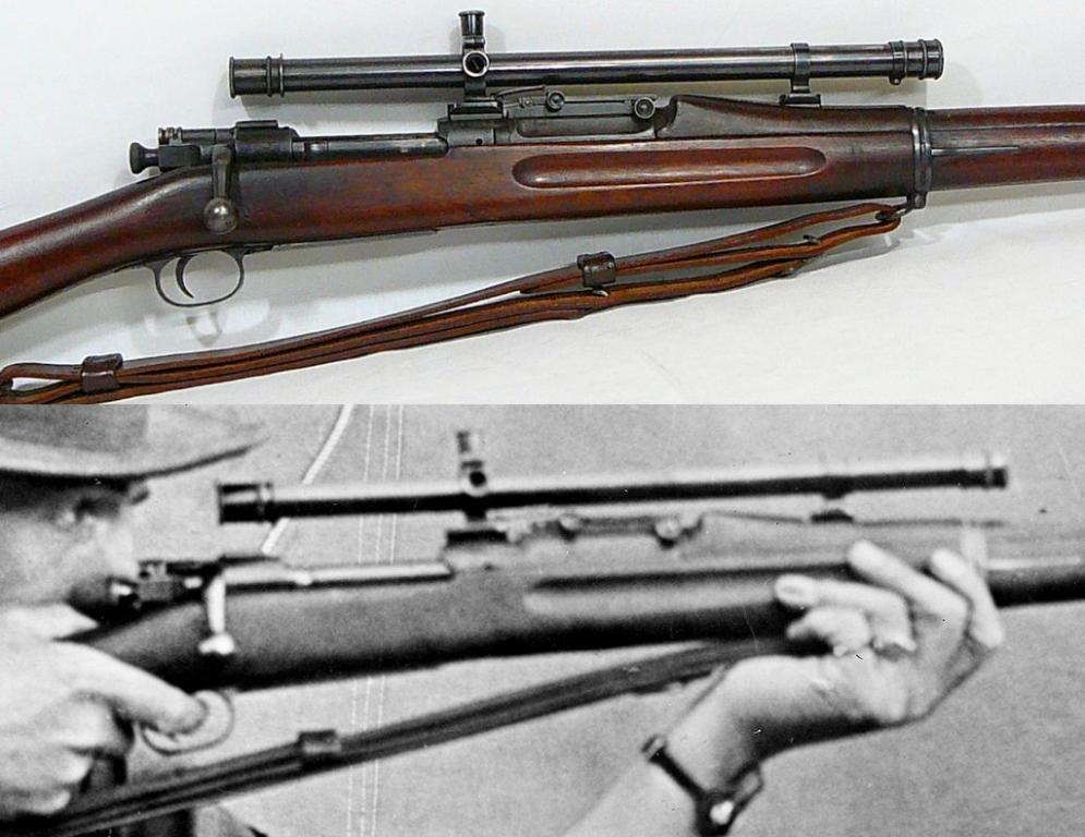

    A couple quick edits. The Marines did Contract Niedner to mount 1650 scopes in the spring of 1917. But he only completed 150 then he was fired. The Marines then contracted Winchester to mount 500 on Marine rifles. Which WRA did with their blocks they nicknamed the Springfield Marine. But these are the predecessor to the Unertl blocks. They don't have any similar characteristics to the Mann Niedner in anyway. WRA mounted the 500, and while doing so, trained the Marines on how to mount scopes themselves at the WRA factory. So with this new trained ability, the Marines returned to Philly Depot and started to mount their own A5 scopes they had bought loose off WRA. The Marines then adopted the Mann Niedner design (probably on tooling that Niedner himself had left there in 1917). The Marines started to mount their own scopes at basically the end of the war. Which the Marines did do the Mann Niedner conversion in house.
    The biggest confusion that has plagued every book is there were two distinct A5 sniper rifles in WWI. One rifle done by WRA. Then the tapered block design done by Niedner, and then later by the Marines in house. Even though the Mann Niedner has always garnered the credit, there were substantially more of the ones mounted by WRA, which were used by both the Army and the Marines in Franceicon. The Army even adopted the WRA mounted a5 rifle as their standard sniper rifle before WWI ended. The Mann Niender wasn't really made in number till basically the war was over. The first 150 Mann Niedners that were built are probably the only ones that could have possibly went to France and saw combat. The rest would have arrived likely too late. But the 500 that were mounted by WRA for the Marines were shipped to France and those would have been there the whole war. The Army also received the WRA mounted A5 snipers in France by the spring of 1918.
    It took me years to piece this together from the Winchester/ Marine/ and Army Ordnance docs. But I'm certain on the story as I easily have over 10,000 pages from all the archives that deals on nothing but the WWI sniper rifles and tell the story I'm stating above.
    This is the WRA mounted A5 sniper in France in very late Dec 1917/ Jan 1918. These rifles arrive in France by the fall of 1917.
    There are only 4 known to exist as of this time. One is pictured in the pic for comparison. For some reason none of the books have ever identified this version of the A5 rifle. They have shown the pic below but never realized it was the most common A5 sniper used in the war.
    Also I hate to say it, but I've never seen a real A5 sniper pictured in any of the books. Everyone I have seen has been a clone.
    There really isn't any evidence the Marines ever used the 6 inch spacing on the A5 scopes. The Army did test about a dozen of them with 6'' spacing in 1914, but said the spacing was not stable enough for a sniper rifle.
    The Marines only bought a handful of A5 scopes for testing prior to 1917. They bough like 5 if I remember right in 1910, but I didn't go back and look at the purchase order. But they didn't adopt them or buy more till 1917.
    On the 1903A1 Unertl rifles, the Marines started to mount the scopes in Jan 1943, only mounting for sure 250 of them. At that time, the Marines had converted all their A5 scopes to the Mann Niedner tapered blocks, so the Unertl and the A5 were not interchangeable during WWII. Even though the WRA Springfield Marine blocks in WWI were the predecessor to the same shape as the Unertl blocks. The Marines had converted all their A5 scopes to the tapered blocks by WWII.
    The Marines did build New Mann Niedner sniper rifles during WWII as training rifles, rifles for the Marine raiders, and even some for the Navy as mine sweepers. They did this in 1941/42. This is another thing the books don't know about. There are WWI and WWII Marine Mann Niedner rifles.
    Real A5 snipers are extremly rare as most were broken down for parts when they became unservicable. There are only a handful that are real that are known.
