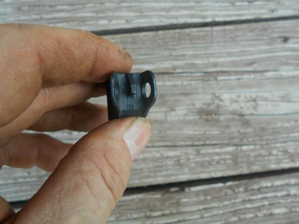

    N marked front sight question
    Can anyone verify for me that there was an N marked front sight that had two grooves on each side of the center? The picture I saw looked like it was ball mill cut and only ran part way, not the entire length.

    Yes.
    See many milling variations on top ledge, most likely from the operator.
    HTH

    I didn't know if a certain style was used then changed over time or it varied with the operator.

    I posted a picture in the gallery.
    Yes.
    HTH
    The N is very faint in the picture. The grooves are unique compared to other sights of this type I have seen.

    Quote Originally Posted by James Weaver View Post
    IP, S'G' and SG all used the Type I Milled front sight. Which was milled from one solid block.
    Some other makers later on used the Type II front sights, when they became available, these we call 'Fabricated' and supposedly quicker and cheaper to make by stamping and brazing together. These were made of multiple pieces.
    Your N sight is legit, just not often seen milled that way. There was a War on, Carbine production was deemed critical.......So no one was really worried about being pretty.
    I found a N marked front sight currently being offered on a Auction site. Appears to have the same 2 grooves, just located farther forward.... See pic.
    Auction Item number: eBay item number:304149621358
    PS: Just looked at your GALLERY PICTURE. It shows a number 7 on the outer left ear. Be nice to see a Size / Font Comparison on that #7.
    I see the background of your picture matches listings by the seller tagmil in Wyoming.
    The Same seller of the N sight Example I posted above.
    BTW, R marked front sights Are Not Rock Ola, I'm betting the seller already knows this
    Here is the same background in his listing for a EU Type II front sight:
    Ebay item: eBay item number:304172071174
    Charlie-Painter777
    https://www.milsurps.com/images/impo...0/sl1600-2.jpg
    Correct. I haven't received it in the mail yet. I used the stock photo.
    JW,
    The 2nd picture in your gallery (below) shows the number 7 on the left outer leaf. Meaning blade height when made.
    Numbered blade height front sights were used by IP.
    The numbers 0 to 8 came in at least 2 heights (tall), maybe 3... heights ??
    I don't remember if the number Font style was the same.
    I believe these 'Leftovers' were also used by S'G' after the take over.
    *Anyone out there with a N marked sight with a number?
    @ USGIBOB, Doesn't your S'G' 1,8 have a N marked sight with number like this ??
    And if IIRC isn't it a small 7 ??
    Charlie-Painter777
    Nope. Mine has the "Big" 7 - slightly larger than the sight pin hole. - Bob

    I just looked at the (2) pics in the OP's gallery. If they're both of the same sight, something's wrong because a 7 has a lot more ground off the blade than what's shown there. My understanding is that the sights were ground before being installed. I've got BQ's notes on that somewhere. - Bob
