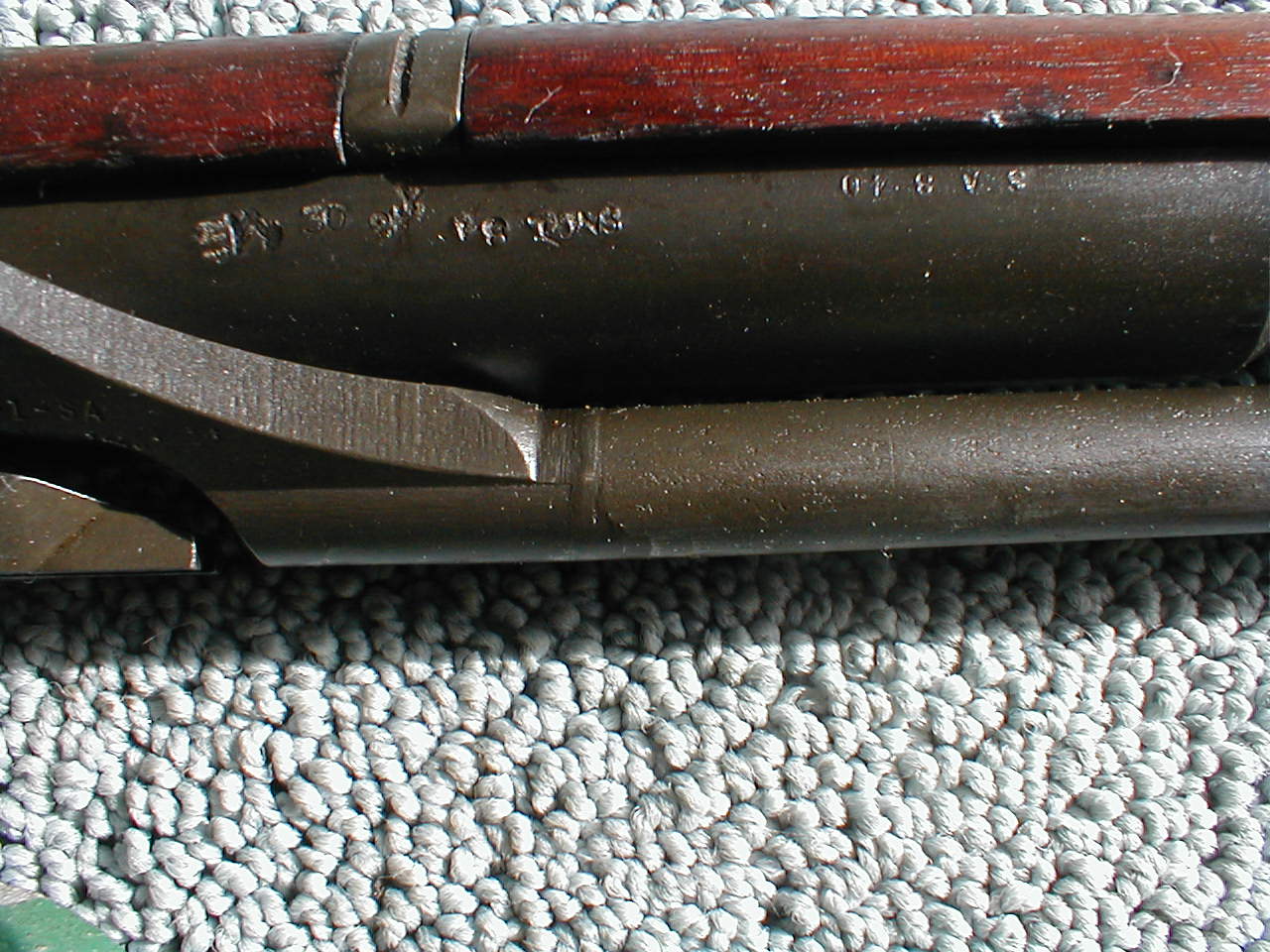

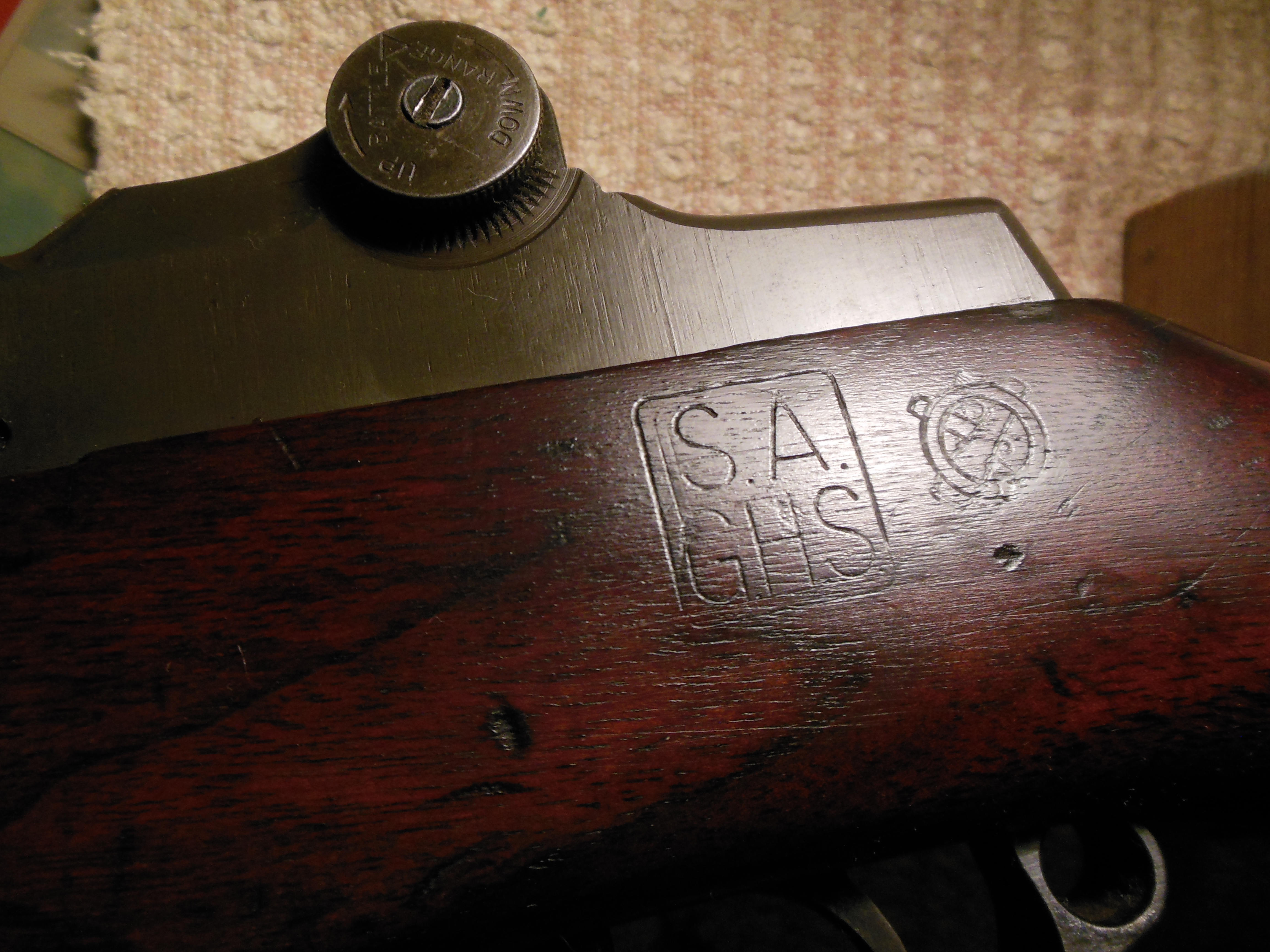

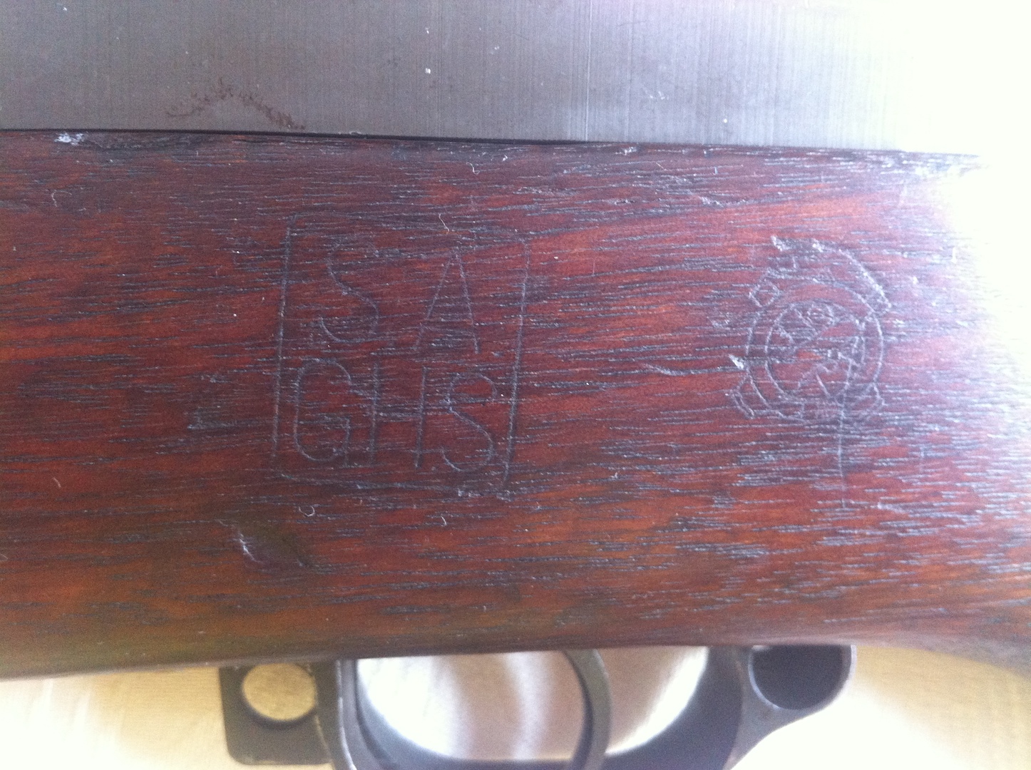

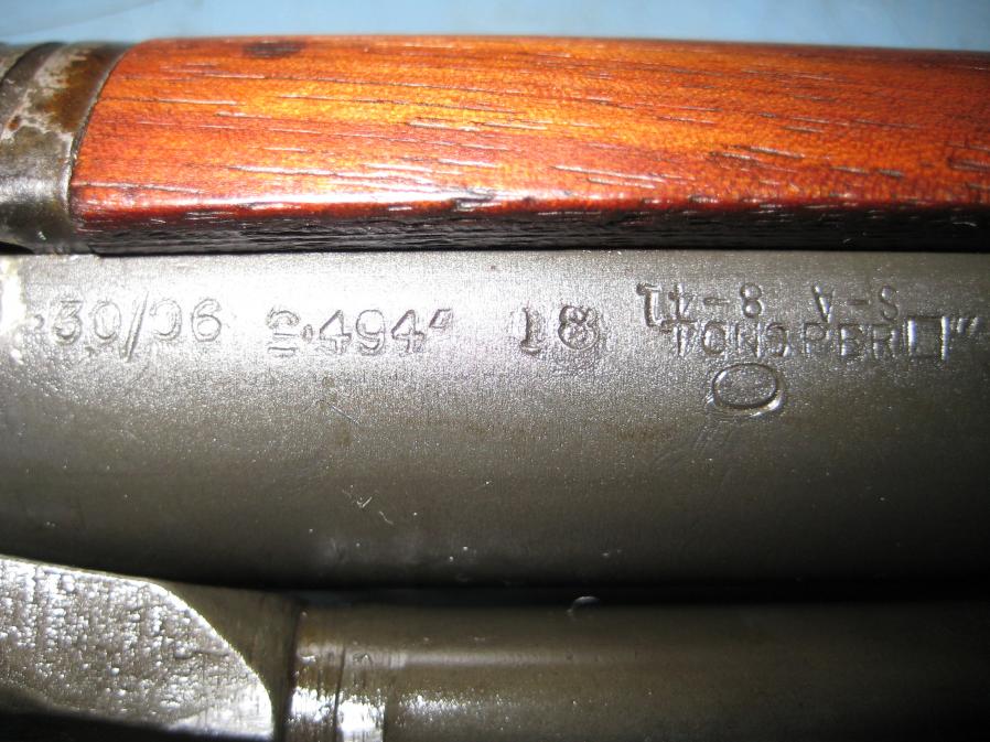

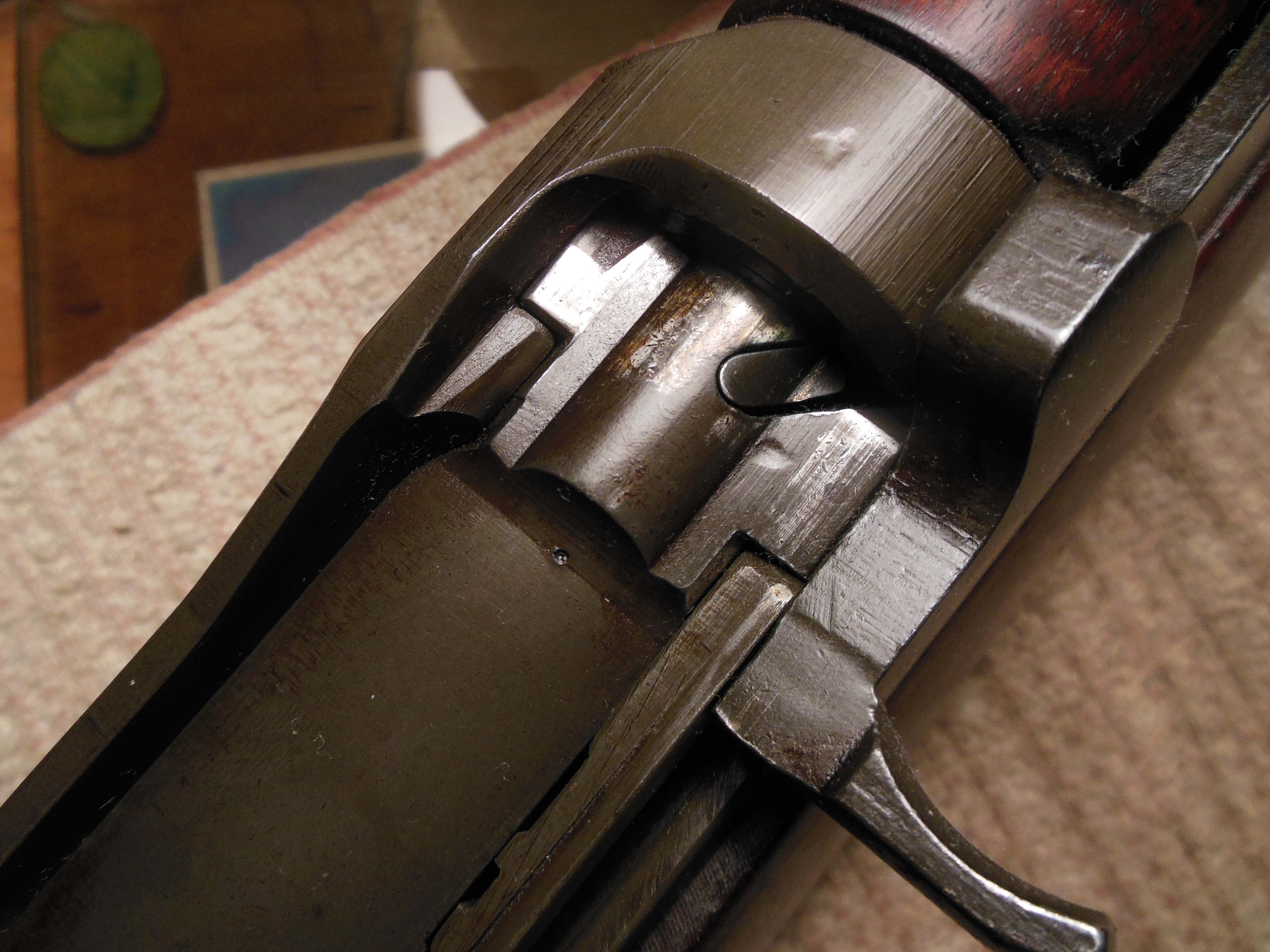

    The early LL rifles you refer to were brought back from UKicon and since they were essentially unused they needed nothing. The lower stock groups were in some cases switched between but they weren't as mixed up as you've been lead to believe. Mine was all original except the conjecture that the stock group had a small ordnance wheel instead of large. Later LL rifles had seen hard use and as stated were completely overhauled.
ID:	122963   Click image for larger version
ID:	122964   Click image for larger version

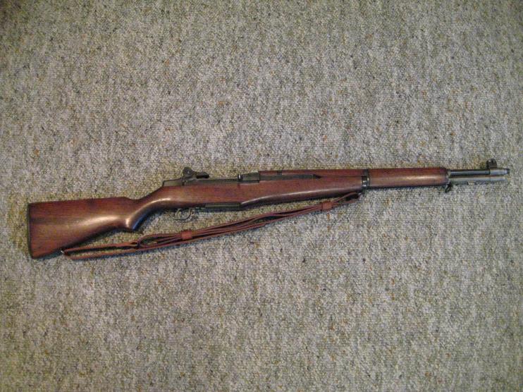

    Legacy Member RCS's Avatar
    Today @ 09:11 AM
    4,472
    Robert Seccombe
    07-04-2025
    08:53 AM

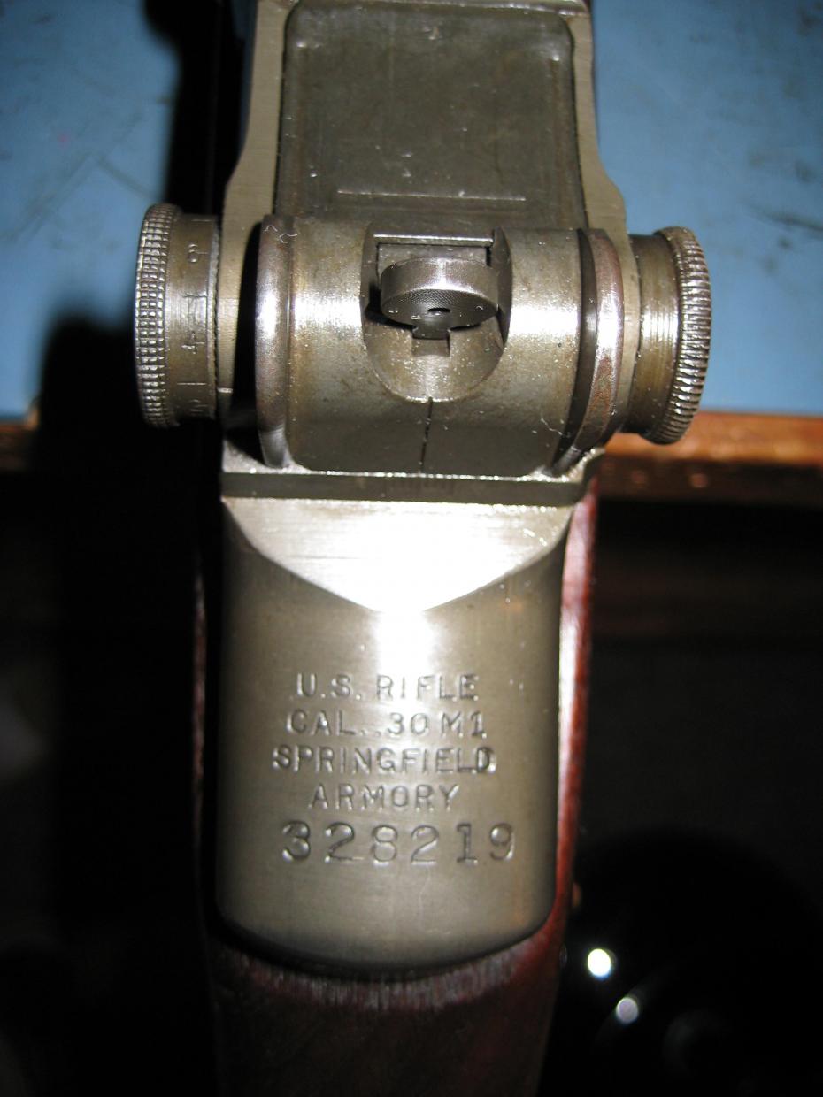

    Lend Lease M1 Rifles
    Most advanced collectors want rifles from the first batch of around 38,000 rifles, these have the BNP proofs at the rear of the barrel where the date is stamped. There is also a letter near this stamp which will indicate the year of import. example: 1950 has A with the letter I omitted, 1958 is J this ends in 1963 with O. Besides the rear proofs on the barrel, there is also a stamp on the receiver ring and on the right bolt lug which is distorted from usage. The red paint is on the front hand guard. Collectors often use a common lead paint test kit to find out if the red paint has been faked to increase value.
    I have enclosed photos of my lend lease rifle

    In my considered opinion, only the first lot imported by Interarmco can be guaranteed as rifles supplied to Englandicon under the Lend Lease Act of March 1941 and suspended about April 1942. They are proofed under the op rod.
    Right, there IS a serial range involved. There were so many countries supplied through the decades, but those that went to UK during the beginning are the ones meant when we speak of LL...not Greek, Danishicon, Honduras, and so on...

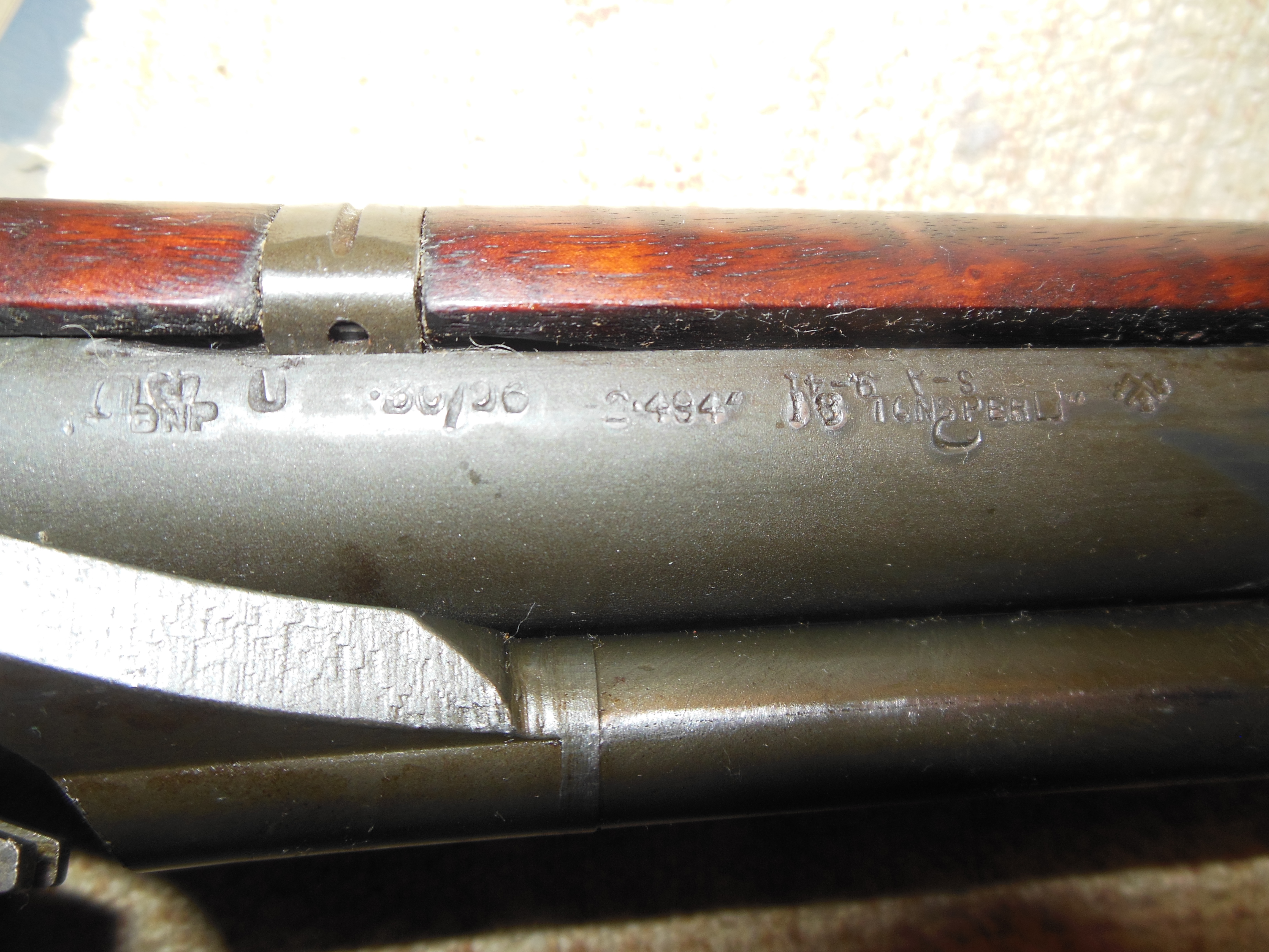

    Legacy Member jesse_'s Avatar
    Sep 2011
    09-23-2024 @ 06:20 PM
    Planet Earth
    81
    07-04-2025
    06:53 AM

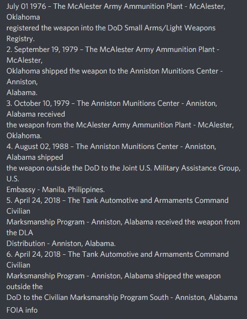

    M1s were even sent out in the 80s...
    Here is a reply to a mans FOIA request on his CMPicon.
    Today @ 09:11 AM
    4,472
    Robert Seccombe
    07-04-2025
    08:53 AM

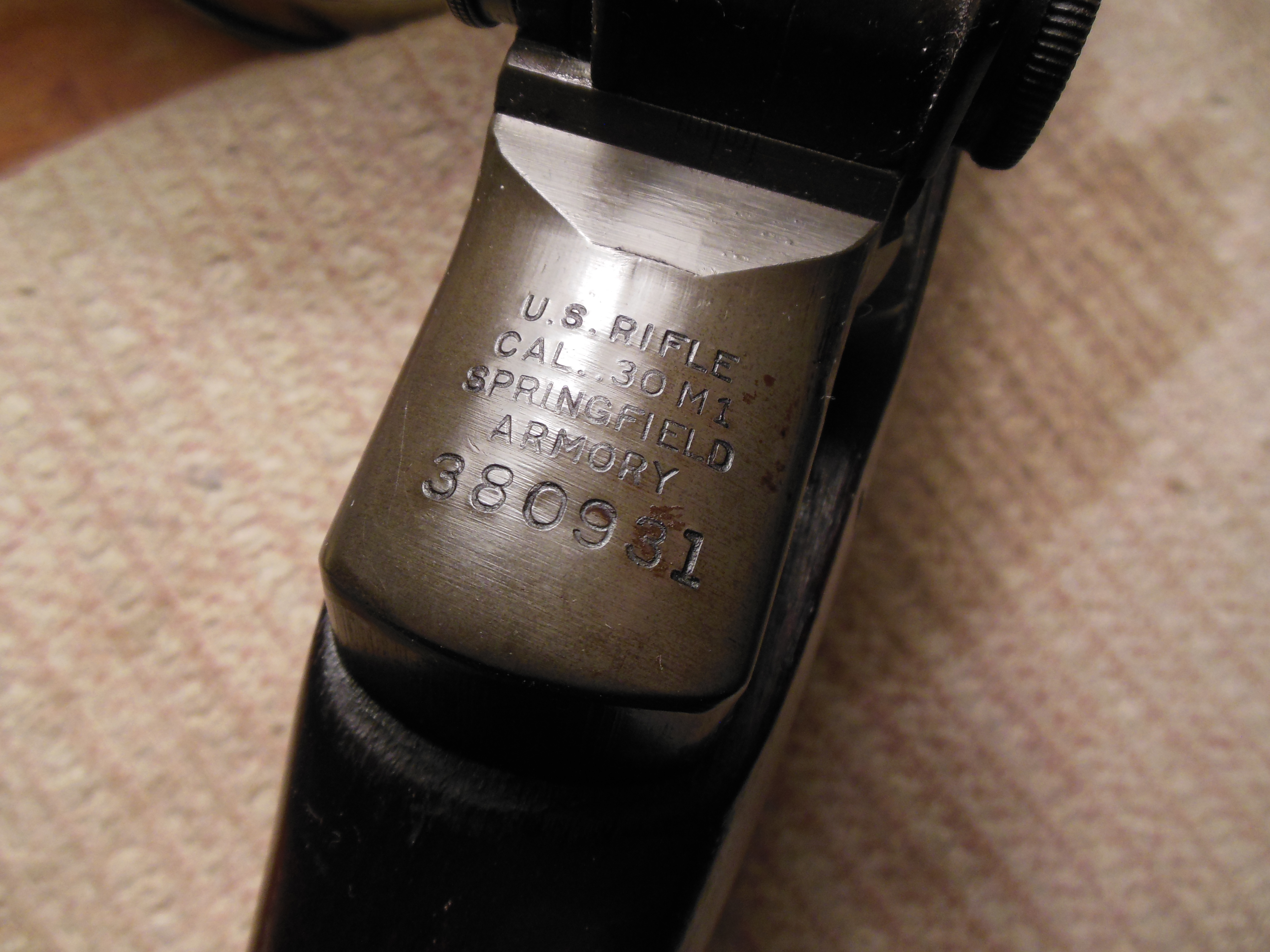

    London Proof on M1 Rifles
    You can also find the London Proof on M1icon rifles before, within and after the original group of 38,000 Lend Lease rifle serial number range.
    Like the BNP these London Proofs can be located in the rear of the barrel near the date or between the gas cylinder rings on the barrel
    My photo shows an excellent condition S-A 8-40 barrel with London proofs on a mid 1940 Springfield rifle. Also received a data sheet from a friend at GCAicon showing a direct conversion serial number 7860 with a S-A 8-40 dated barrel also with London proofs. Both these rifles are not Lend Lease rifles
