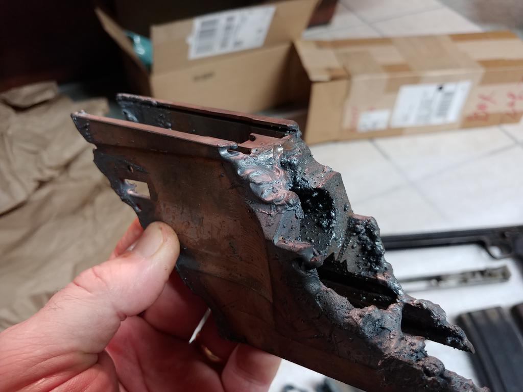

    Here are some pics of the area. Please excuse the not-so-great welding and quick machining. Its a work in progress and it is far from done. I work on it when I get time.

    My L4 as cut , you can see an edge of the "socket"

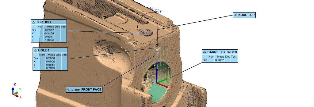

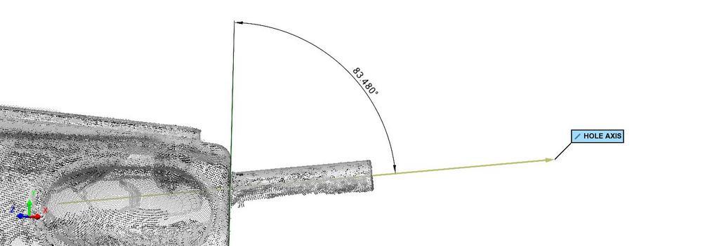

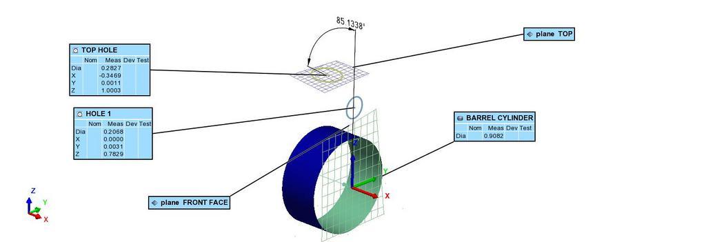

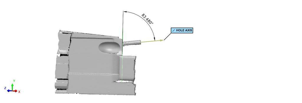

    ---------- Post added at 05:01 PM ---------- Previous post was at 04:56 PM ----------
    Some dimensions that might come in handy.
    I laser scanned a MKIIK for the hole locations.

    Wow, thank you for those! Those will absolutely come in handy!
    The torch cuts on your receiver are pretty nasty. They got that torch nice and HOT when they sliced through that. The cutter must have been having a bad day at work.
    When you say "socket" is that an official term? Or is this a term you came up with?
    Do you have any idea why that would be inserted in there? Headspacing maybe? Or maybe it was heat treated harder due to the nature if it's location?
    Also, I couldn't find a part name for this or that it even existed on any bren blueprints or parts diagrams. Is this strictly a L4 modification?
    I'm wondering if I will have to have that area re-bored and have to turn out a new piece if I can't find one for sale online. That'd be a major operation to have that area re-bored due to the length of the receiver, the fixtures required, and the instability of what a lathe chuck would have to grab on to. I don't have to tooling to do that on a mill. I don't think I'd want to do it on a mill either.

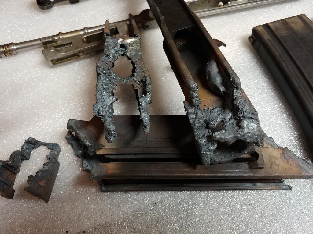

    Here are some pics of my kit before I started filing and grinding and making it look nice prior to lining up and welding. The cuts on mine aren't bad at all compared to some I've seen.
    And yes, I realize that those are MKII barrels and .303 mags in a L4. It's what I had on hand. When I ordered the kit, I thought I was getting a MK3 so I ordered 2 barrels and a mag to go with the kit that I thought I was getting.

    That area in front of the mag will need an awful lot of work. There’s a lot of close tolerance parts to fit in there.
