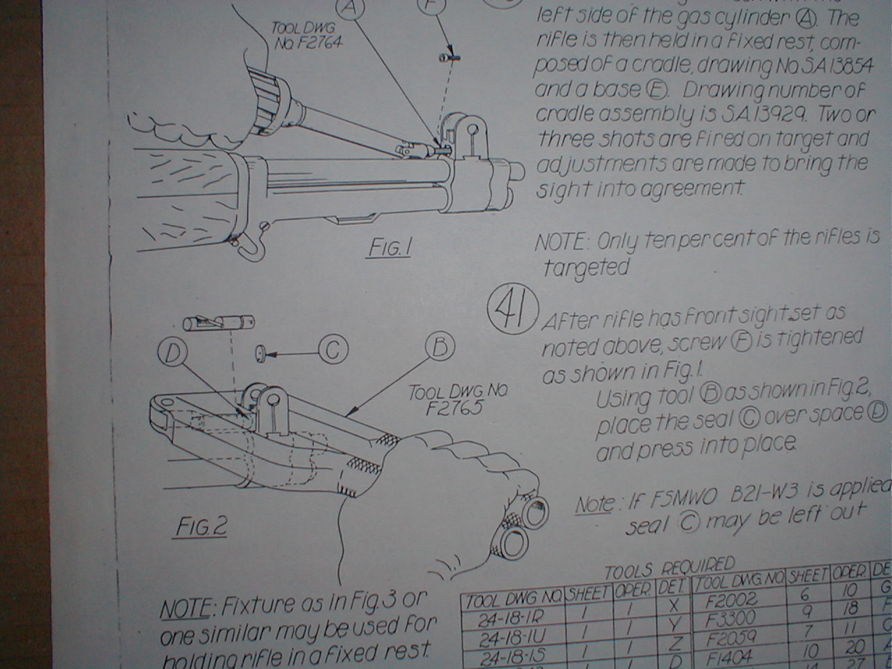

    front sight seal installation tool
    Here is a photo from the Rock island Arsenal Shop Manual 1943 showing the tool used to install the front sight seal. This tool if found today would be quite rare !
    Later the wide base gas cylinder and deleted front sight seal provided additional adjustment
