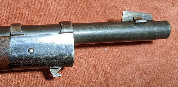

    26” Barrel, 45.5” Overall and right at 9 pounds empty. Very close in all respects to a No.1 MkIII
    Front band with bayonet lug. Barrels were slightly stepped for bayonet muzzle ring.

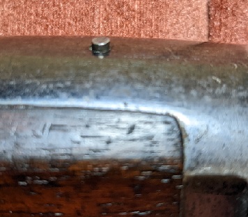

    A protruding pin on the upper rear of receiver serves as a visual and tactile loaded chamber indicator.

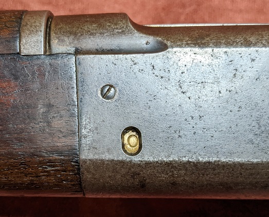

    A feature of all Model 1899s and 99s until 1985, numbers 0-5 indicate the number of rounds in the magazine through a window in the left side of the receiver.

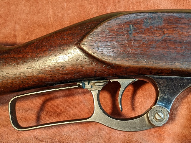

    The safety is a slide that locks both the trigger and the lever.

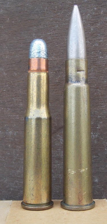

    303 Savage and 303 British.

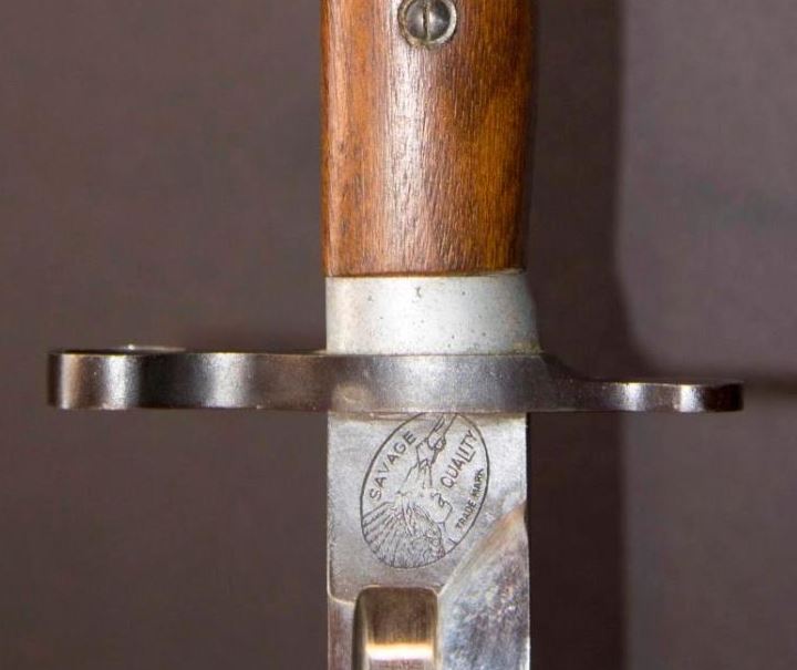

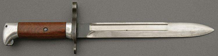

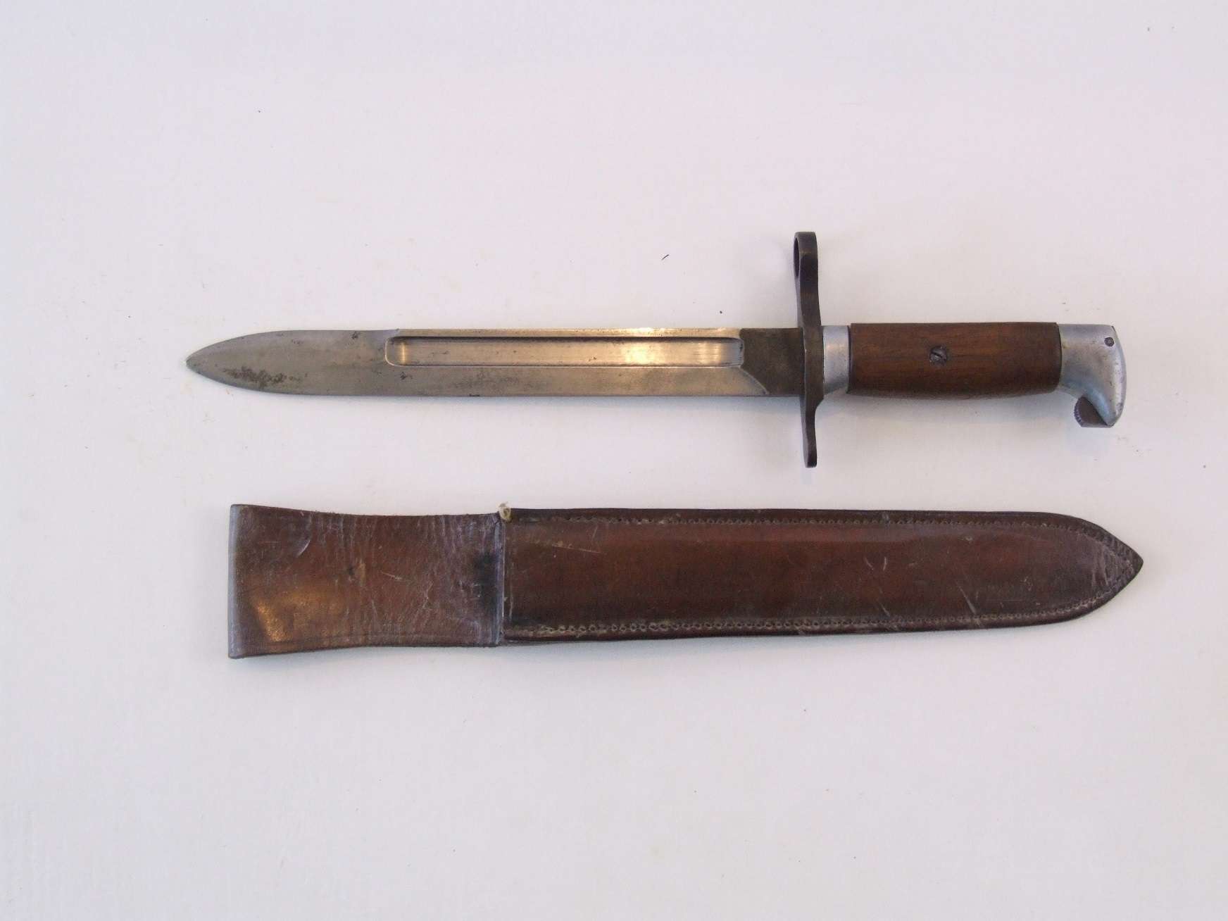

    On the subject of bayonets for these rare rifles, the only one I recall handling came to militaria shop close by and had been badly handled. The ring was cut off and the pommel was ground, the scabbard was present. It had been used for a hunting knife for years. It still sold high... Example...
