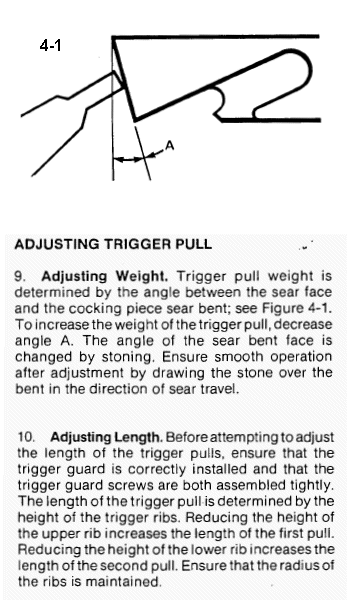

    Symptom is typical of trigger mechanism that has been altered by a previous civilian owner. If not too badly molested, 2-stage pull may be restored by reducing height of lower "hump" (AKA "rib") on trigger. Serious damage may require replacing trigger, sear, or/and cocking piece. For much more detail, see https://www.milsurps.com/content.php...-Peter-Laidler)
    Assemble rifle without forestock and operate trigger slowly to learn how mechanism works.

    Thank you for this information, very interesting. Realistically does this modification done by previous owner make the rifle un safe ?

    It would give it possibly a very light trigger.

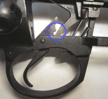

    Another malady that can possibly affect the trigger pull is if the trigger guard is not perfectly flat that is part 27 where the magazine goes through the whole top line has to be flat.
    I had a similar issue with one of my rifles No 1 MkIII and took it to Doug Barnes in Perth he corrected the malady of the single pull by straightening the trigger guard a few of the ppl on this site will remember Doug who was a top class armourer who did up weapons for the SASR & Police TRG units so sorta knew his stuff.
    Thank you for this tip, I will check this out. Regards. Rob

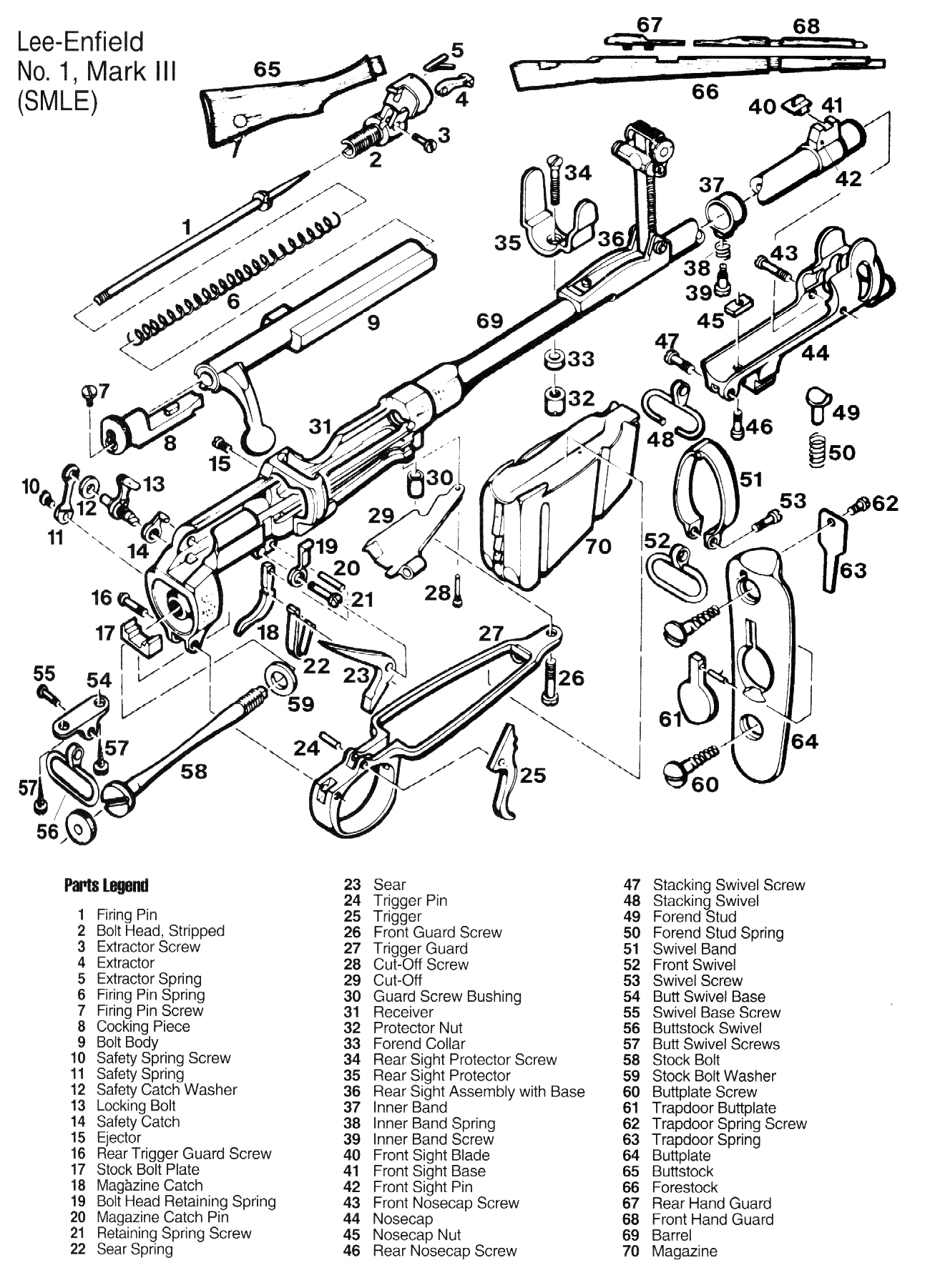

    Forgive my ignorance, but what part is the fore end ? Thank you

    The big wooden part fitted under the action and barrel. AKA forestock. Part #66 in the schematic found at post #5 on this thread.
