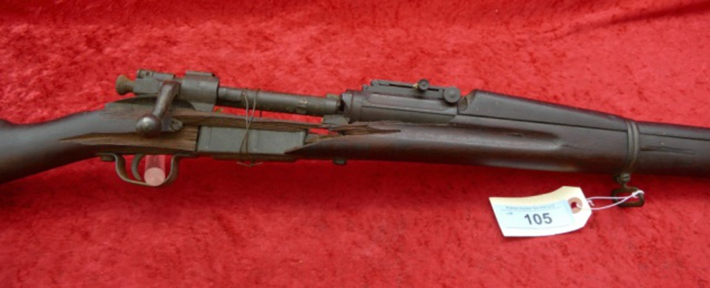

    While doing my weekly LOOK N SEE on PROXIBID I ran across this 1903 Rifle with an action that looks to have been blown apart. I would have loved to hear the story on this one.

    No indication of manufacturer...or even when it happened.

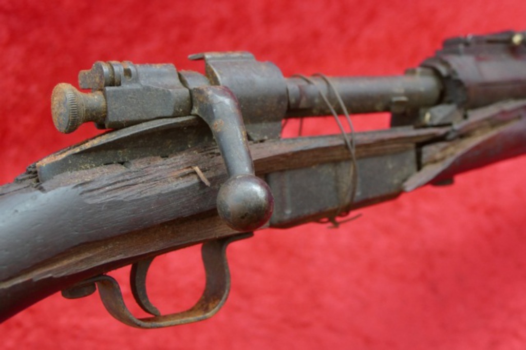

    I was looking at the knob on the striker to figure out possible time frame.
    Maybe later style?
    Not sure

    Has later swept back bolt handle

    Stamped trigger guard and late (WW2) bolt. Odd collection of parts. The story would be interesting, but it looks to be very old and probably no one is still around to tell the story. Entire receiver is totally gone, looks like someone hid something.

    Note the brazing metal on the off side of the receiver. To get that much metal someone heated that receiver ring to a red hot temperature. Nothing like an annealed receiver to give a big bang to your day. Nothing surprises me anymore. A couple of years a go I was at a turkey shoot with my rabbit eared LC Smith 2 3/4" 12 ga, Some moron grabbed it off the rack, stuffed a high brass 3" OO buckshot in it and shot at a squirrel. I turned around just in time to see my beautiful Smith doing a flip-flop in the air and that fool screaming and running. His left thumb was hanging by a thread of flesh. The left barrel blew half-way down the forearm. One gun ruined and one drunk firefighter looking for a new job that didn't require two functioning thumbs. That particular turkey shoot was sponsored by the fire station - no more. You can't fix stupid.

    Not saying it's associated with this test. But the Ordnance Department did a lot of testing for various reasons, especially with the 1903. Stamped triggerguard may help with approx. timeframe.
    Here's some photos from a 1920s test concerning reheat treatment and strength of the metallurgy. The failures are very similar to the rifle in question. If service connected, the rifle may have been involved in some sort of endurance testing (and failed).
