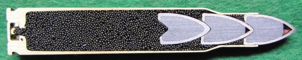

    They also experimented with Triplex, three projectiles. IIRC it was called the Salvo Program.

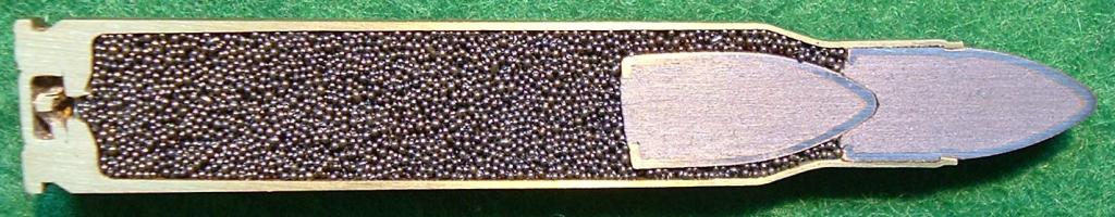

    .30-06 SALVO DUPLEX AND TRIPLEX
    Duplex and Triplex. Produced by Winchester during the SALVO program (1952-1961). The duplex load consists of two GMCS jacketed 96 gr projectiles while the triplex load consists of three 60 gr projectiles. Note that the base of the rear bullet is canted. This was done to induce random dispersion in each shot. The triplex load is identified by a short red tip. The duplex load is headstamped WCC 58 and the triplex is headstamped WCC 57.

    Must have taken some work to get the loads right. Looking at the powder right up to the neck in front of the bullets.
    I seriously doubt it ever would have. Without directional pressures, the last two would just be wild. I know when I loaded two round ball in 45/70 they would land one on POA and the other within two inches. These would have been wild flyers.
