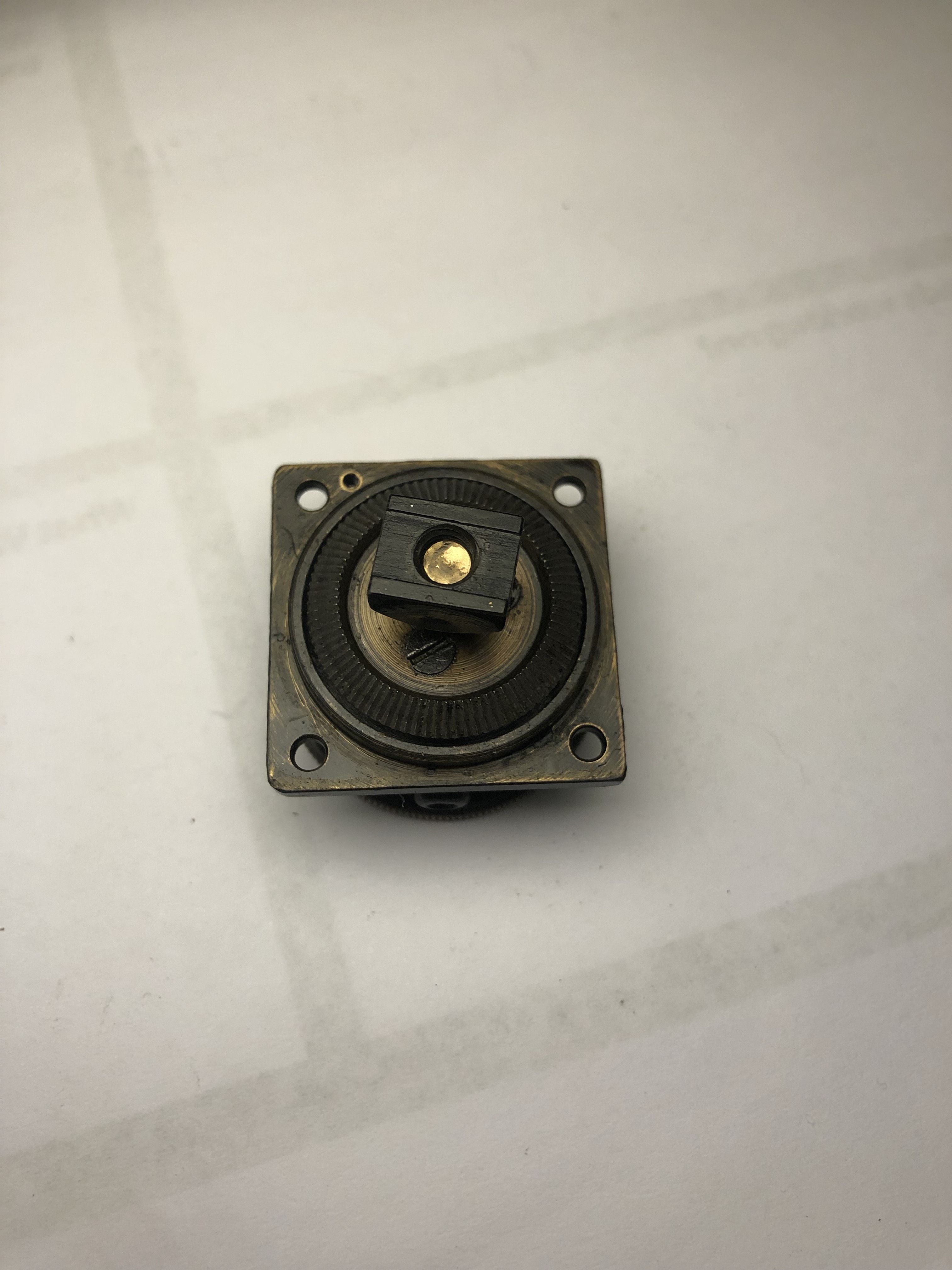

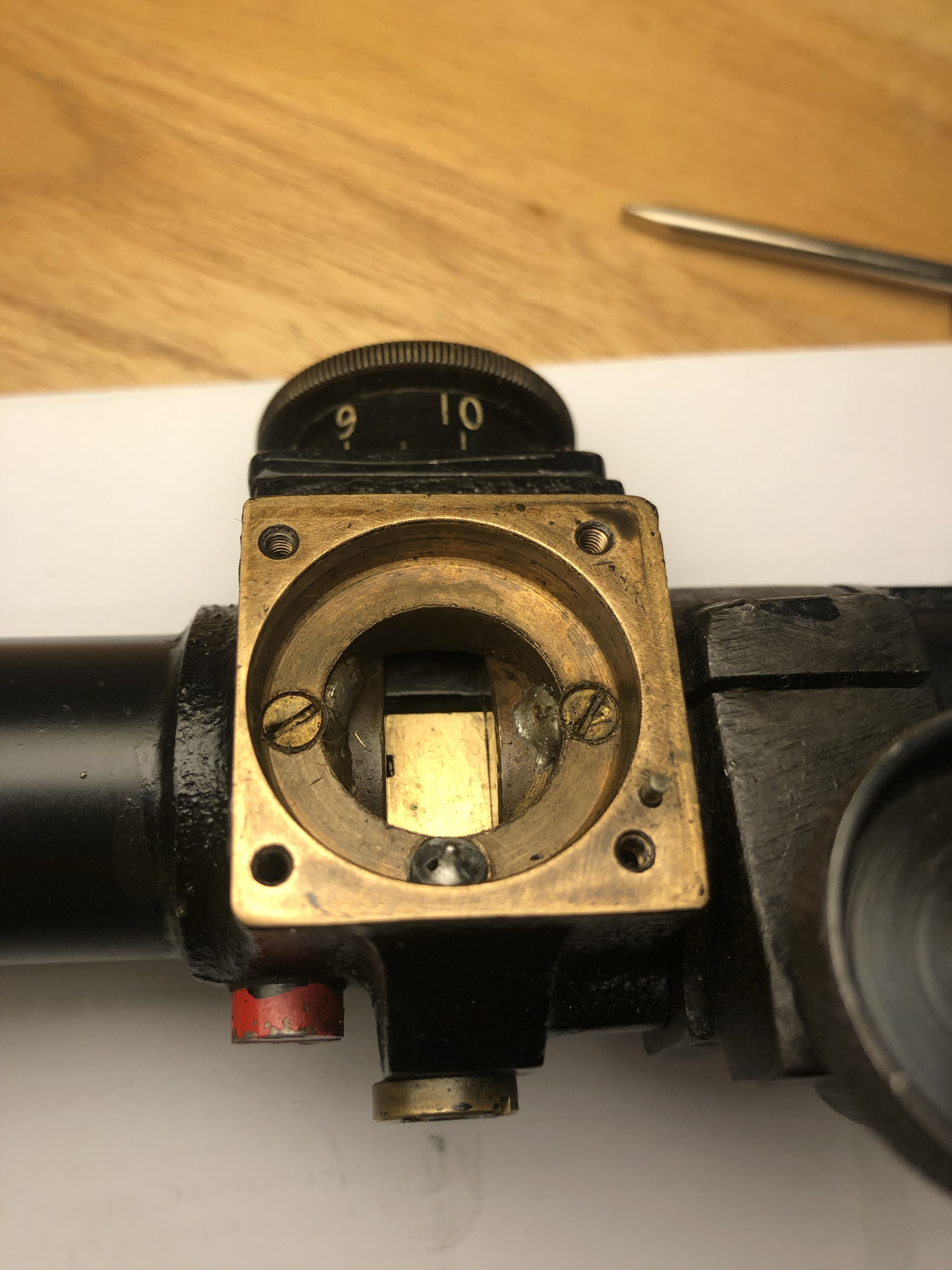

    Hi all,
    See attached pictures...

    Roger Payne's Avatar
    Mar 2008
    Yesterday @ 06:43 PM
    Sutton Coldfield, UK.
    3,546
    Roger Payne
    06-14-2025
    05:12 AM
    Ok, there is nothing missing as far as we can tell from the views we have. My best guess is that the second (T shaped) shoe that has the spring set in the bottom of it is seized, or the spring for it is broken/missing. It may simply be seized due to old solidified grease. The T shaped spring-loaded shoe is located underneath the grat block. If it is functioning correctly & you exert a little gentle downward pressure on the exposed flat surface of the grat block it should move downwards & then spring back up into battery as you release the pressure. If it doesn't move & then return to battery then it is likely the problem is either hard grease on the shoe or on the face of the grat block where it is sandwiched between the two brass spacers in the scope tube. If range adjustment works ok that would indicate more likely the former of the two options, as the grat is capable of movement. But either way, it really looks like the grat block is going to have to come out so that you can actually get to see the T shaped shoe. This is where I'm starting to dither. I know how I would go about that, but I'm far less experienced at all this than Peter & Warren, & removing the grat., depending on how it is done, can lead to serious damage to your scope if not approached correctly.
    P.S. Your deflection clicker plate & clicker plunger are present, so that's good news!
