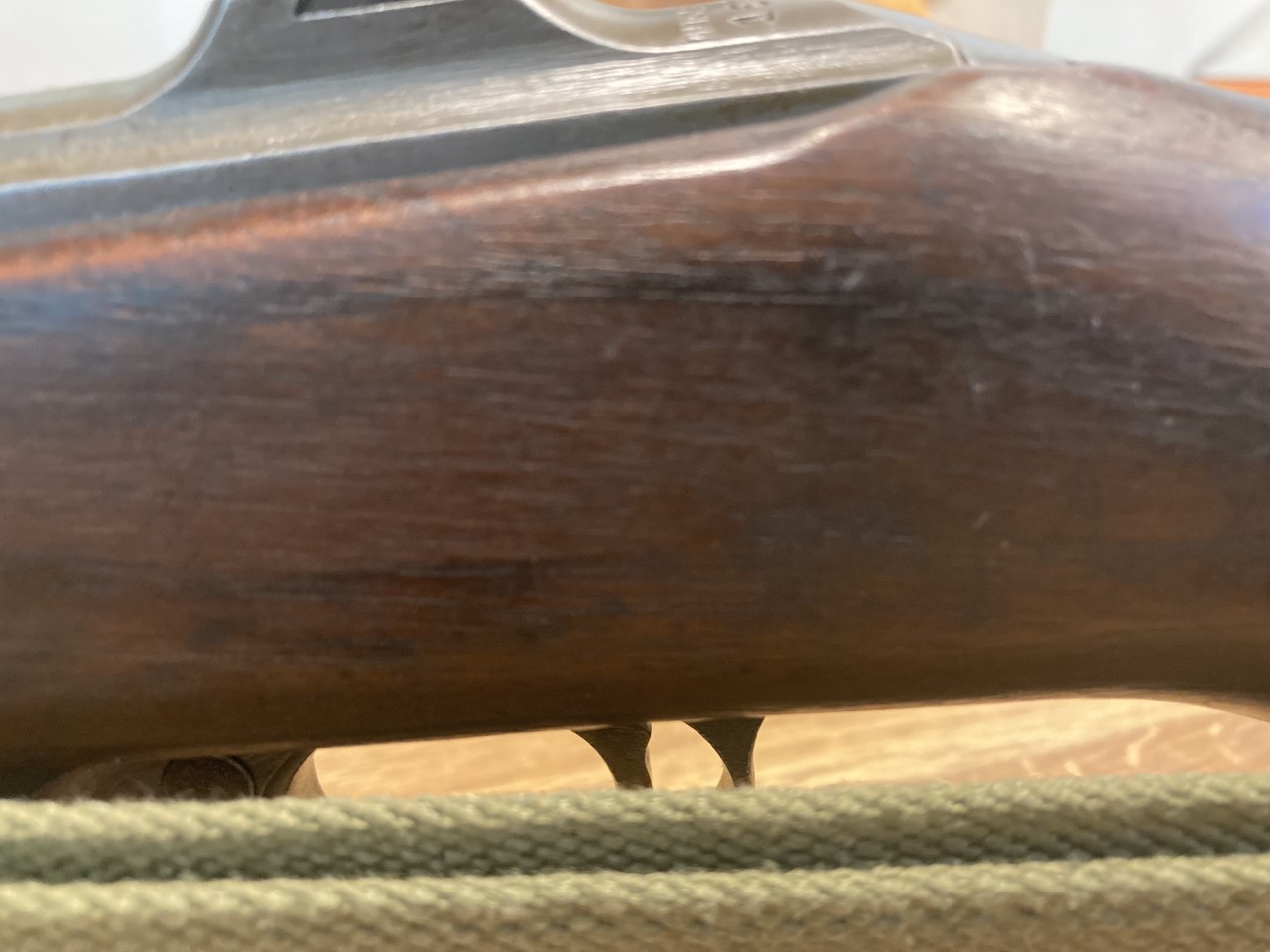

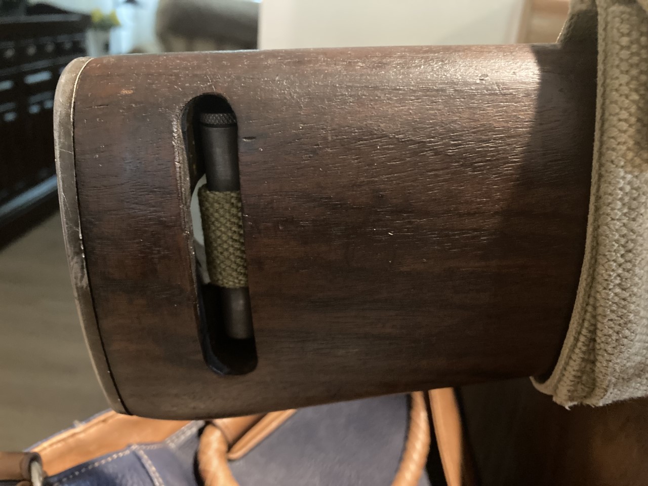

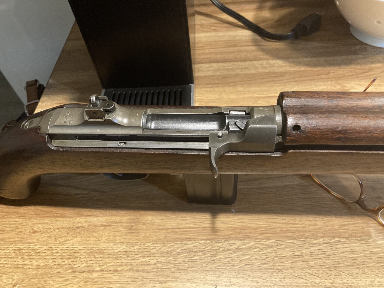

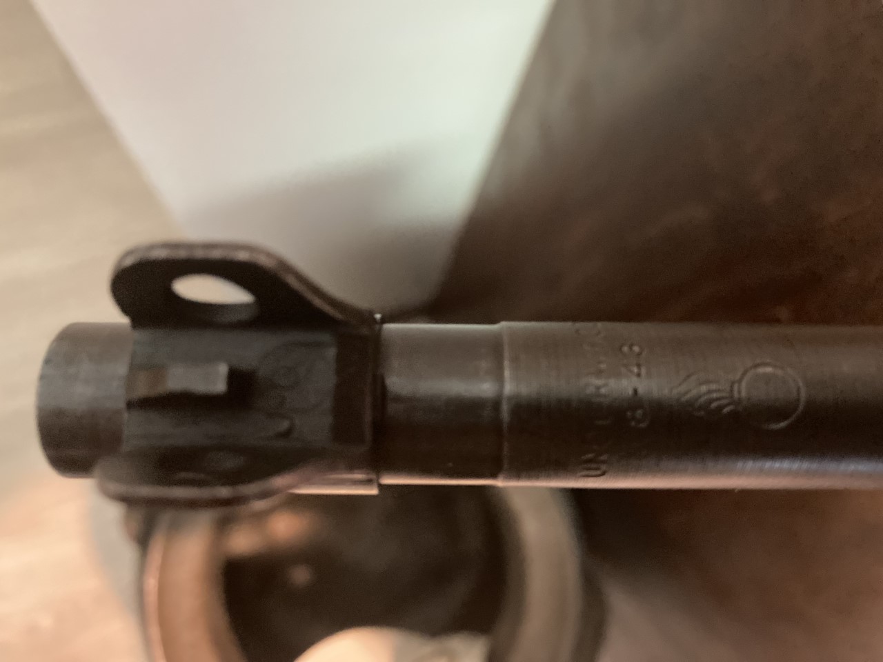

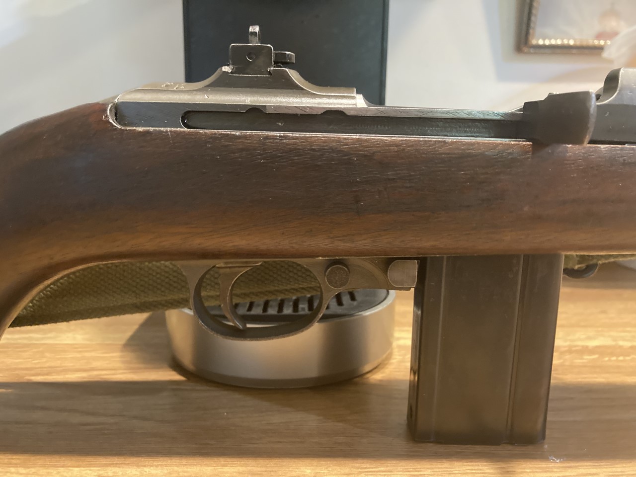

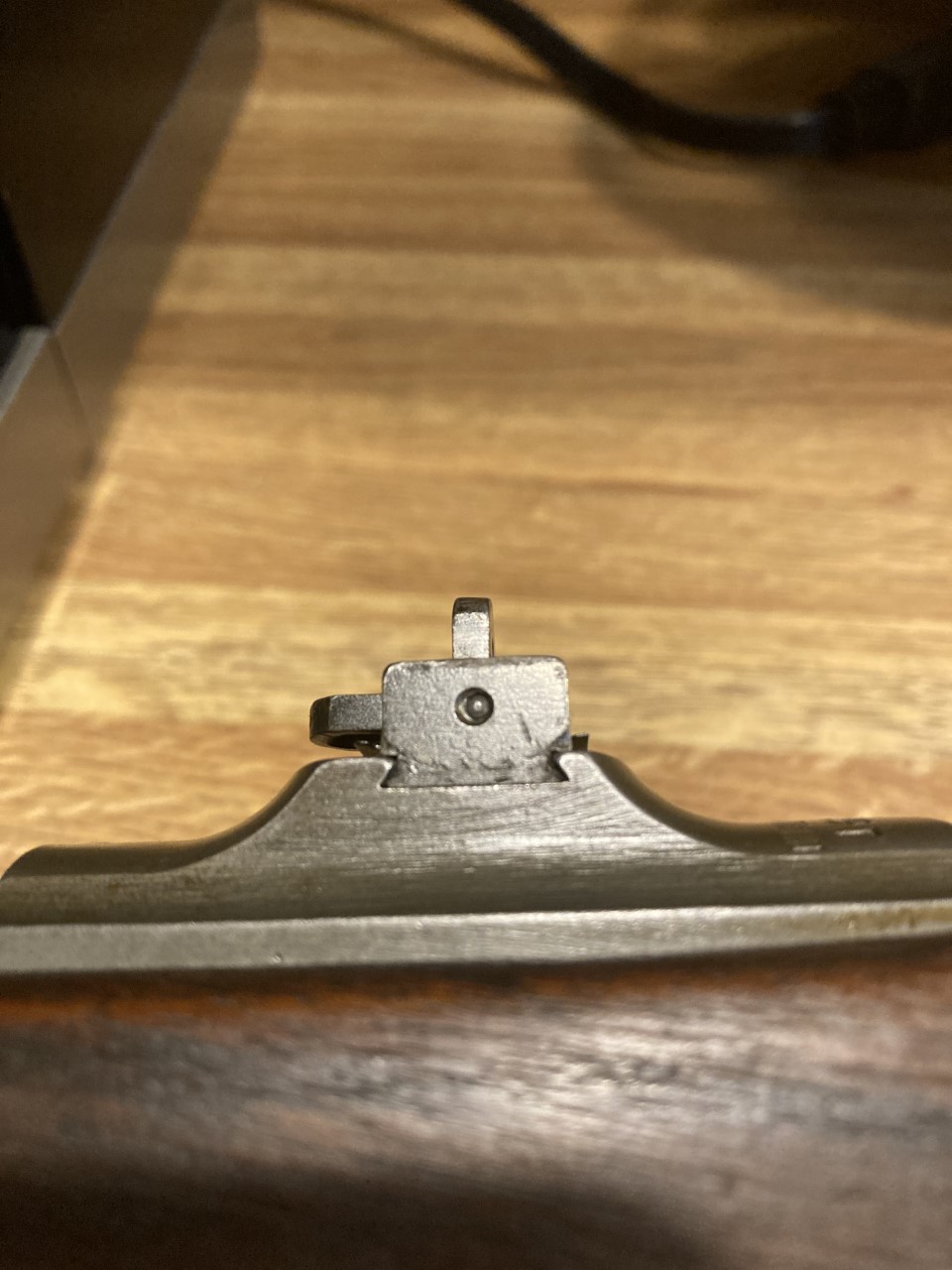

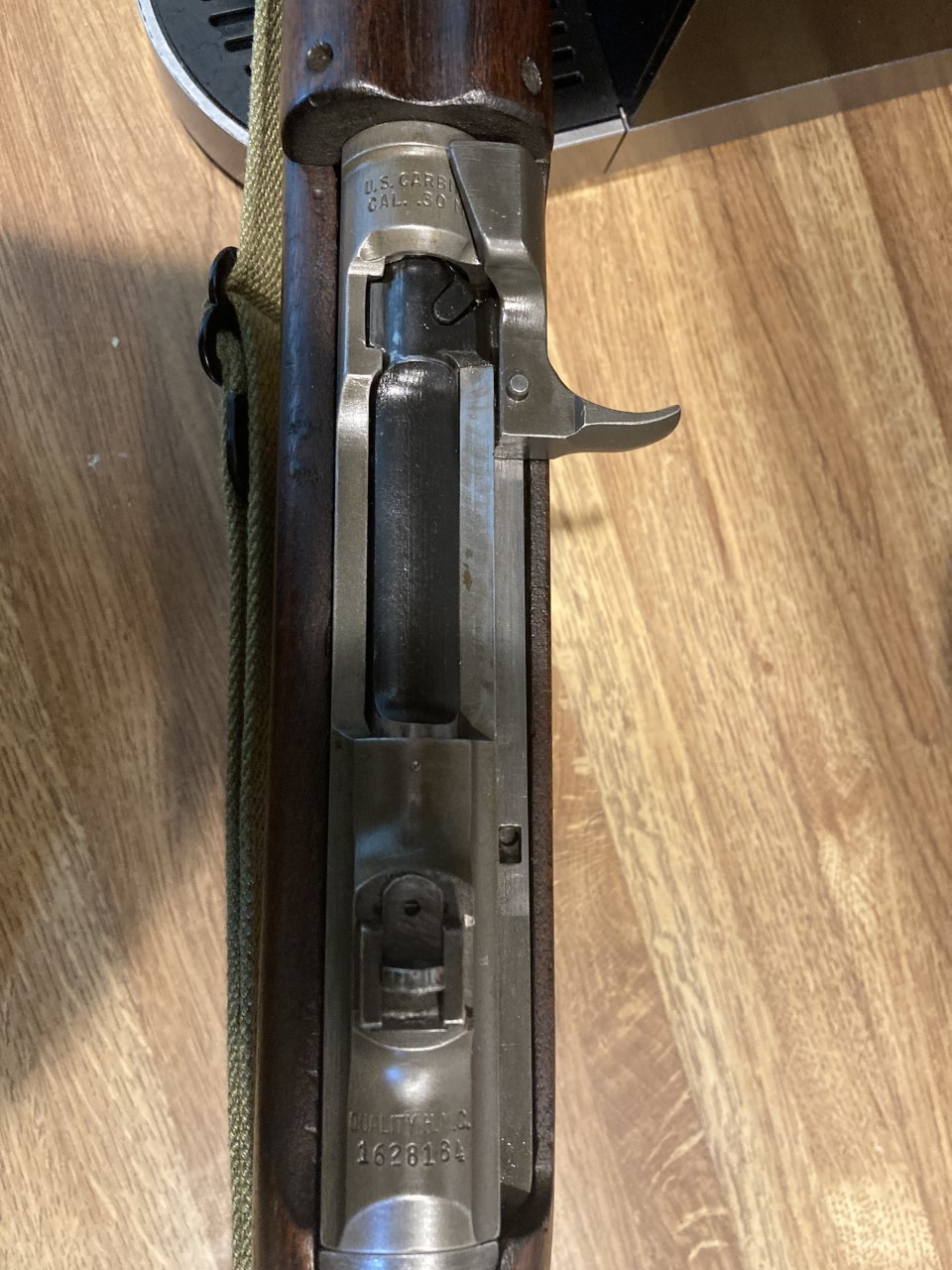

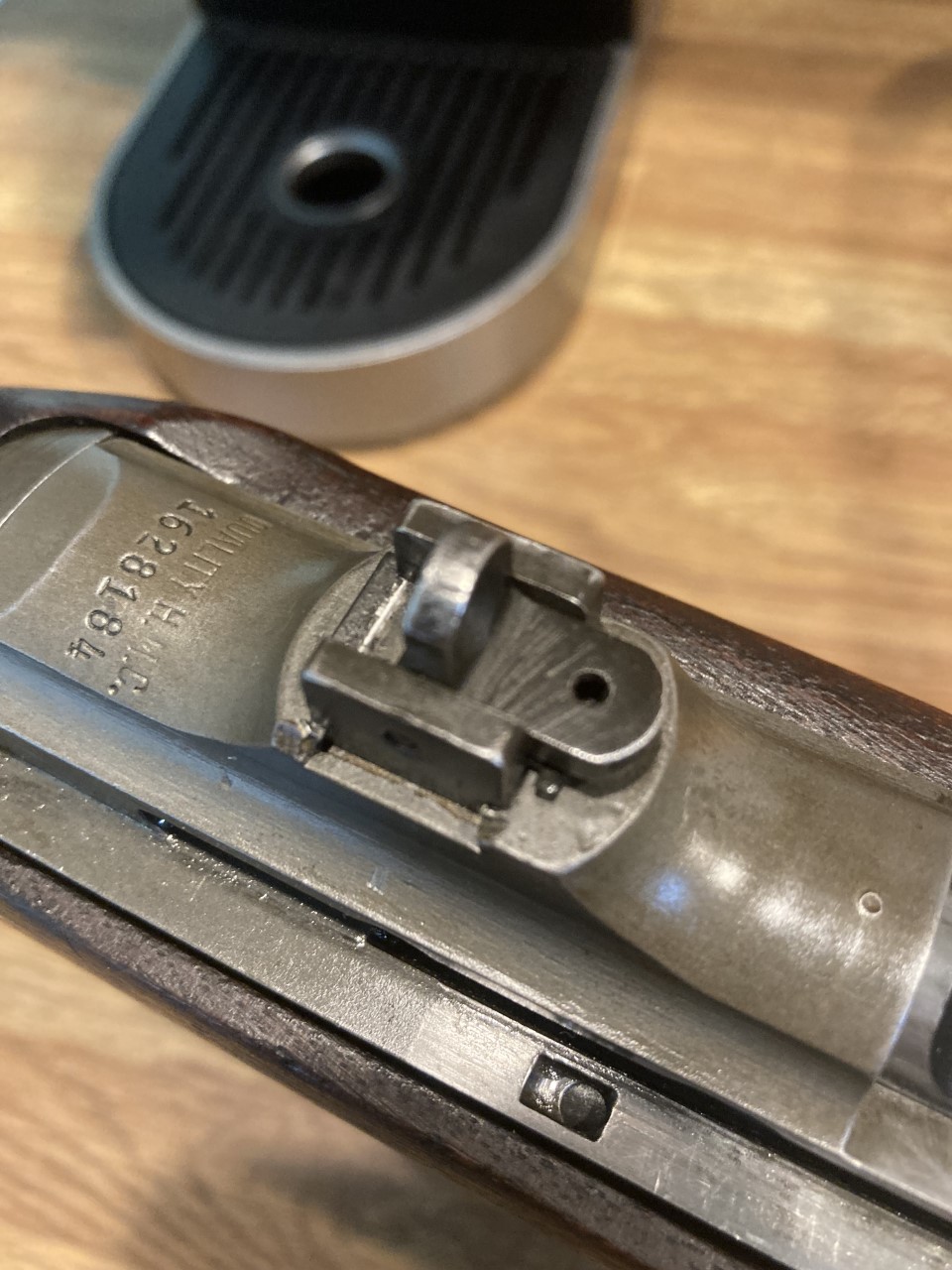

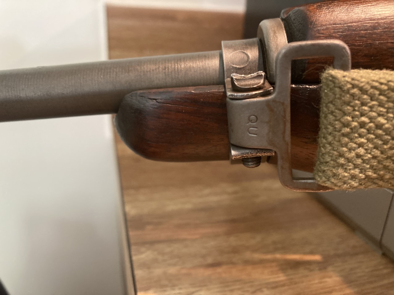

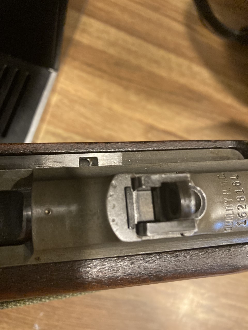

    Question could this carbine have come with the unmarked flip sight and the NPM bolt?
    Carbine has the look of have been together a long time, I know it has rebuilt stamps I believe the front sight and the rear sight have never been off ,maybe stock was replaced at some time, I am no carbine expert by no means, but it seems if it went thru a rebuilt it would have had rear sights ,safety ,cut down stock ,barrel band, etc, all parts upgraded?
    I am not changing a thing on it , just wanted to get some good or bad info on it, also no import markings, thanks in advance.

    Quality Hardware received bolts (500 of them) from National Postal Meter in September 1943. This fits prettty close to your serial number.

    Thanks I believe this carbine has original parts that came with carbine, anybody know if the sight could be original also. I don’t know how to post pics but I can send them in an email

    I can post pics for you if you send them to me...

    The pics...

    Nice looking rifle, I agree with your inclination to not change a thing.

    Really nice carbine. I've never held a Quality hardware in my hands. They were one of the most interesting brands of the lot. One part was all they made. I've always wondered how they could make thousands of spring tube guns and have them not crack and break? It was probably a simple machining change. If it were not for that goober punch mark in front of the sight, it could be original to the carbine? I would never change anything on this gun.

    Sorry but where do you see a goober punch mark?
