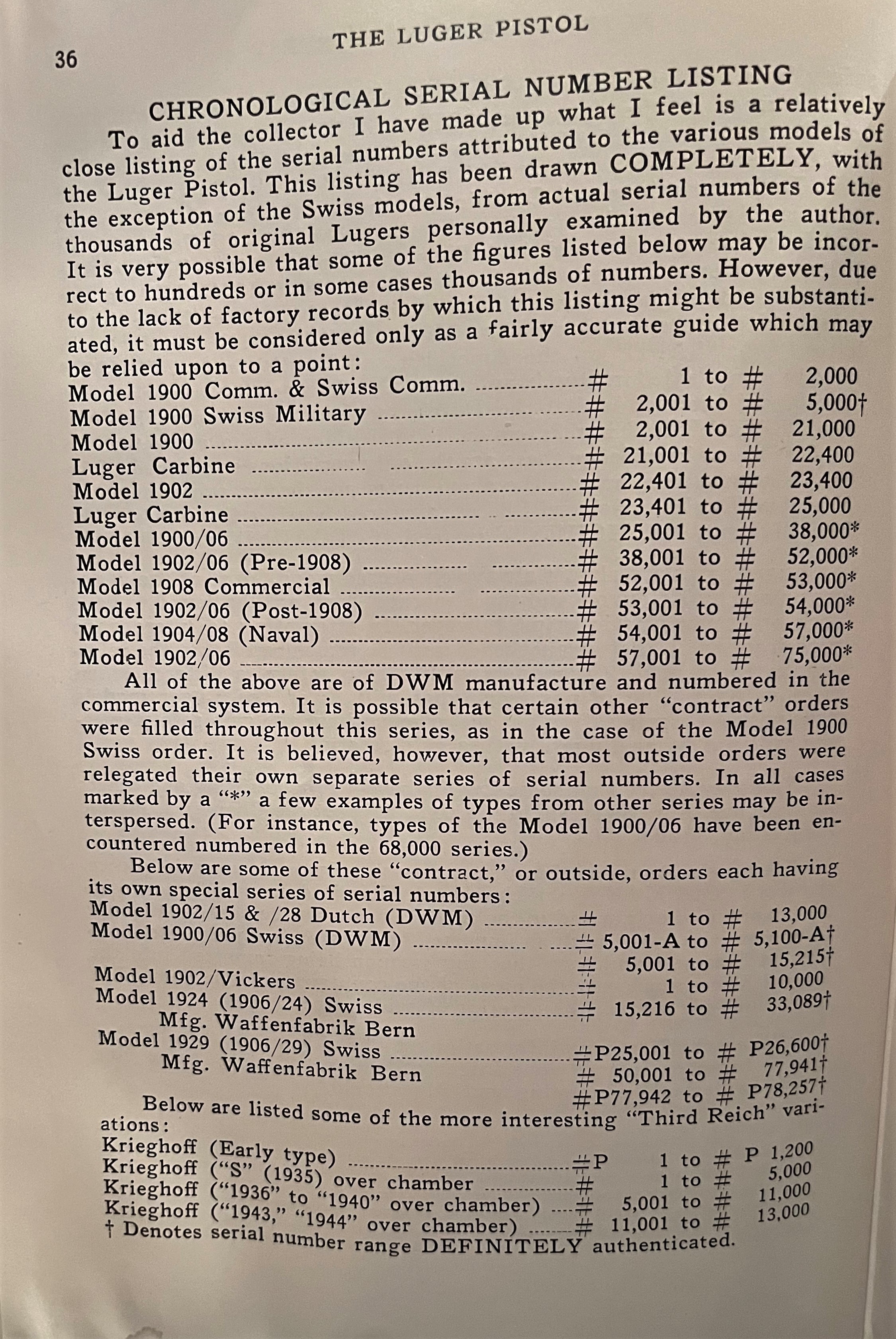

    Hope this helps in your enquiry.

    Well he must have looked at allot of Lugers then to come up with those figures...........as Datig states about the records not being complete in relation to serial numbers in his book, I thought this may have helped or interested you with your enquiry.
    I think Datig has about 20 odd pages throughout this book discussing the serial numbers, so I'll let you buy the book and read it for your own information.
