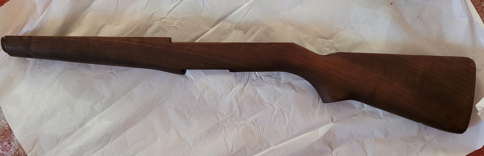

    Thanks.
    I'm going for as issued/rebuilt mid/late 1940. I don't have any stain as it always seems to muddy up the grain. I use dye exclusively. Mission Brown gives me a nice brown color that doesn't have any red tint (unlike what seems to be *every* walnut dye out there). I normally do 100% pure tung cut with citrus solvent.
    Just trying to figure out what color to make the thing for that era.
    Here is a Minelli that just came in from StockysStocks. This is unsealed. All it has is stain. These last few years Numrich sourced Minelli M1icon and M1917 stocks have had a thin clearcoat (nasty).
    How close does this come to what was original to the era indicated? I have a park tank that I fill with toluene to strip.

    Tung Oil Results
    By the way, here is an NOS Italianicon stock from 1971 that had its stain stripped, dyed with "mission brown", and then 12+ coats of tung oil
