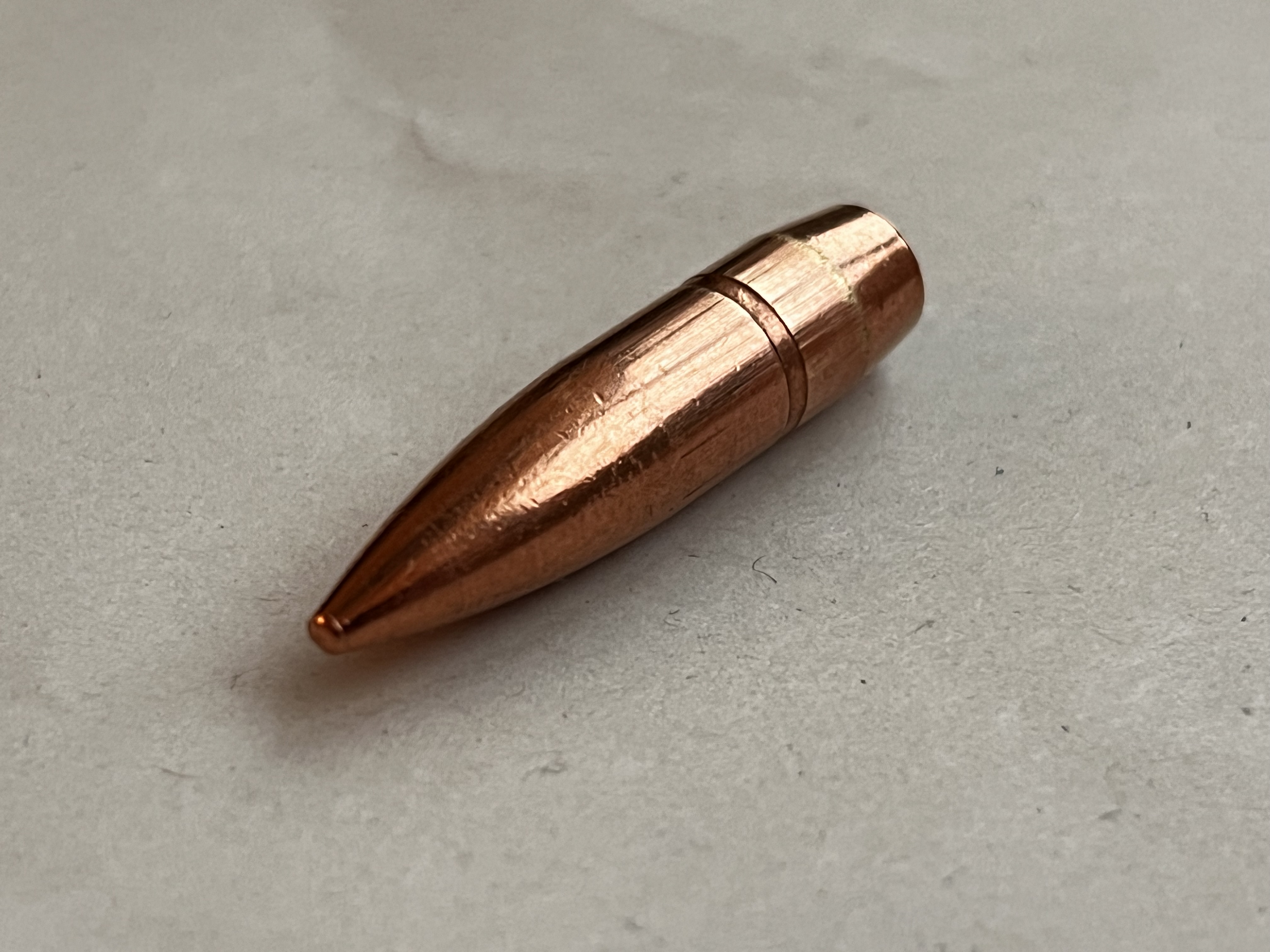

    I bought a 7.95mm reamer off eBay and set about making a die. This would in theory give me a bullet of 0.313" but it proved too hard a shove to pass through the die with my Redding BigBoss press. So I set about making a die to reduce the bullet to 0.319 (an 8.1mm reamer) and spent more time getting a nice finish on the inside with a soft wood dowel and metal polish. This gave me consistent and concentric bullets measuring 0.31935 to 0.31955 (measuring for ovality). Around about this time I realised LEE offered a 0.314" Swaging die (#90044) and I bought one of these. The net result is very good. Passing my 0.319" bullet through the LEE die give me very nice bullets measuring 0.31445 after 48hr spring back and less than 0.00040 run out of ovality which is on parr with a jacket made by Sierra.
    The spigot I made to shove the bullet through the die has a nipple on the top which ensures the bullet is pushed by lead core and not the jacket, the theory being core is seated into the jacket again and there won't be any jacket/core separation.

    The bullet has a length of 1.340" after sizing and the nose profile is marginally less pointy than a Sierra SMK or such. In the standard CIP/SAAMI chamber you end up with a round of 2.950" COAL and about a 0.020" jump to the rifling. The round still feeds. I have tried several types of brass but PPU seems best. HXP does not work as it is too thick at the neck to provide enough clearance and it can get stuck in the chamber neck area. PPU brass is gives about 0.003 clearance in this zone which is fine.

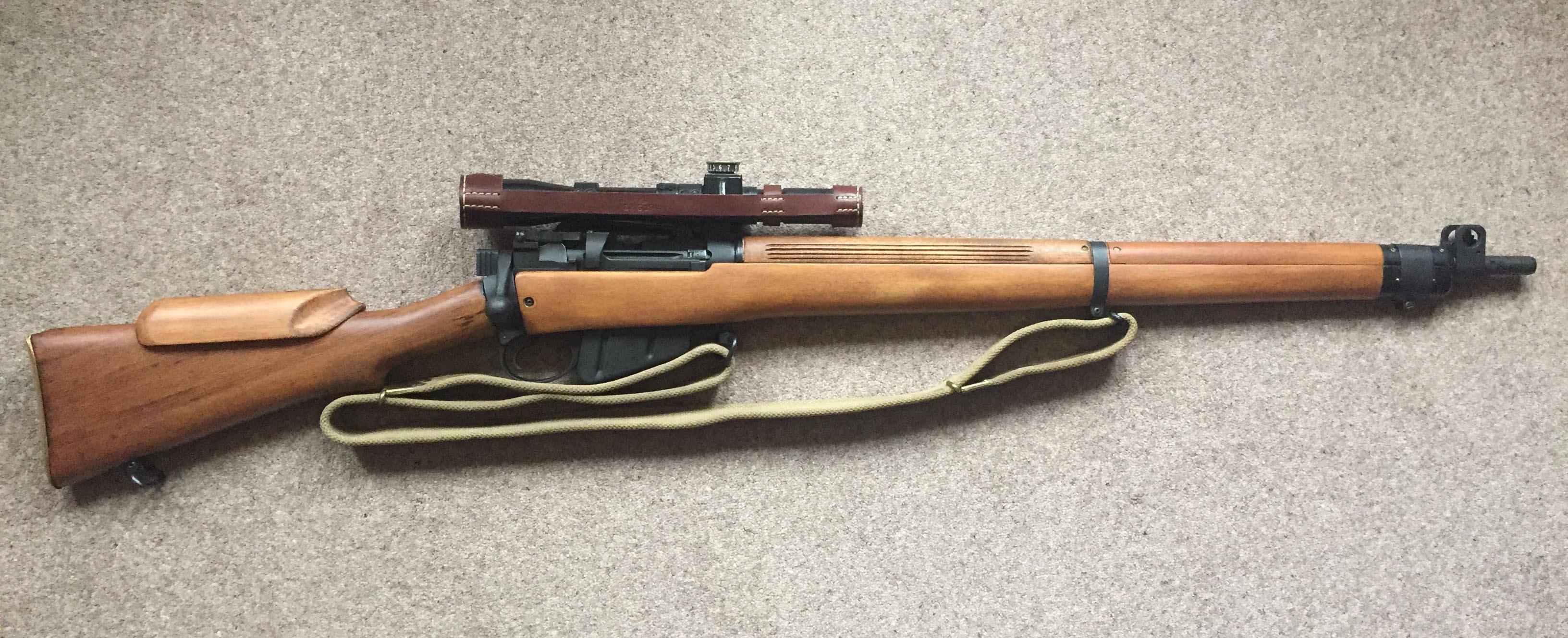

    I attach a pic of the groups shot a 100 yards off a rest with my No.32 scope (an original William Watson MK2 which I refurbed). PPU brass, 196gn PPU bullet sized to 0.3145". 40gn of RS50 and a S&B LR primer. MV is 2385fps. The rifle is blatant T replica, made of spare non matching numbered bits, the only original "T" bit is the scope! I have an unmolested Longbranch when I need to feel less dirty.
