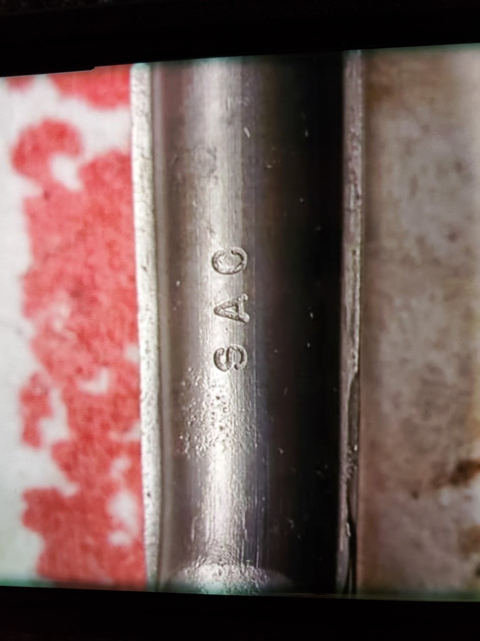

    Did Savage Arms Co. make barrels for M1icon Garand?
    If so how were they marked?
    Thanks for looking.

    Never heard or seen a Savage marked barrel for the M1icon rifle - but I suppose anything is possible -

    In this case a picture of the markings would be invaluable.

    Here's the only pic for us...text accompanies.
    " This is only pic have, marking is on top of bbl under handguard. They say no other markings on bbl. This was a recent CMPicon purchase."

    I would think that a barrel that was installed in a M1icon rifle would have a drawing number - the others did - example Marlin, Buffalo Arms, LMR etc

    maybe this?
    IA CO SAC CA which stands for InterAmerican Company, Sacramento, California which also was known as InterAmerican Import Export Company. Believe they went out of business sometime in the 1980's. No association with International Armament Corp. AKA Interarmsco, Interarms of Alexandria, Va. of which Sam Cummings founded.

    Marker is currently unknown. I DO know there were MANY crates of these barrel NEW in the Philippines...years prior to the CMPicon purchase. Speculation is some offshore contract for repair/rebuild of the MAP supplied garands.

    Quote Originally Posted by Jeremy View Post
    Thanks, finally. It makes sense.

    The SAC markings look like they were done with a vibro pen or similar tool. I would be interested to know of the gas cylinder pads are chrome lined?
