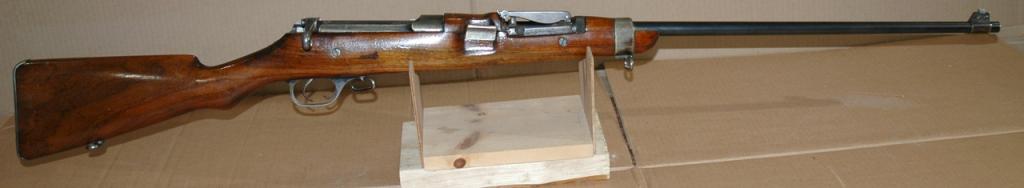

    New purchase - possible 1905 M
    Cross posted with the Ross Rifle Forum
    Well, I recently did something most uncharacteristic for myself and just MIGHT have come out on top. I tend to carefully mull things over before jumping in. Lost a lot of bargains that way. Didn't do that this time. A Ross 1905/Mk II sporter came up for sale online at a very attractive price and I pounced. It appeared to be either a Mk II with a MK III rear sight in a cut down stock, A 1905 M (First Type) sporter or a Mk II**** still with the Ross Mk III rear sight in a cut down stock. I was hoping it would be a 1905 M.
    It arrived not two hours ago and I took my first quick look. The rifle is in very nice condition if one looks past the slathered on varnish and the broken firing pin (which I was aware of). It has the early style bolt and someone probably broke the FP trying to get it apart. It also has the later wide mid band correctly positioned for an M, which made me think it might be a later conversion of a military rifle. The barrel is 28" and the bore appears to be at least very good. Now for the kicker! I popped the buttplate off and found serial # 445 stamped into the butt and the plate. If I am correct, only commercial rifles have the serial number in that location
    Am I getting excited over nothing, or have I likely scored an early 1905 M? What other possibilities might I have overlooked?
    Pics to follow, once I have had a chance to disassemble and photograph it.

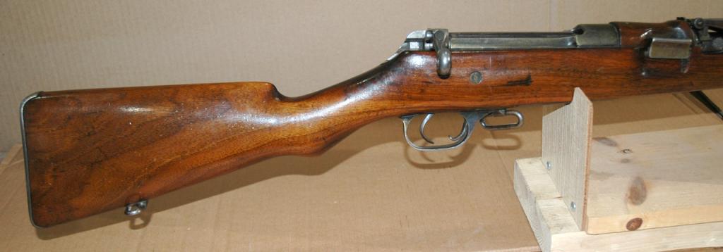

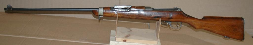

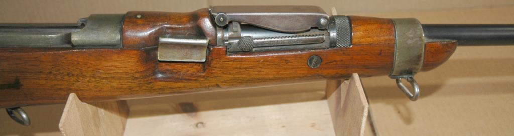

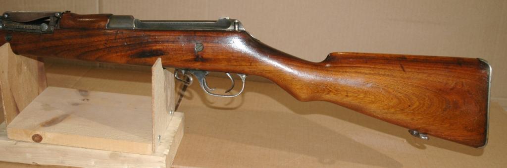

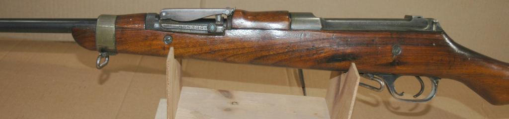

    Pics as promised:

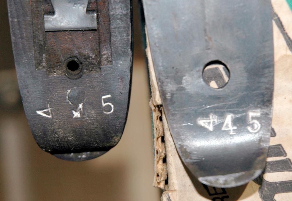

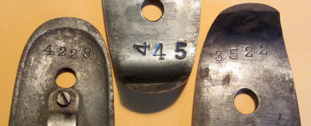

    The serial # only appears on the butt and buttplate. It is interesting that, in both cases, the first digit is turned 90 degrees

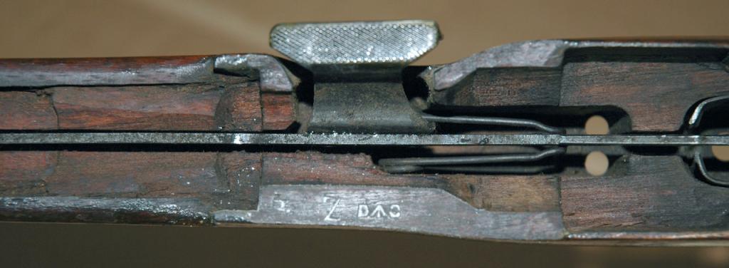

    There are a DC stamp and broadarrow on the stock, but that isn't surprising since the stocks are converted military stocks and it has been suggested that military rejects might well have been used.

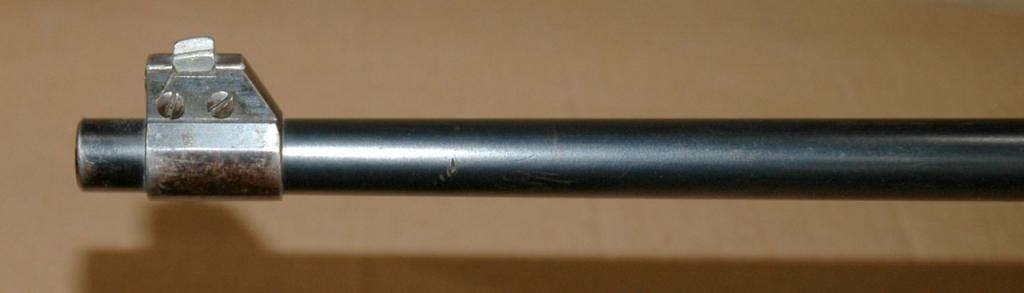

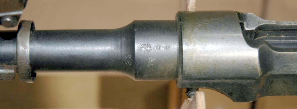

    There are no military inspectors or acceptance marks on the barrel or receiver. There is also no serial number.
    The rear sight is in excellent working condition.

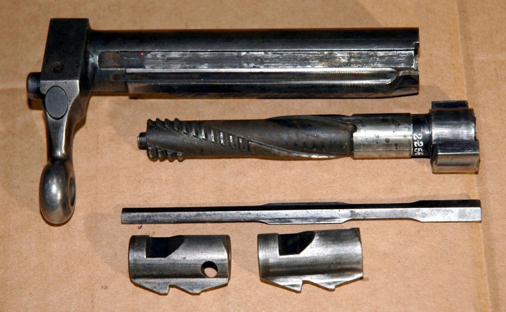

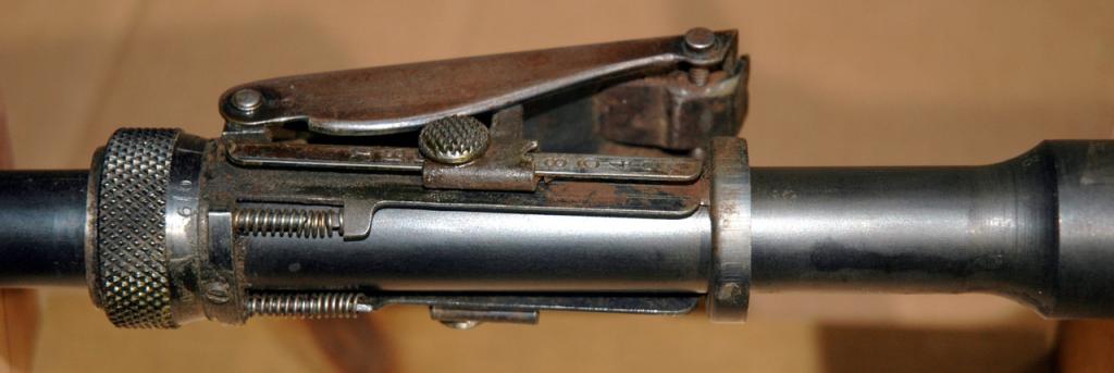

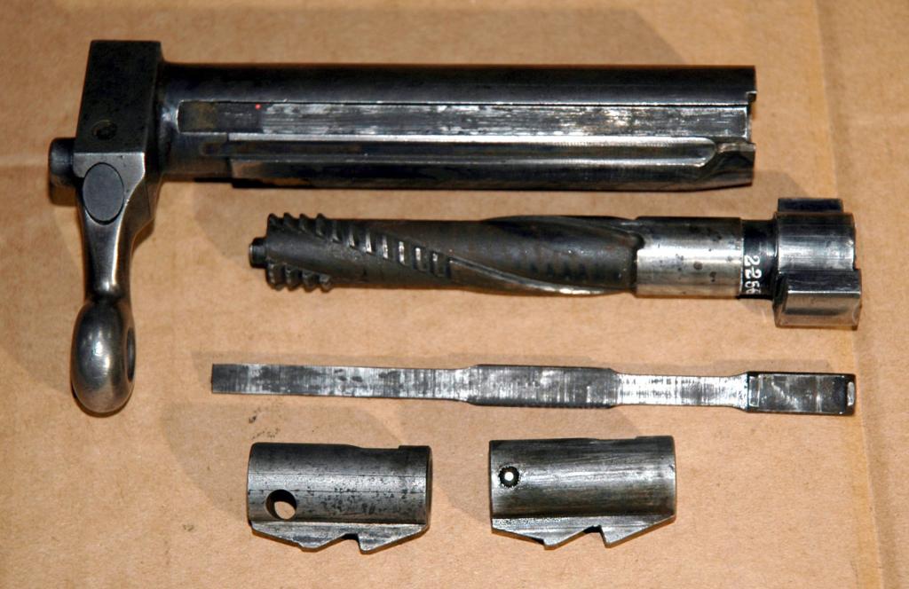

    The bolt has the early threaded firing pin and cocking piece, but does not have a slotted extractor. The later style cocking piece is shown for comparison.

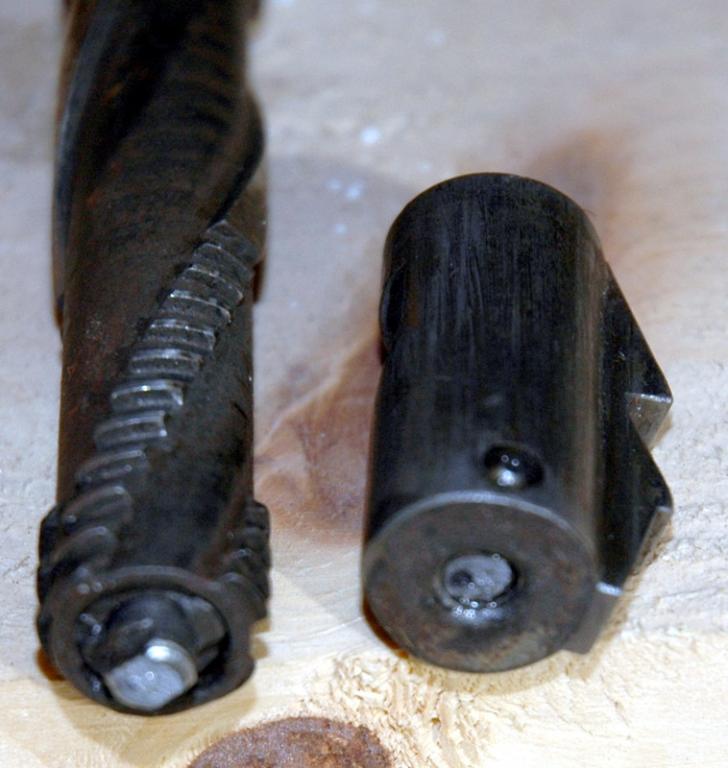

    Someone probably broke the firing pin while attempting to disassemble the bolt. I have since removed the FP stub from the cocking piece. I would like to find a replacement, but doubt that will be possible. I may have the broken FP TIG welded, convert a later style FP or scare up a piece of 3/8" drill rod and turn a new FP.
    I have additional pics if anyone would like to see something in particular.
    All comments, observations and suggestions will be appreciated.
    Thanks for looking
    I'd try that first. I broke a '73 Winchester firing pin which doubles as the back half of the bolt. We sharpened it like a pencil and welded and turned it down again. The original will fit better.

    Hello Bluenoser, I don`t want to say for sure this is not a 1905 M. But there are a few differences between your rifle and the 1st type 1905-M shown on page 141 in the Ross Rifle Story.
    This leads me to believe that this is a cut down military rifle.
    The rifle in the TRRS shows a Mk II roller coaster rear sight, 26" brrl, early style mid band,and flat butt-plate.
    Your rifle has the Mk III rear sight, 28" brrl, later mid band, and military butt-plate. The forend is shaped considerably different as well.
    The D^C on the stock would be a acceptance, property stamp. So likely would not have made it back to the factory.
    Any one or even two of these things would not rule this one out for me, as Ross was trying to use up parts that were no longer used for military rifles. But not all of them together.
    The numbers stamped under the butt-plate is interesting, although the numbers are a different size and font, and are upside down compared to the ones found on factory Ross sporters. The serial number would be low four digits by this time as well.
    It is at least a nicely done sporter.
    Cheers

    The serial number is the primary reason I lean toward this being a 1905 M. The font is different, it is larger and it is upside down, for which I have no explanation. That said, I have never seen a serial number in that location on a military rifle.

    There is no "303 Ross" stamp on the knox.
    I have come to realize the absence of military acceptance marks on the barrel of a Ross does not imply a commercial rifle.

    The serial number is the biggest red flag on this one.
    You say yourself that the lowest serial number listed is 894 this would be for one of the type with the early parts shown in the Ross Rifle Story.
    You have one numbered approx. half that, putting it in the 1903 rifle number range. The first 1905-M was shown in the 1906-1907 catalogue.
    If they were going to use the parts on your rifle it would likely be 1908-1909. I have a very early 1905-R (earliest I have ever seen and I have seen lots) the serial number is above 1900. It would have been made early 1908.
    The numbers on your rifle are twice the size, the wrong font, applied crudely, and are not in the correct range for date manufactured.

    Here is a comparison of the serial number on the subject rifle to those found on known commercial Ross rifles. The subject rifle is flanked by a 1905 R on the left and a Mk II** on the right. The subject has been flipped to make comparison easier.
    I agree the font is slightly different and at a larger pitch. The difference is most noticeable in the 4. It measures 0.205" or about 15 points compared to 0.133" or about 10 points on the others. That makes it approximately 1.5 times as large and I cannot agree that it was applied any more crudely than were the others. All of the foregoing is likely of little or no importance.
    I am trying to consider all possibilities regarding the origin of this rifle in it's present form. I think it quite unlikely that the average individual cutting down a military rifle would go to the trouble of applying that number, and I think it less than likely they would know what a Ross-applied serial number looks like, or where to find it. There is another possibility worth considering. I wonder if there might have been someone engaged in the business of converting Ross military rifles to sporting rifles on a commercial scale, and if they might have been modelling them after Ross sporting rifles. I can see such an enterprise wanting to apply a serial number in a manner similar to Ross-produced rifles while, at the same time, wanting them to be distinctly different. If that were the case, I would think someone in the collecting community might have become aware of it.
    On the subject of the sideways 4: I have been reading the number as 445. I wonder if it might be # 45 in group or batch 4.

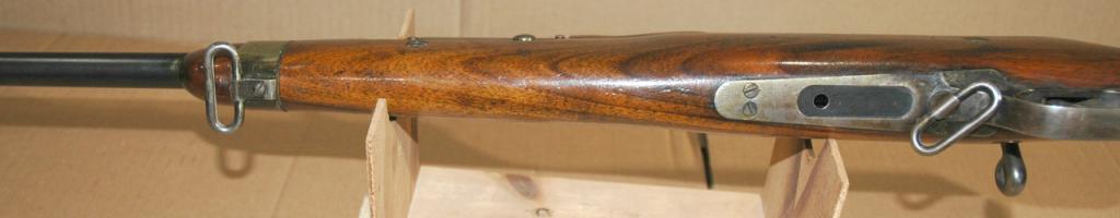

    I made an interesting discovery while putting the buttplates back on the rifles.
    Firstly, the curvature of the commercial buttplate appears to be precisely the same as that of the military buttplate (except for the ends) and the lower screw is in the same location. The military buttplate, of course, curves inward at each end.
    Secondly, there is a plug in the end of the butt of the subject rifle. It can be seen in the 9th photo in the 3rd post. When the commercial buttplate is laid on the butt and the lower screw is inserted, that plug lines up precisely with the upper hole in the commercial buttplate. I am not sure what to make of it.
