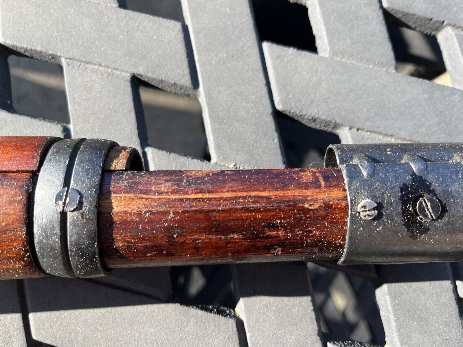

    I have a nice late-war Kreigs Modell stock. I have the barrel bands and they look decent, as well. But I do not have the very small wood screws to secure the bands in place. Not sure what to do or where to look. Anybody have any ideas? Thanks guys.

    They look like cut wood screws, if these are correct? Just an old cut wood screw?

    You use to be able to buy traditional steel wood screws that were pre "blackened" during manufacture. If you can't source theses off, say eBay, you could just paint or blue "normal steel" traditional wood screws.
    If you know of an "old school" hardware shop near you that has been in business a long time they may still have some old style wood screws in stock.
    Traditional countersunk wood screws come in 2 styles (of countersunk head), either normal countersunk with a flat head/face, or raised head countersunk which has a curved head to the screw.
    Exactly what I'm talking about too. I'm saving old screws from old things taken apart.

    …you could just paint or blue "normal steel" traditional wood screws.
    Heat with a torch and drop into any oil (engine, vegetable, whatever you have) and I bet they’d blend right in.
    Seconds per screw.

    These folks seem to have any screw imaginable. You might have a look here.
    McMaster-Carr
    or these
    Wood Screws Black Japanned – Slotted Round Head 8 x 3/4in (Pack 25) | Select The Right Tool : UK Tool Centre

    The front band screws used on dot and swp Czechicon made K98kicon rifles were leftover Vz24 stock disc screws. A slot was cut across the head so a flat head screwdriver could be used.
