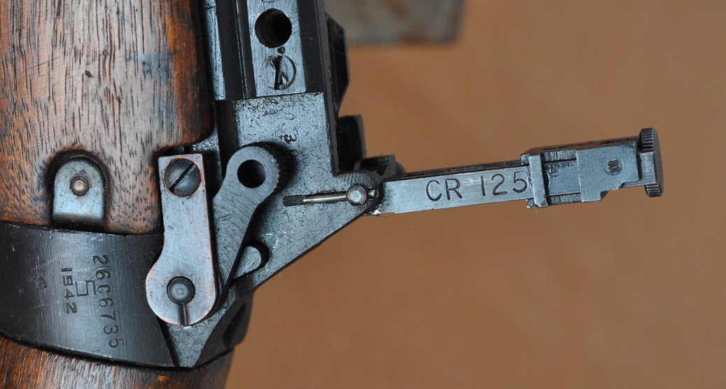

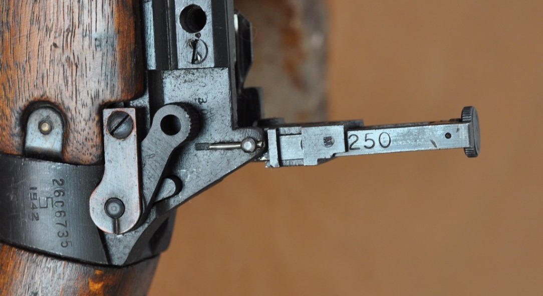

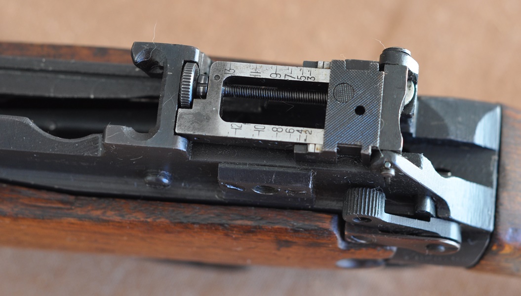

    What is the meaning of the abbreviation CR 1250 on this rear sight?
    In my opinion it is the rear sight for the L42A1, correct?
    Thank you.
    Giancarlo

    The CR number was a number allocated to pieces of equipment/parts by the Ministry of Supply. You tend to see them on post-WW2 parts. The sight looks satisfactory to me. The cursor has been modified to account for the flatter shooting 7.62mm ballistics, & it bears a 'M' indicating that it is metricised. Being a Faz No4 rearsight originally it is highly unlikely to have been on a wartime 4T, but rather it is likely to be a post-war 4T replacement, or even a replacement from the L42 era. Having said that, they are easy enough to convert - I've done quite a few myself.
    Re the rifle: I would examine it closely if considering purchase, bearing in mind the very high serial number for a Savage rifle that purports to have been a 4T conversion.

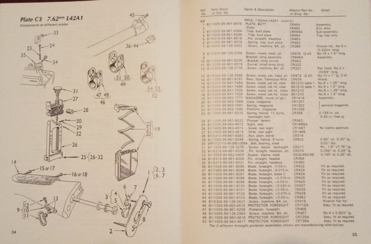

    I saw this plate from the pamphlet "SAIS No. 18, 7.62 mm L42A1......." by Ian Skennertonicon
    and there the leaf (scale) bears CR1487.
    The metric conversion must have taken place after 1965. Correct?

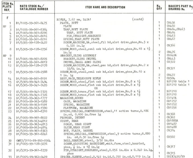

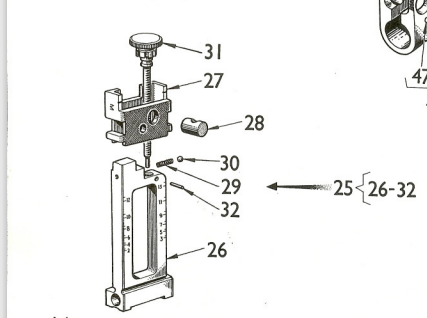

    Items 25 to 32 are the components of the rear sight (According to the military L42 Parts List - I have posted a copy of it some years ago into the Milsurps library) Each component has a CR number and the complete rear sight is item No25

    Looks as though 'new' CR numbers were in the main allocated, most likely when the parts went from 303 No4 to 7.62mm L42A1. At least, both the cursor & leaf have different numbers.....
