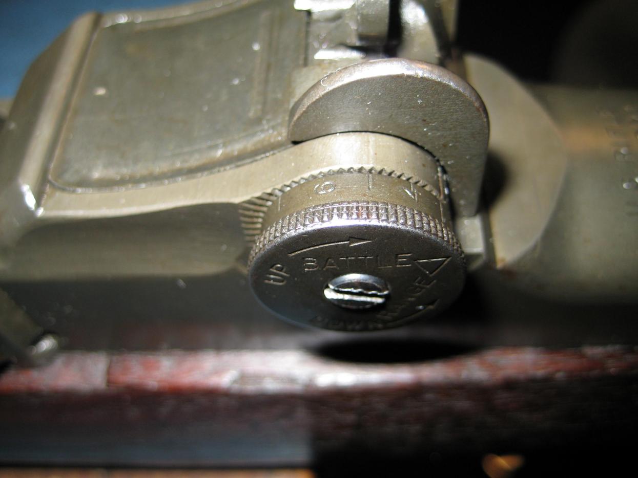

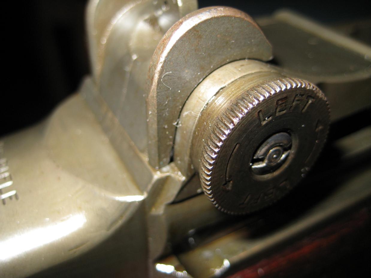

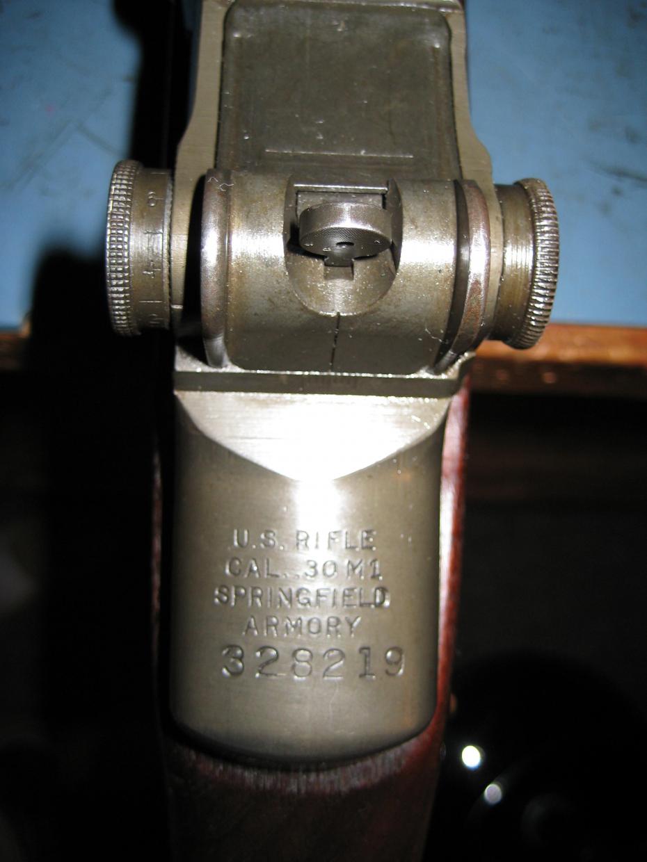

    Quote Originally Posted by crowtalks View Post
    Ah...I didn't think about the flush-nut sight...I don't think I have ever seen one.
    Here's mine...

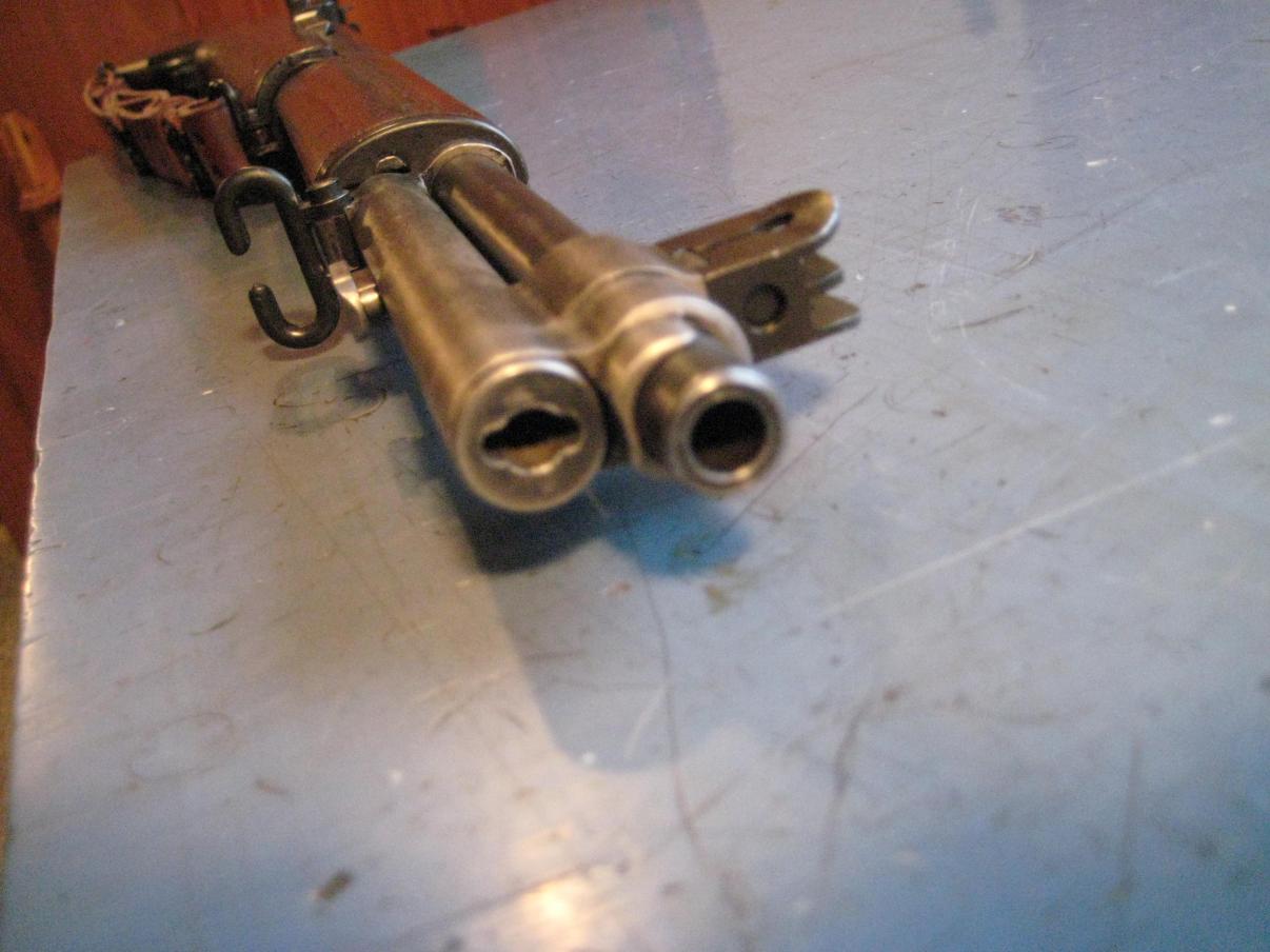

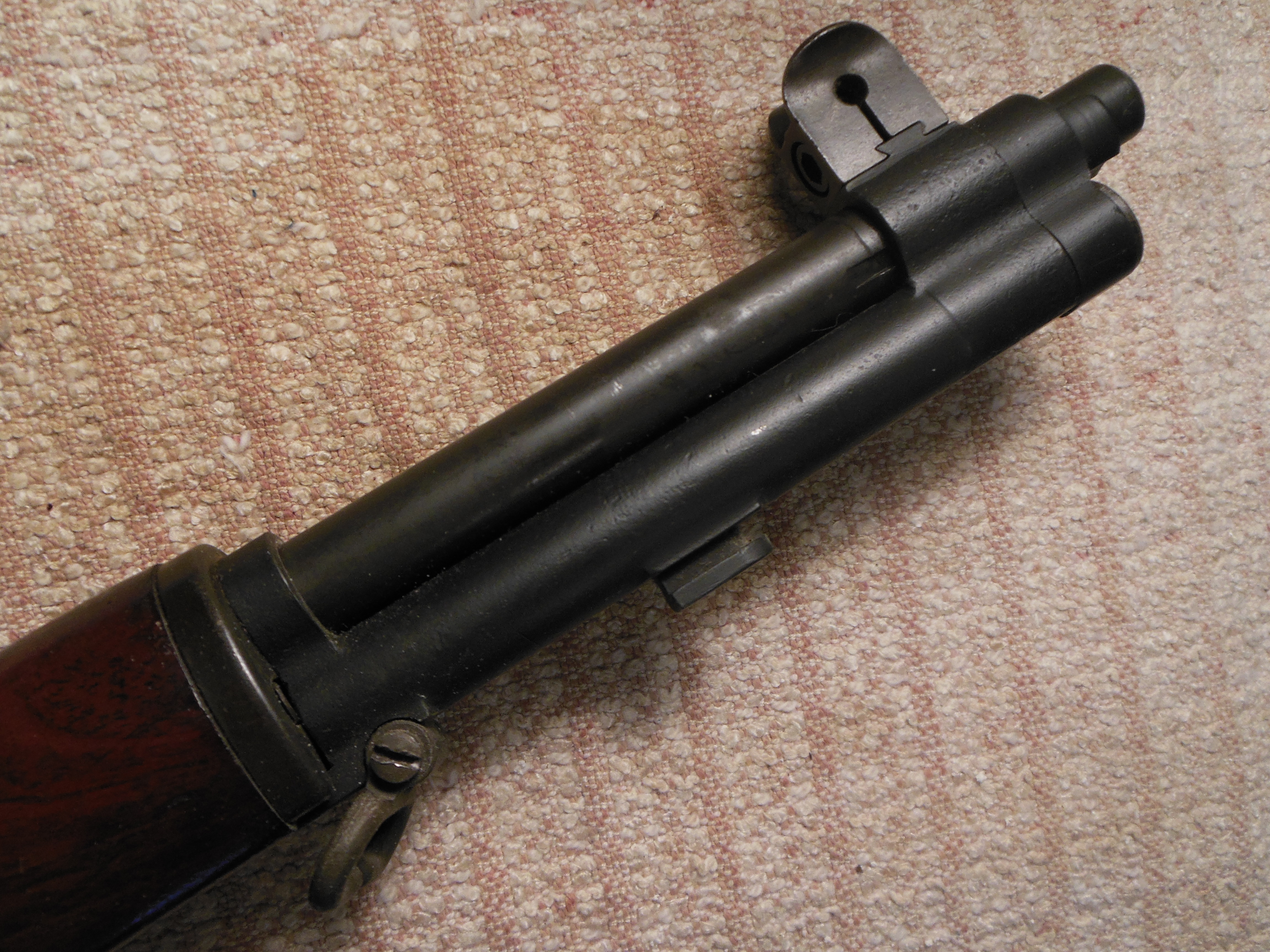

    Winchester gas cylinders did not have the bevel on the bayonet stud
    Here's my Springfield to show the difference, best pic I have for comparison...

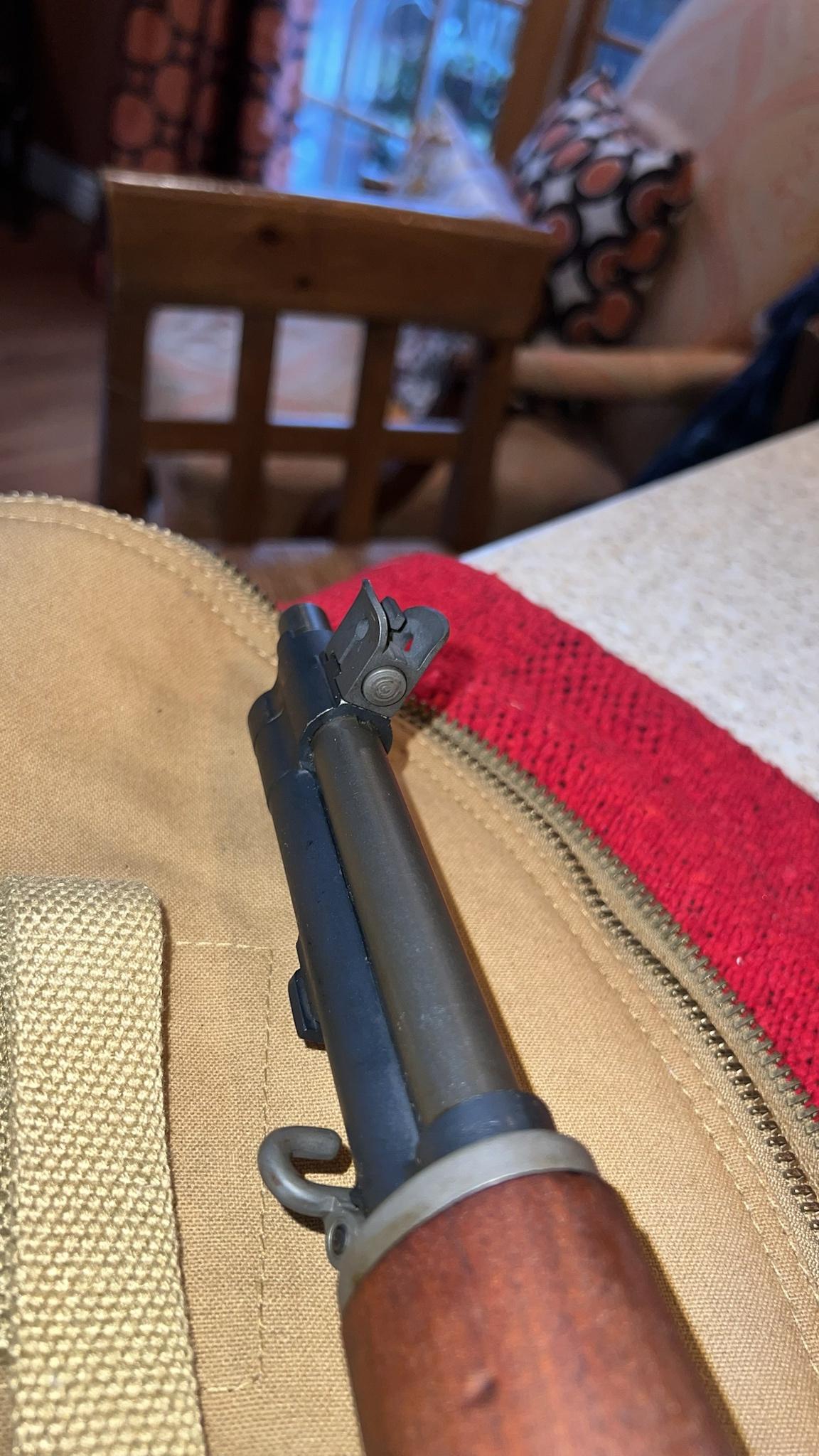

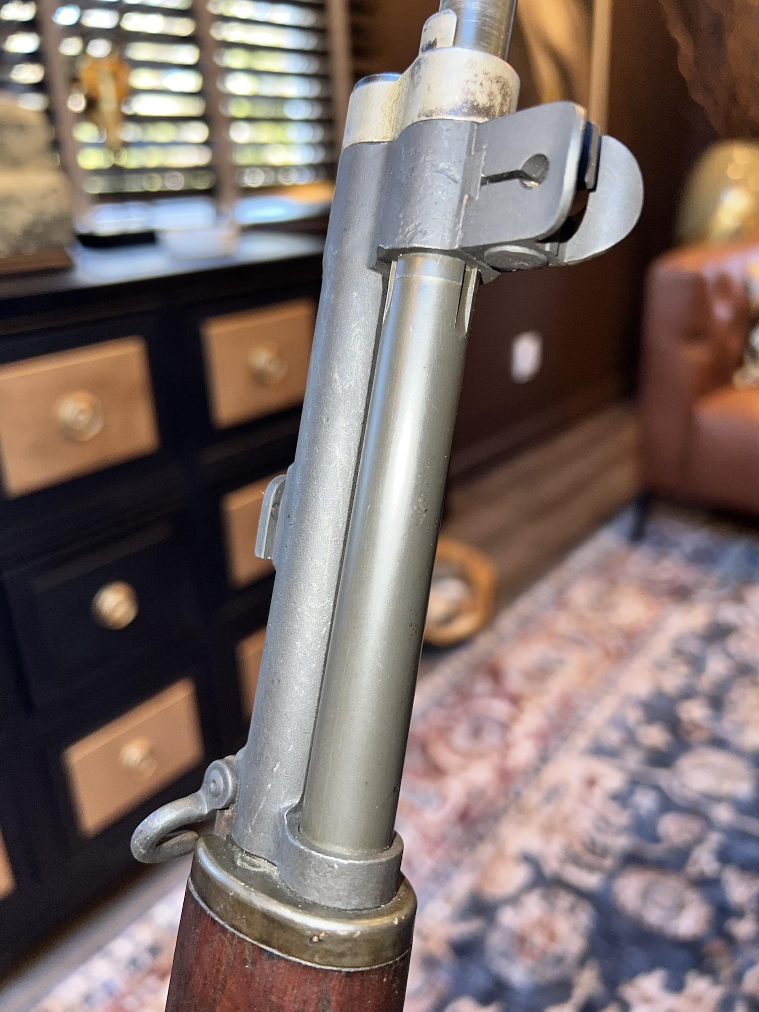

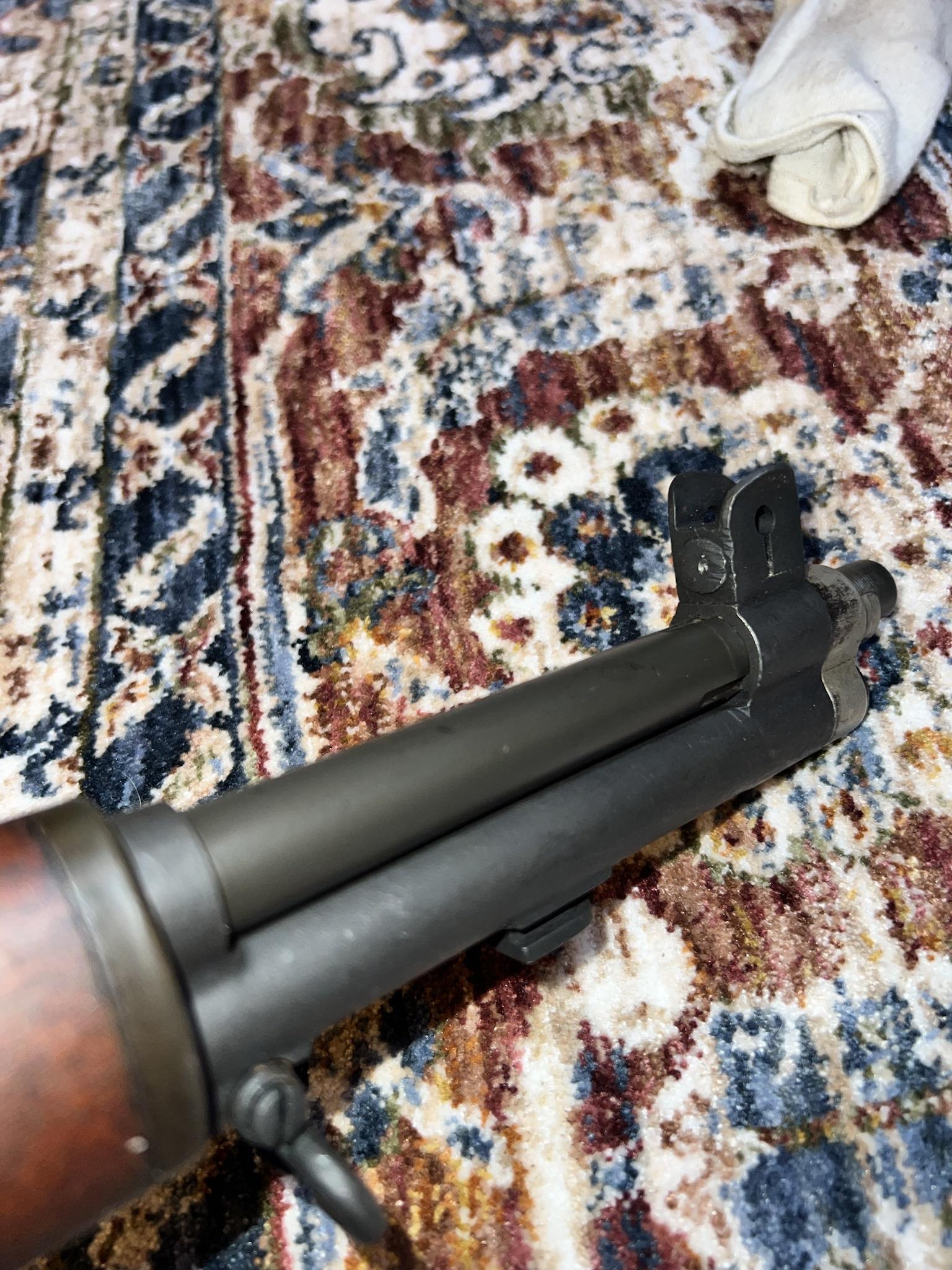

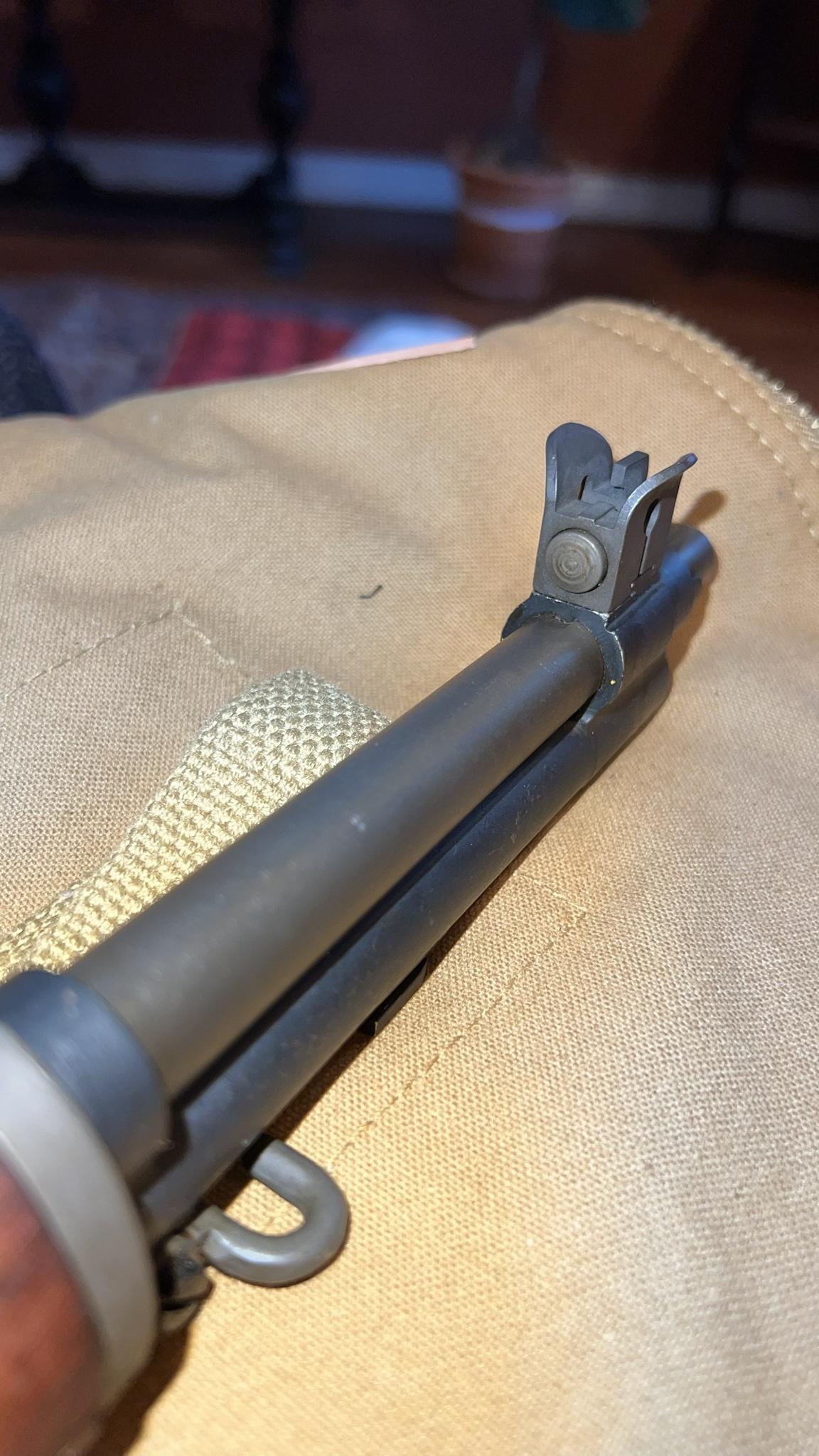

    Don't mean to hijack the thread, but regarding Winchester gas cylinders, would any experts be able to identify if the finish on this particular one is original? It's just not something I am adept at yet. I only to look for a Du-Lite finish but I don't even know if I'm properly understanding it.
    Here's the one in question
    Here's the one on my '43
