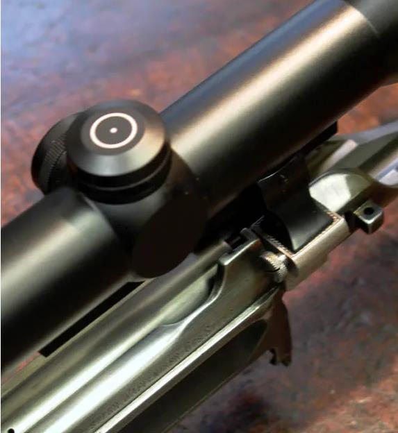

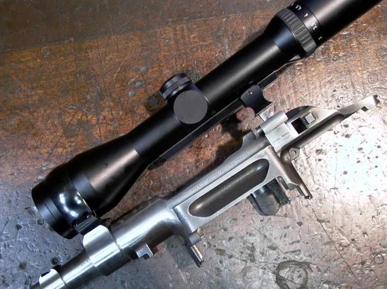

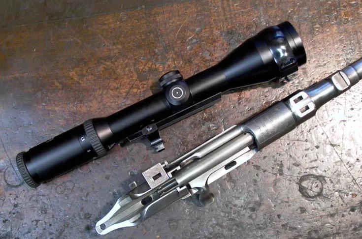

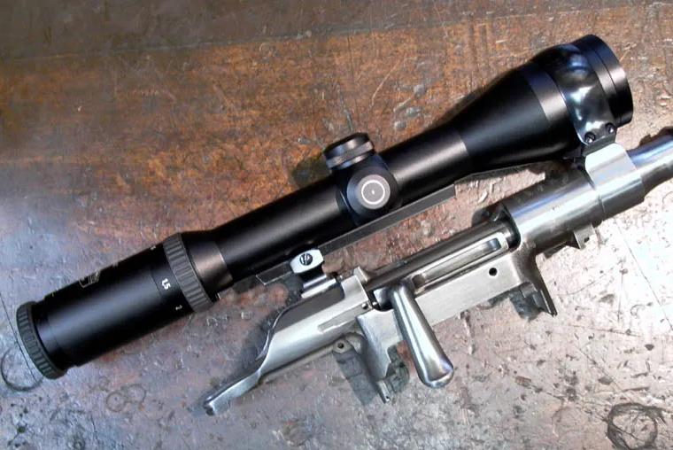

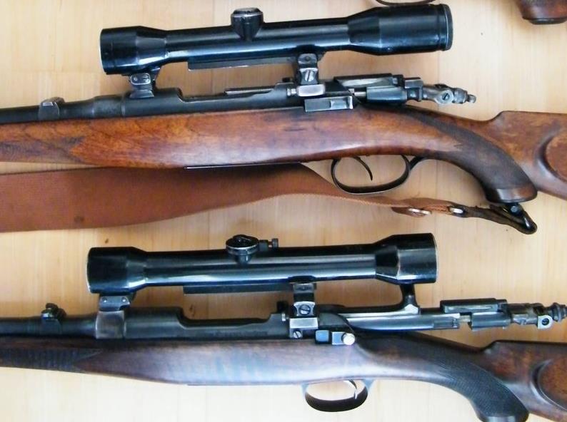

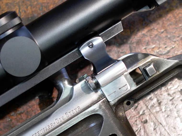

    Quote Originally Posted by Neuraleanus View Post
    Assuming that I could acquire the parts I would like to know how it all went together.
    You're looking for a Mannlicher-Schoenauer scope mount. Here's a link and a few pics of what one with single claw would look like. You can make your own base for the rear... https://bbs.homeshopmachinist.net/fo...pe-mount-build

    Mannlicher, Austrian, on an English rifle, Hmm. I'm going to do something simpler and mount a Parker Hale sight. It has been ordered.
