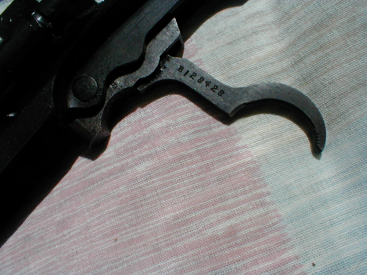

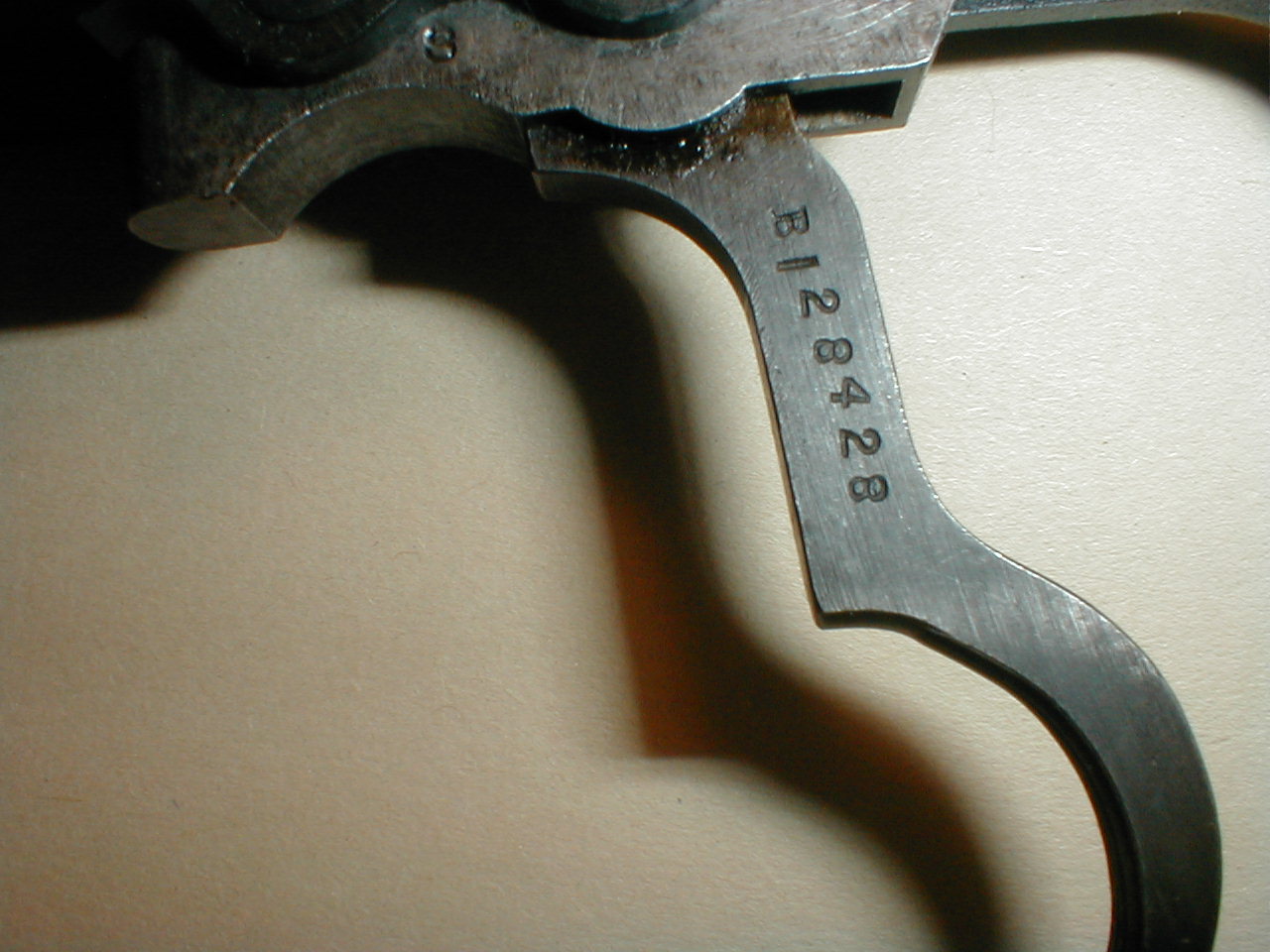

    trigger for M1903A1
    This trigger would be correct as they started with the drawing numbers late in the 1930's, NM trigger has different number.
    Actually, i have no idea where you find one with the drawing number
