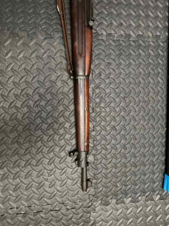

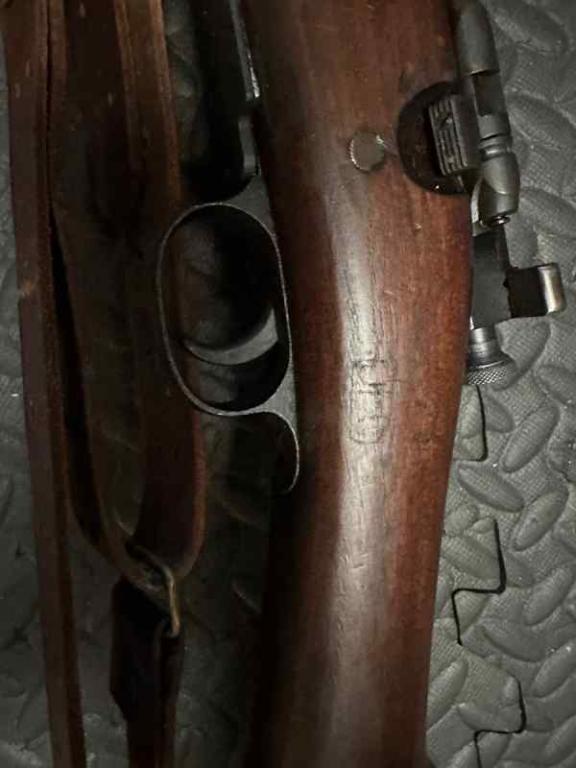

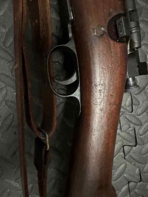

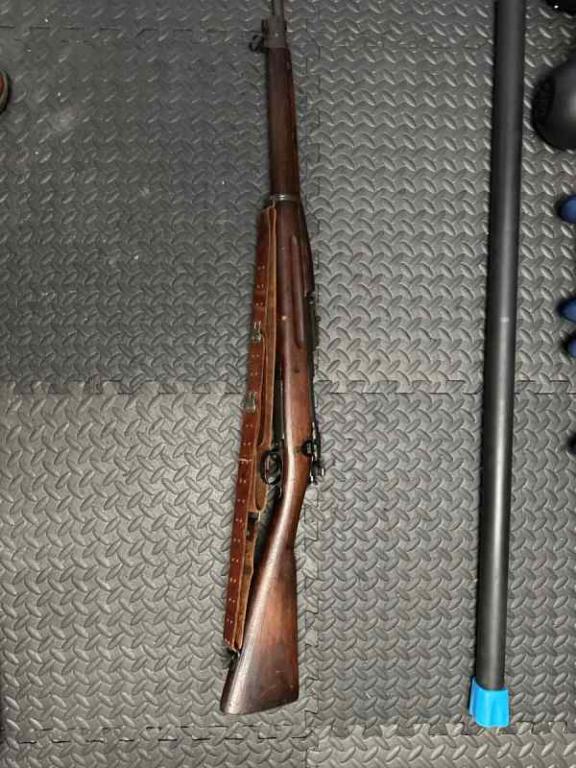

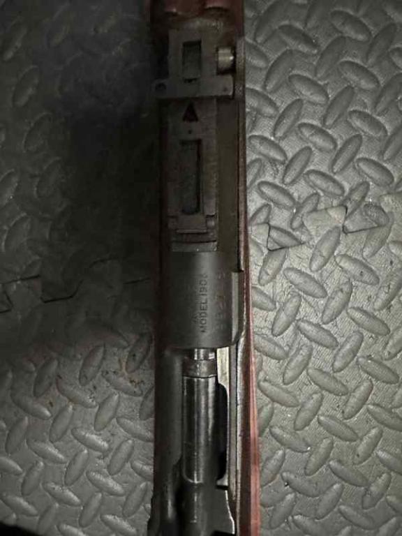

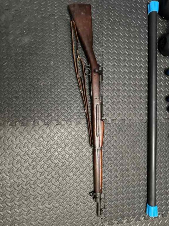

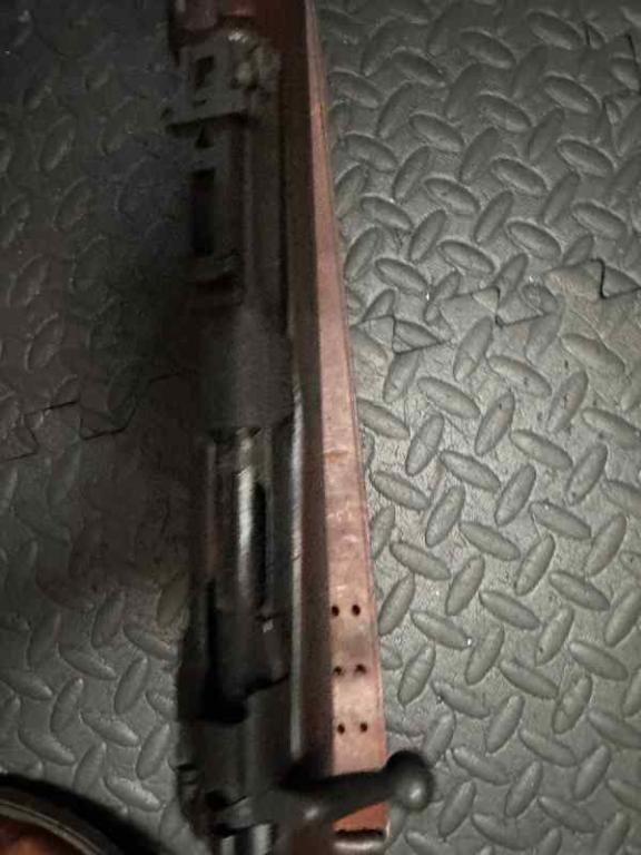

    Opinion of this 1903

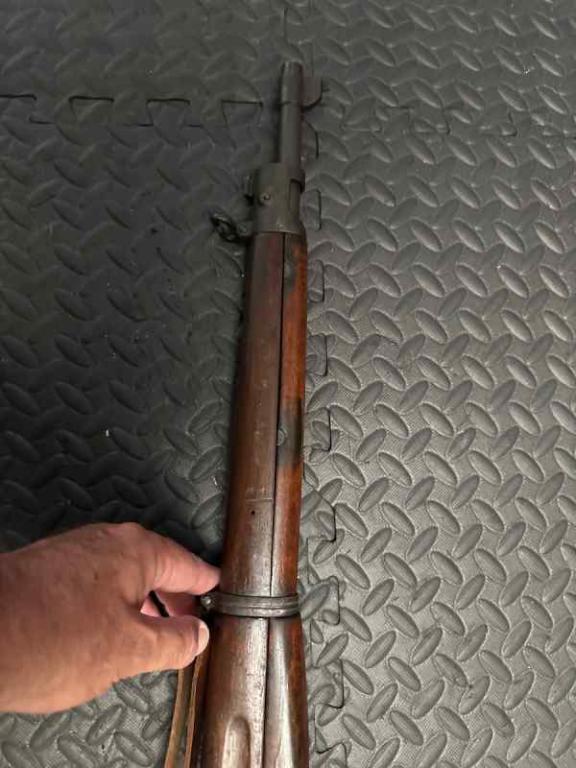

    I know there is not much info here but would you buy it sight unseen?
    upload image anonymous
    ---------- Post added at 09:27 AM ---------- Previous post was at 09:25 AM ----------
    more pics.
    ---------- Post added at 09:29 AM ---------- Previous post was at 09:27 AM ----------
    More pics
    ---------- Post added at 09:34 AM ---------- Previous post was at 09:29 AM ----------
    I am told the barrel date is 1928.

    Quote Originally Posted by Mjac View Post
    For $120, yes,

    So 800 shipped would be a maybe?
    Oct 2015
    Today @ 08:39 AM
    long island, ny
    703
    Bill
    05-09-2025
    09:24 AM

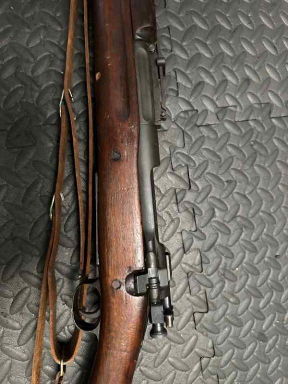

    Handguard seems off shade, not a big deal unless it is incorrect. The barrel date may be 1928 but it looks like a straight bolt handle which means low serial number, unless the bolt was swapped. The pictures are awful, can't tell if it's a Springfield or Rock Island from either the barrel or receiver shots. The cartouch in these pictures looks like it was done freehand. Do you know the maker and the serial number? Personally I would pass because I don't like what I see. But I don't buy sight unseen anyway. Too many possible variables with 100 year guns.

    Quote Originally Posted by oldfoneguy View Post
    Yes sir, true enough. The pictures are not mine and the seller has not furnished any other info at this point. My interest is fading but it is/was fairly local (at least in the same state) I'll be passing for many of the same reasons you mentioned. Thanks.
    I had a A3 years ago and foolishly sold it. I am searching for another milsurp to satisfy the itch and have forgotten the many things to look for. Back to school for me, the search continues.
    Thanks again.
    My first thought was perhaps sanded and refinished at some point would make the stamp look muddy like that - so would a very bad picture - so could 100 years of grime and/or past wet.
