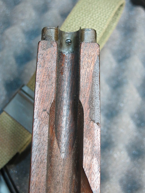

    Previous owner did not know who made the stock. What sort of photos and description could help identify the manufacturer? We can find no stamps on it. Just some dings.

    100% Springfield stock. What markings are on the back end? Small indents up front on left indicate between GAW and NFR with some carry over to post war. But I think these Post War stocks were left overs from WWII Rick Bicon

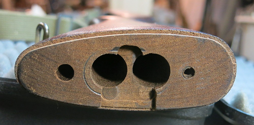

    Where on the back end?

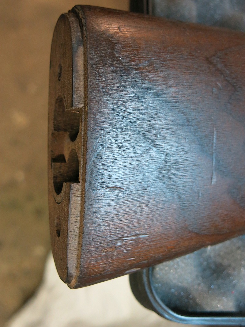

    Here's a right side view of the back.
    Not even a hint of any stamps on the sides.

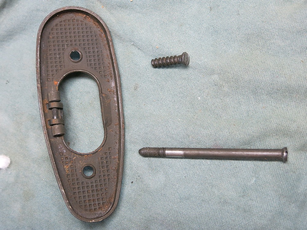

    The butt plate ( which I assume CMPicon could have installed )

    I need to see the back end not the side. Rick Bicon

    Sorry. I don't know what you want a photo of. To me the back end would be the stock butt.

    Thats it. I am putting this stock around after WWII I missed it if it was posted in the 1st post. Rick Bicon
