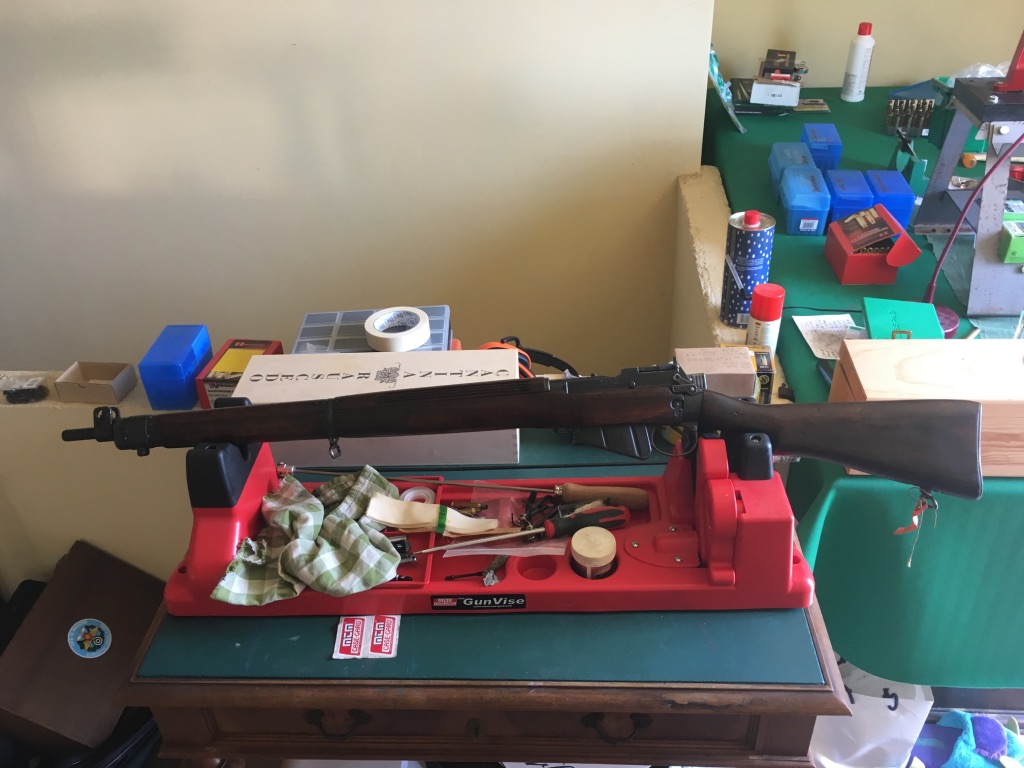

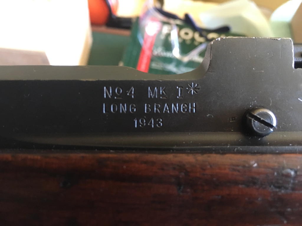

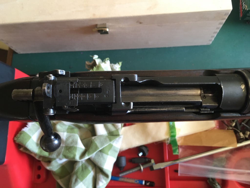

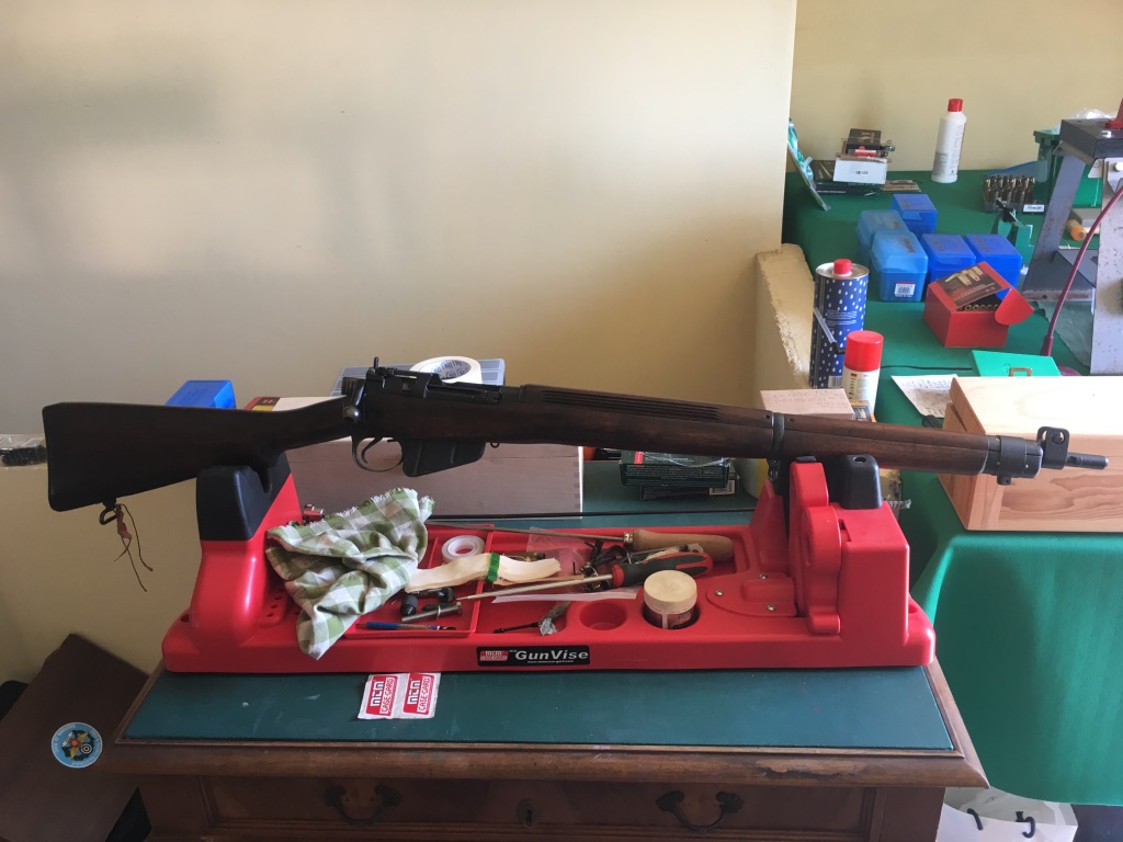

    Hi Geo, I have a 1943 Long Branch myself, and it has the sight you can see here in the pictures.

    A 1943 Long Branch like the OP's would have had a Mk.2 300 - 600 yard aperture sight. Many were replaced in Canadianicon service with the Canadian made Mk.3 adjustable rear sight with the milled base like Ovidio's pictured in thread #2. In Britishicon service they were replaced with the British Mk.III and also Mk.1 which was a superior sight. The Mk.3 sight wasn't standard until 1944 in Canadian production and was later upgraded to the C Mk.3 which you'll find on 1949 through the end of production. They made changes to the latch on the slide to make it more durable. The OP's rifle is out of British service as it still sports remnants of the paint finish.
