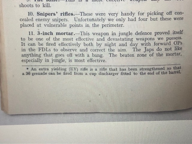

    EY Rifle meaning - Extra Yielding.
    I recently stumbled upon this late war 1945 pamphlet - Jungle Jottings. I noticed at the bottom of one of the pages "An extra yielding (EY) rifle is a rifle that has been strengthened so that a 36 grenade can be fired from a cup discharger fitted to the end of the barrel." I have never heard of an EY rifle being described as Extra Yielding.

    Interesting, never have I heard it either.

    Every reference I have seen says EY is Emergency use onlY
    A grenade firing rifle is marked GF

    I agree with A d E though many EY rifles were converted as a ready stock of rifles at hand. I haven't seen a EY rifle with a GF stamp even though it is a GF converted rifle. Neither have i seen a GF stamped rifle with a EY stamp. Both doing the same the same job coming from different starting points.

    But there are EY rifles 'out in the wild' that are not GF rifles, so my thinking is that EY could not mean it was a GF rifle.
    My understanding is that the EY rifles had already been designated as 'second grade', probably because of wear and inaccuracy, so using them for conversion to GF 'saved' front line rifles being used for something that did not need a top quality rifle.
    The fact the booklet quotes the 'War Office' and 'Crown Copyright' would suggest it is a Britishicon publication.

    I'm not sure, in my time, that there was ever a difference between EY rifles and GF rifles according to the EMER's, our bible.
    EY indicated EmergencY and the last of these grenade firing No1 rifles I recall were all strengthened to be fitted with the old cup dischargers - which we didn't have - to throw the old No36 grenade!!!!! They were refurbished for war reserve stocks in the late 60's and we never saw them again. A lot of these rifles were clearly drawn from stocks of what were known as SUB STANDARD....., with silver band around the butt and fore-end. The EY's and SS's differed only in that the barrel gauging criteria was more relaxed and the fore-emnds could have more than 3 patches. Don't quote me as that is from memory of seeing them being overhauled
    These rifles had the usual wire wrapping, put on by a fantastic simple method, using an old lathe bed and motor set to very slow and a matt khaki band around the butt with EY stencilled on the band in 1" markings. Not dissimilar to the DP rifles of the time
    I didn't see specific GF or Grenade Firing rifles except for those No4's, No5's and L1A1's fitted with grenade dischargers. And these grenades were anti-vehicle Energa grenades

    To add to pile but Skennertonicon noted and I confirmed an unpublished manuscript refering to the EY marking as Edward Yule who was involved with grenade launching. For whart it is worth. I remember it because it did not make sense then or now.
