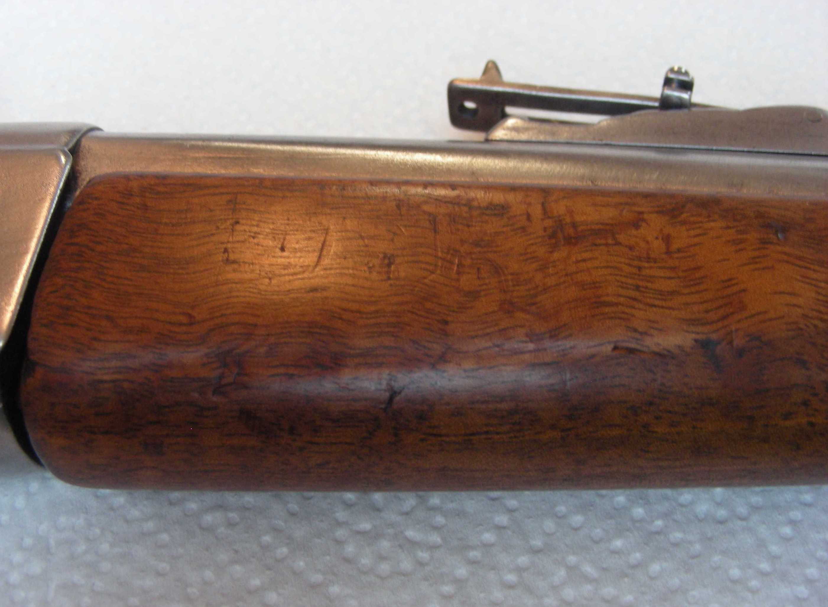

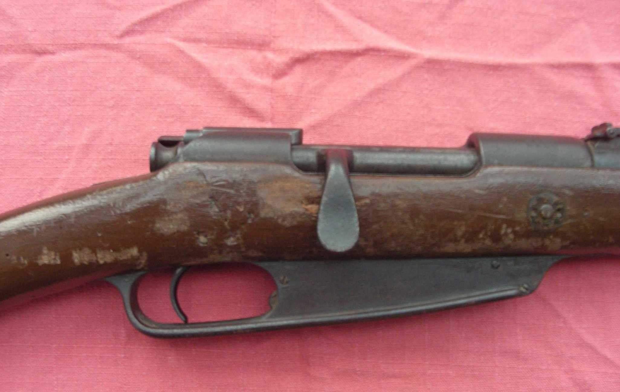

    Refurbishing an Argentine RB - Part 5
    Just to remind you where we are going:
    The wood on the Mahdi is a very fine, hard walnut (look at the rounded metal, and look how well the wood has stood up to the same environment).
    The wood on the your RB is probably the same. But how are we going to get it looking good, without Bubbaring?

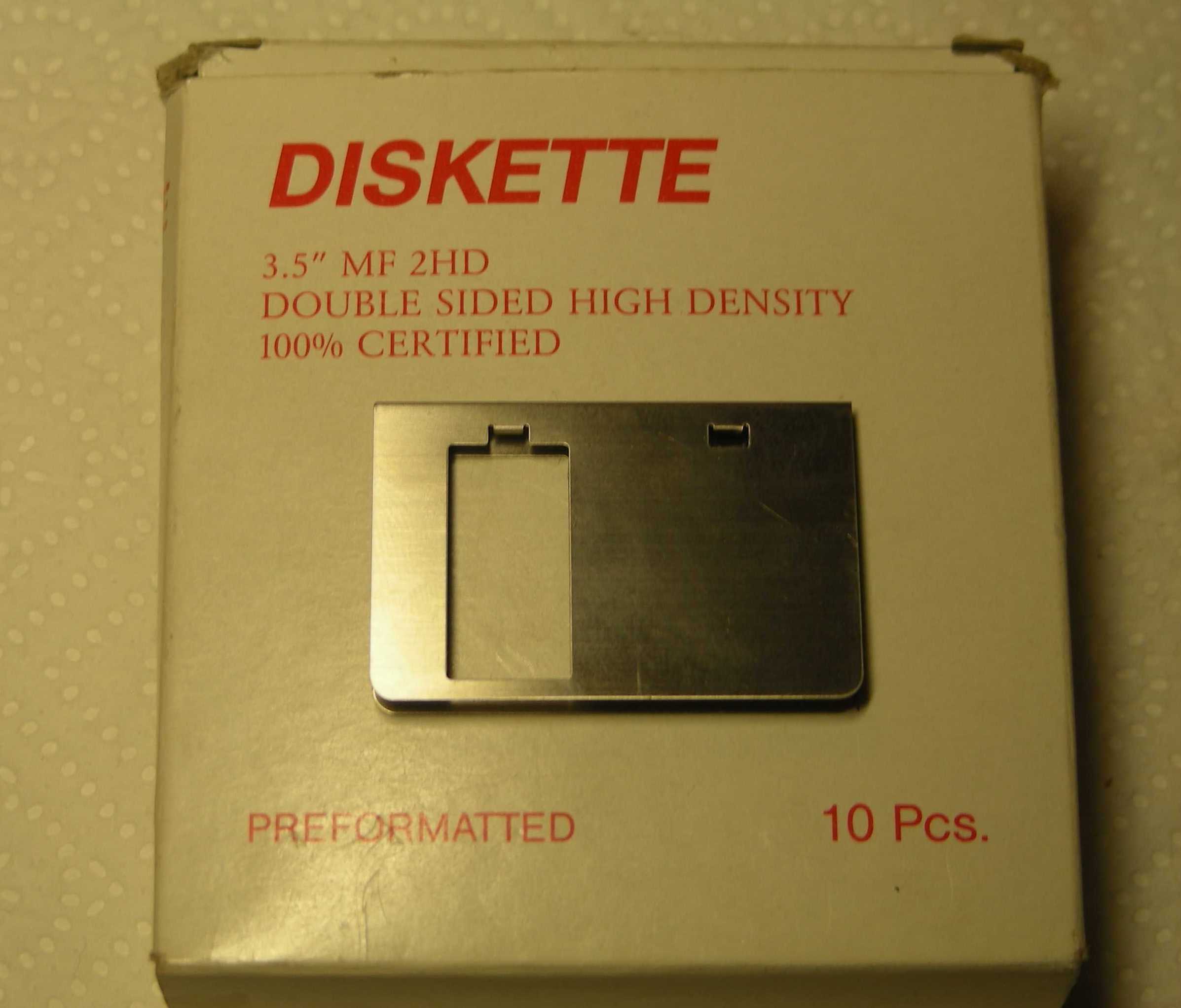

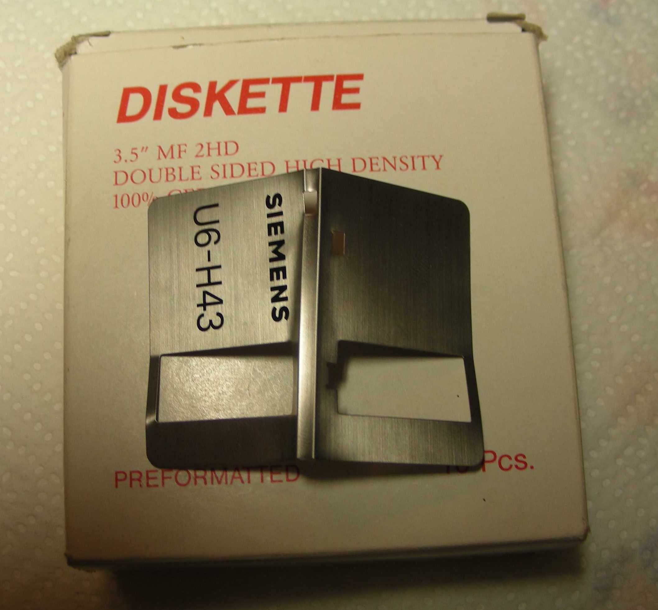

    "It might come in handy one day." If that is a typical phrase for you (as for me) then we are both packrats, with a cellar full of junk that we are reluctant to bin. But once in a while we are proven right (and we forget the other 99%).

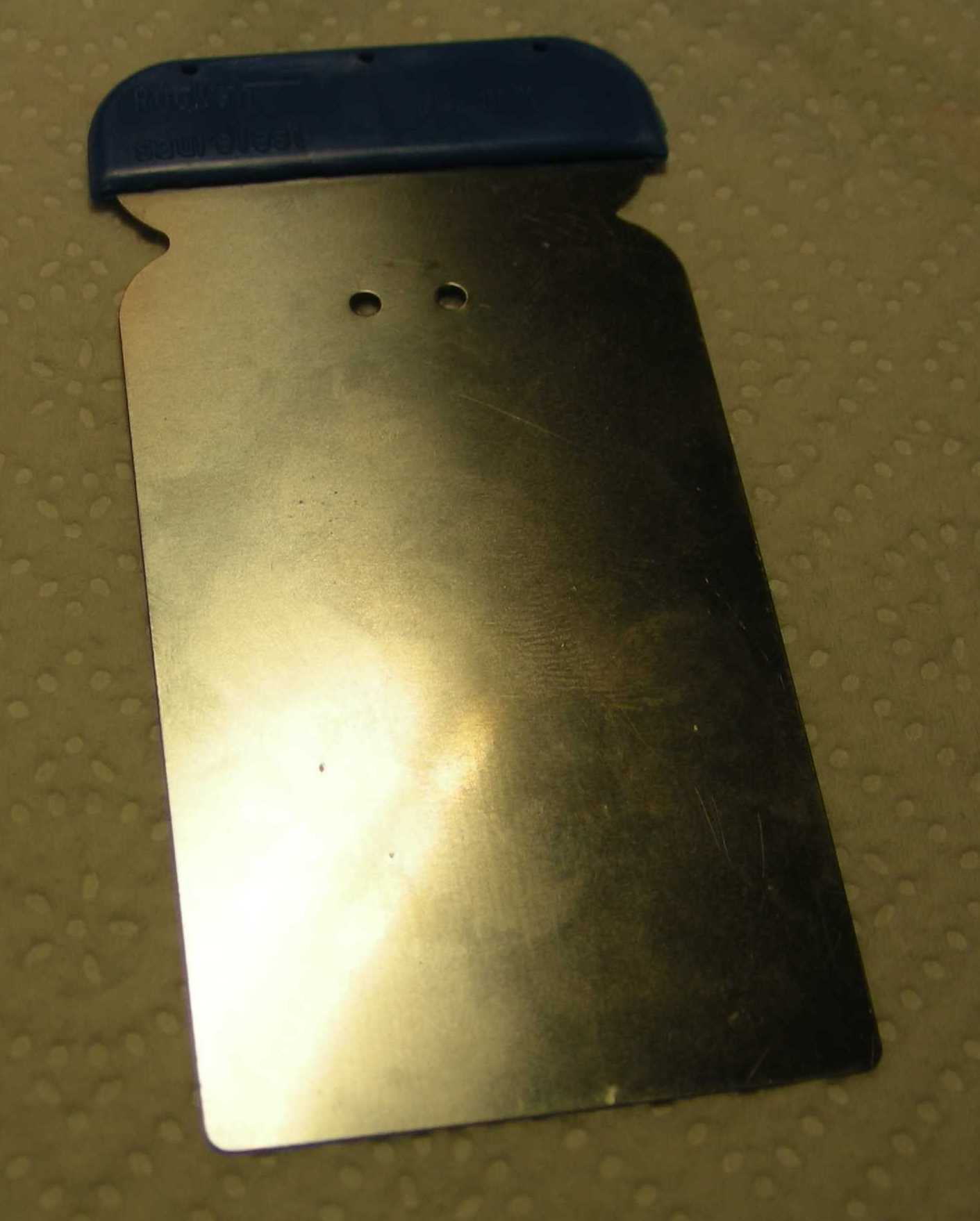

    So wasn't it a good idea to keep those old 3.5" diskettes!

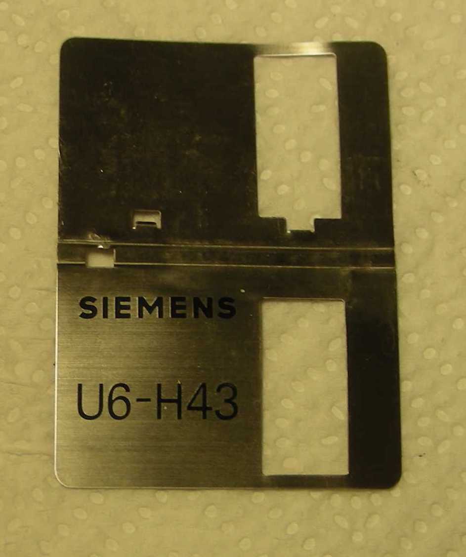

    If you bend the disk cover open slightly you can pop it off.
    A small wire spring with a loop will fly out and land somewhere where it is invisible. Good packrats will catch these springs and keep them in a little box for the famous "...one day".
    What intererest us at present is the metal cover. This is made of a material that appears to be a kind of stainless steel. It is only weakly attracted by a magnet, and presumably has very little remanent magnetism - otherwise it would tend to wipe the disk!
    Be warned! The edges of these things can be very sharp!

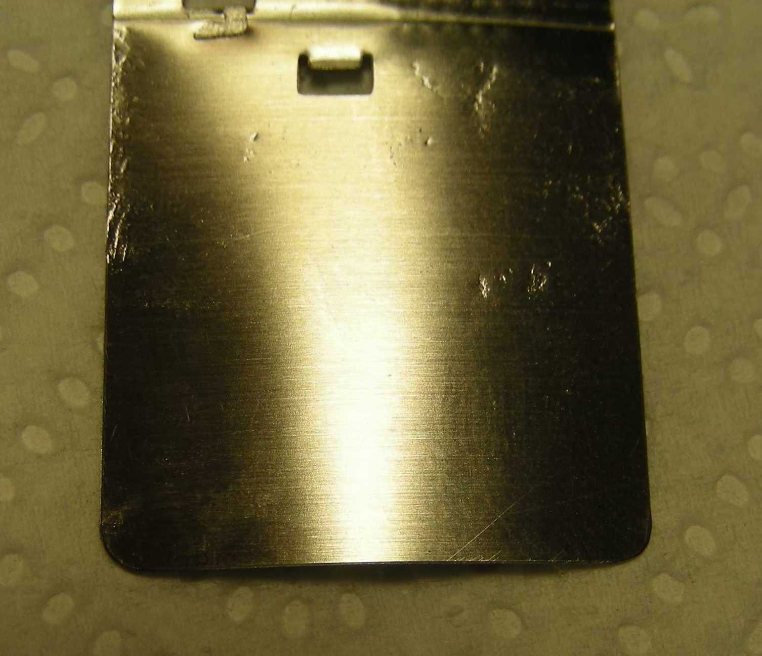

    Now open up the cover plate and use a plastic hammer to flatten it right out on something that serves as an anvil.

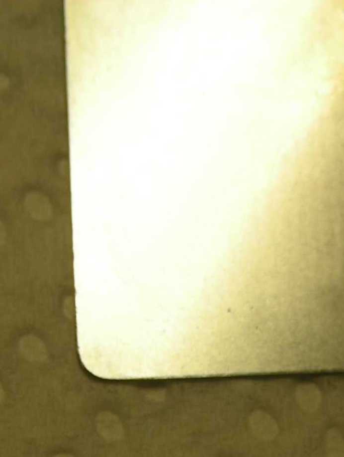

    The bit with the holes is no use for what we are going to do. Use tin snips to remove it. You now have a rectangle with some very sharp corners.
    You MUST round off those corners.
    Even the two pre-existing ones. And the edges MUST also be bluntened around those corners.You can use a Swissicon file, but if you make a habit of this kind of work, you will one day get one of these:

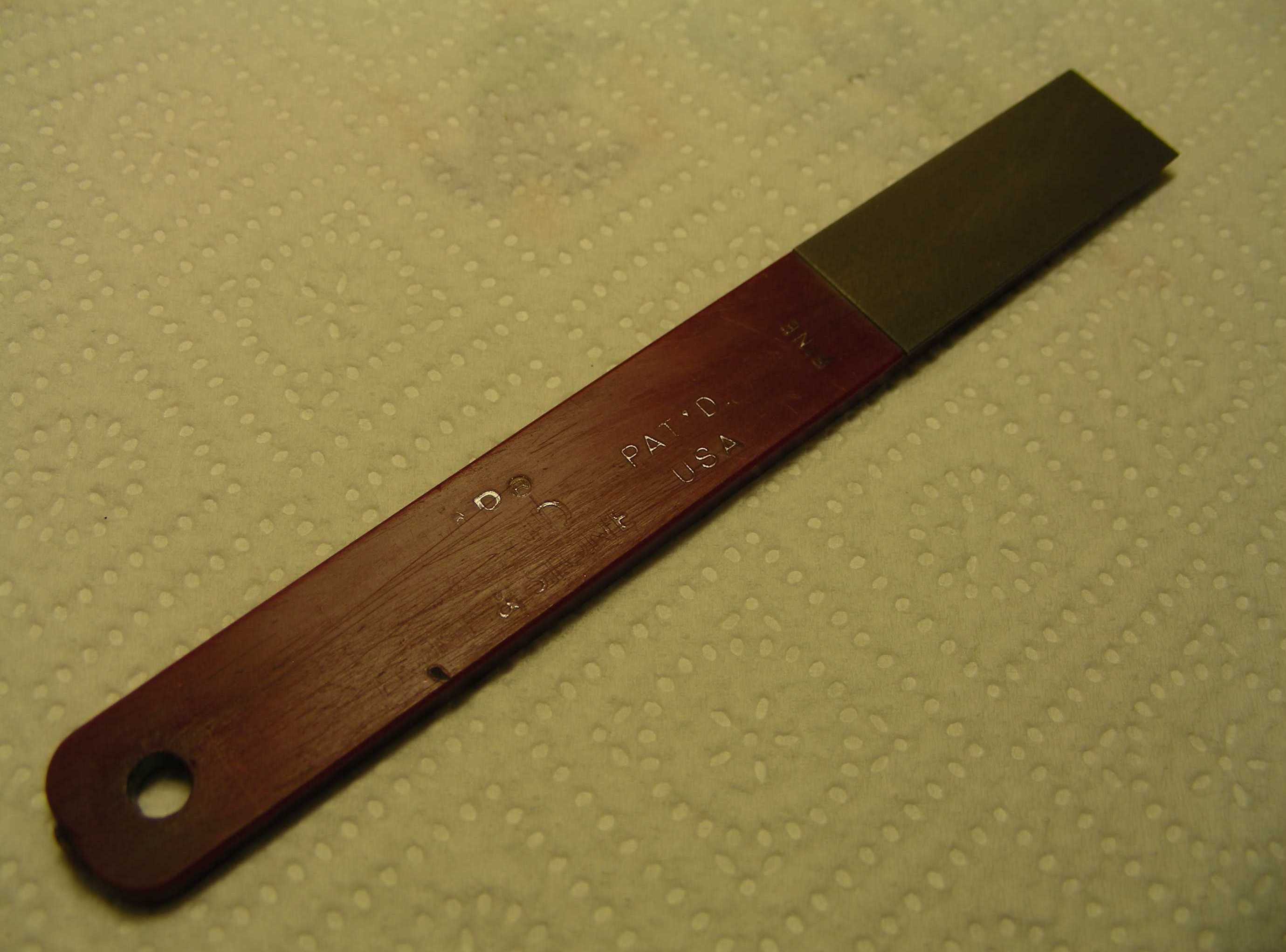

    An Eazi-Lap - they are wonderful for very fine resurfacing and edge correction on lock parts etc.
    What you now have is a home-made one of these:
    Even if you use a commercial paint scraper you will also have to round off the corners (as I did to this one). If you do not, it is very easy (and I have done it) to gouge a line in the woodwork that is too deep to be removed by gentle methods.
    So why not just buy commercial scrapers and round the corners off? Am I such a penny-pincher?
    - Hmmm, could be, but the real reason is that you now have a scraper that has just the right amount of flexiblity for cleaning up gunstocks. And I have not yet found a commercial scraper that is so thin and flexible.
    On as-good-as-flat surfaces you can apply just a bit of curvature by flexing it in your fingers so that it follows any slight dips in the wood. On curved surfaces you can pre-bend it for a rought fit, and tune that with finger pressure.

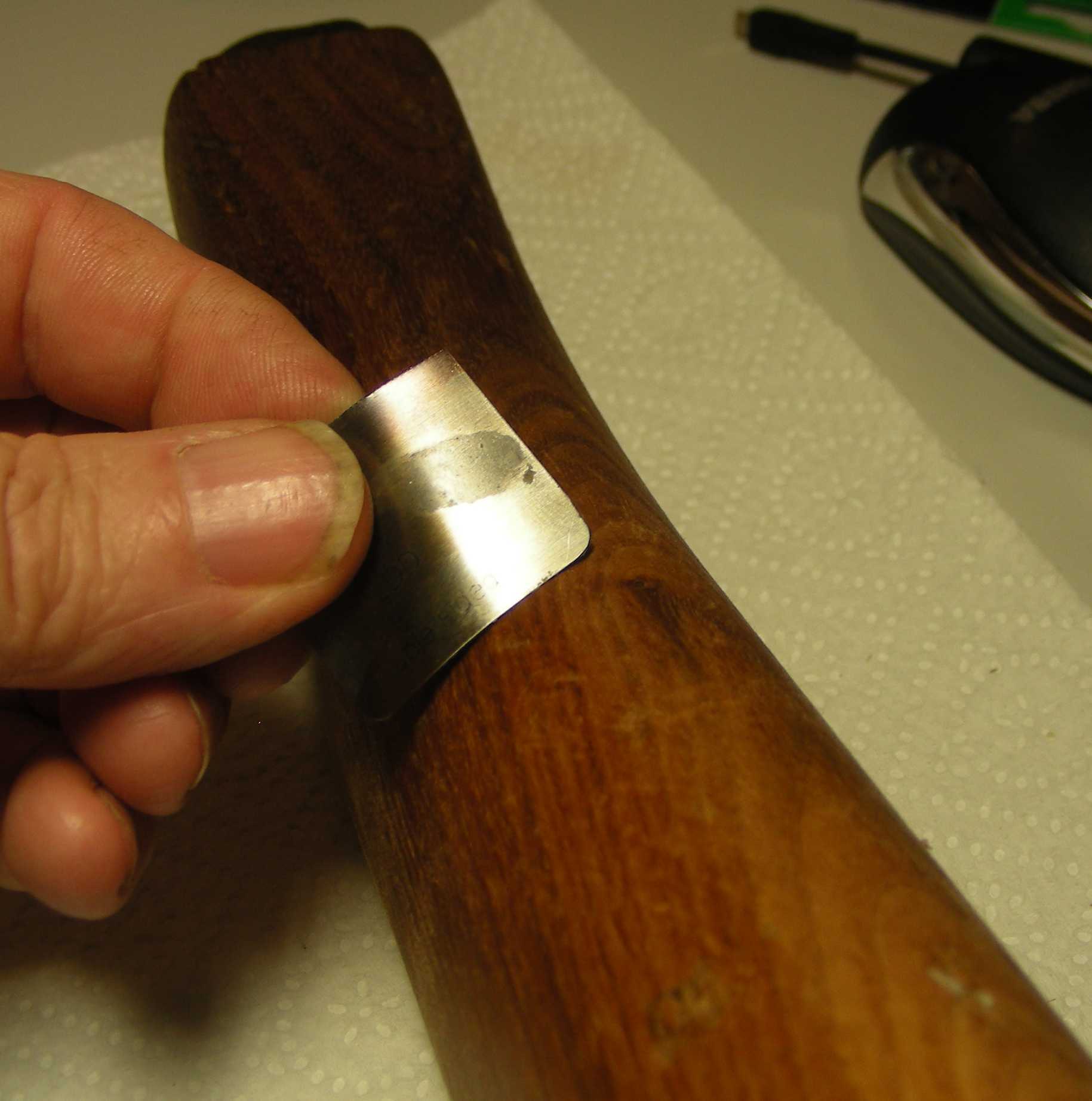

    Just one further point - we are not actually going to scrape the wood.
    We are going to burnish it!

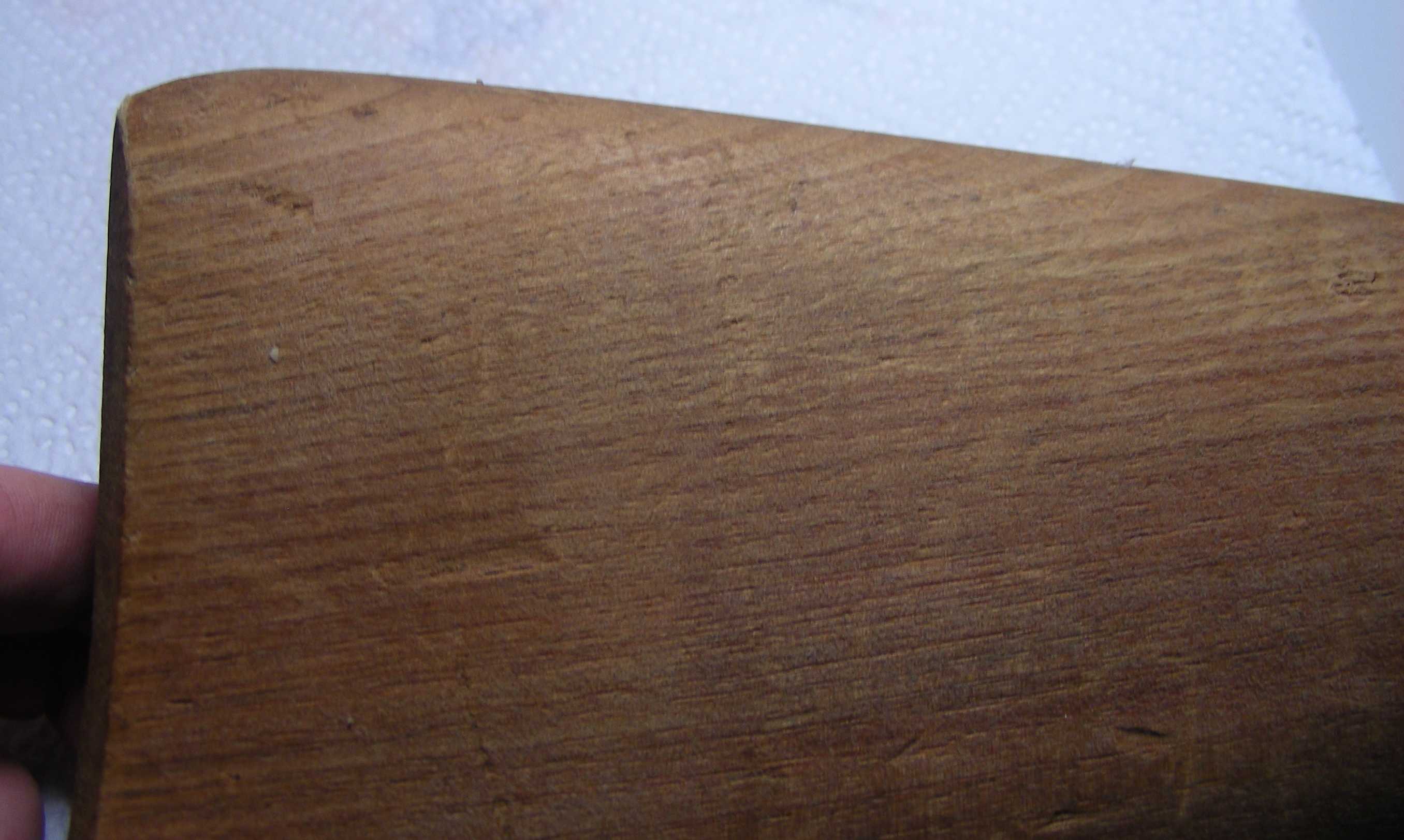

    Wood burnishing
    I discovered this method while using one of these things to scrape a wood surface. Please forgive me if I repeat myself, but for this kind of work you do NOT need sandpaper. Scrapers are used by cabinet makers to give hardwood surfaces a highly smooth, close finish before applying shellac etc. If you hold the scraper nearly at right angles to the wood and pull it sideways, but ALWAYS along the grain, it will scrape off a microscopic amount. While bending the scraper between my fingers - to follow the curve of a butt, I realised that I was still getting a smoothing action, although the scraper was not cutting at all. The scraper could be dragged along the grain and smooth down the wood without cutting it.

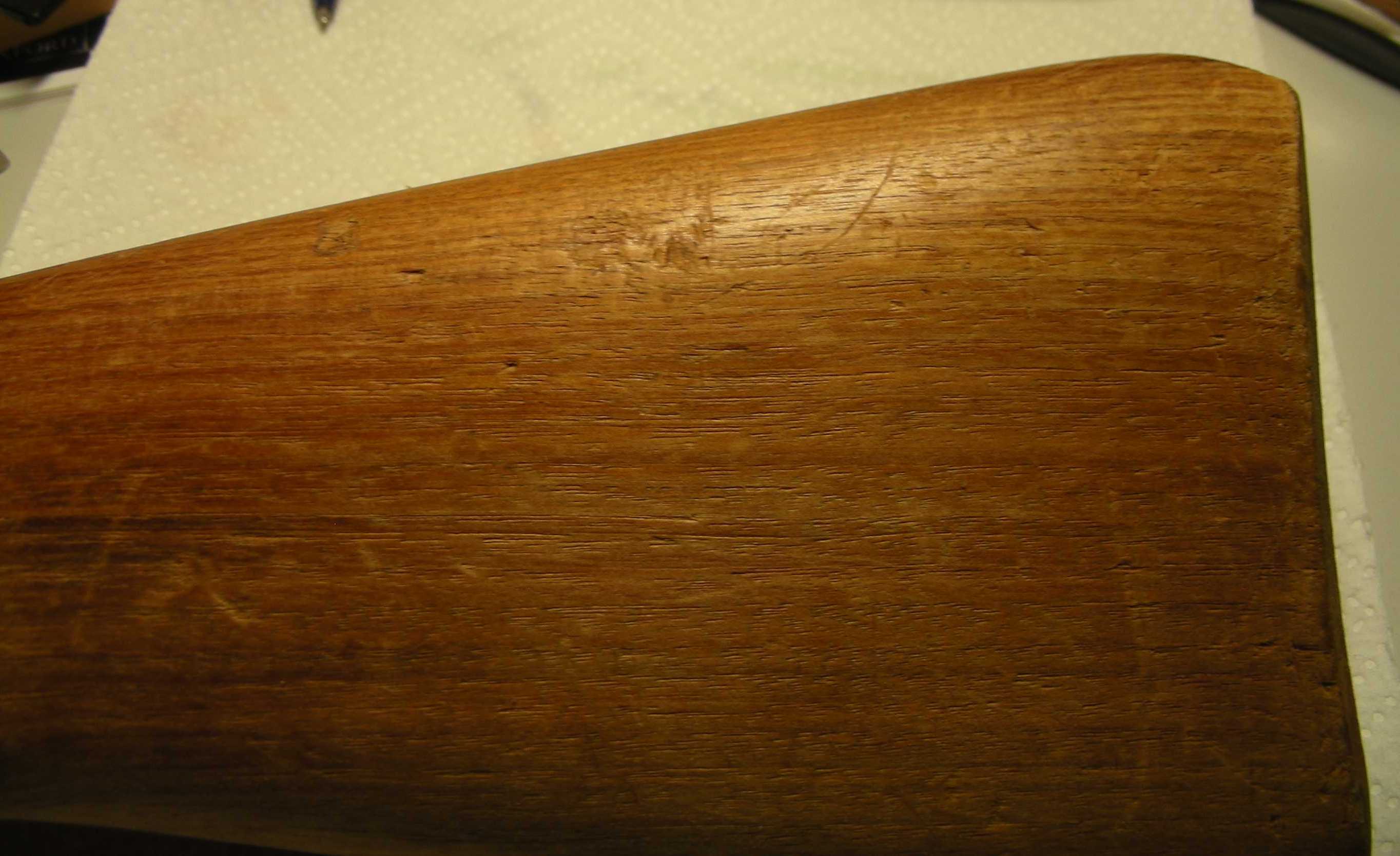

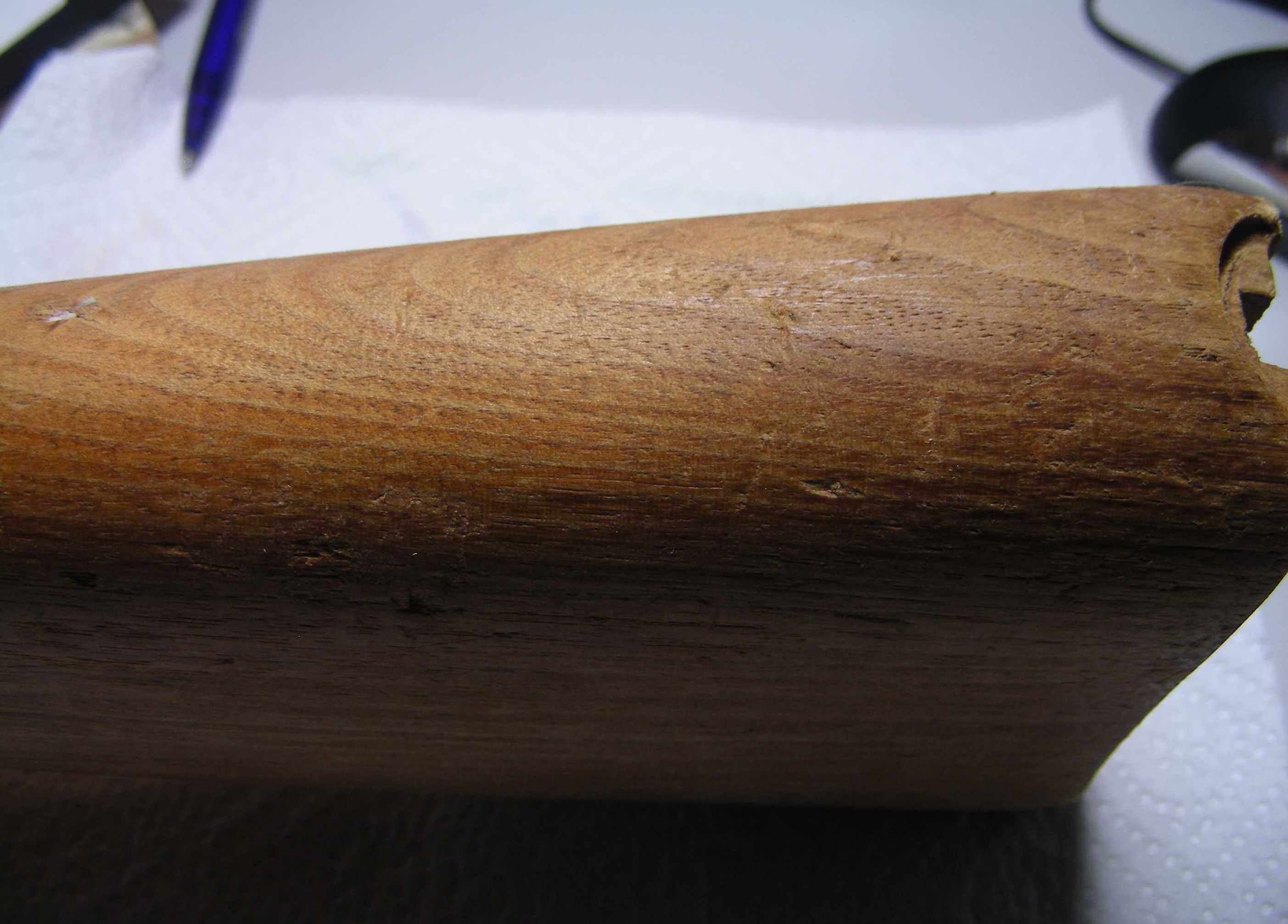

    As an illustration, here is an old Enfield butt (not part of a complete rifle) that was badly stained. So badly, that I actually had to use aqueous chemicals (hydrogen peroxide and oxalic acid) to bleach it out. But, nevetherless, I washed it - I did NOT soak it. Patted it dry and left it for two days. And then I applied a light coat of BLOicon (for beginners: boiled linseed oil and left if for weeks. Until yesterday in fact, when I got it out to make this demonstration.
    Look at the raw side. Most people would be tempted to use sandpaper on this.
    Look at the burnished side.
    I have done nothing more than draw the home-made flexible burnisher (now no longer a scraper) along the grain, from the toe of the butt to the wrist (to go with the diagonal cut across the grain on the top of the butt). The portion from the butt socket is done in the other direction from the front backto the wrist. Always pick the direction so as not to go against the grain and the cut of the surface. Think of a bird preening its feathers!
    You can see how the burnished portion has not only been smoothed out, but appears darker, because light is no longer being scattered by a "hairy" surface.
    That is how I got the surface on The Mahdi, and that is how you should treat your stock. No tricks, just BLOicon, burnishers from 3.5" diskettes, and slow, careful work.

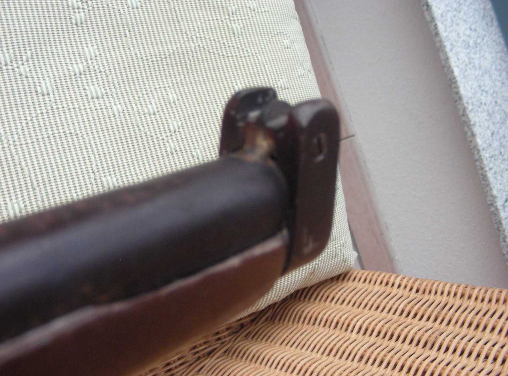

    BTW. Notice that Bubba had hard-soldered the foresight block onto the barrel sleeve. Crudely and crooked. Yeuch! It took me a long time to fix that.

    Hi guys,
    I'm stripping the stock today and just stopped by to print and re-read part 5.
    Patrick you were correct about the stains not being completely removed by stripper alone. I'll probably need to finish with acetone but wanted to re-read the instructions first. I'll post pictures later tonight.
    Sorry about your late nights typing instructions, I'll do my best to make your work worth the effort.
    Joel.

    Dear J, I read your description and it checks out as far as I can see, but I did not go to the final lock up because my Arisakaicon is a T38 and I have no intention of removing the system just for that.
