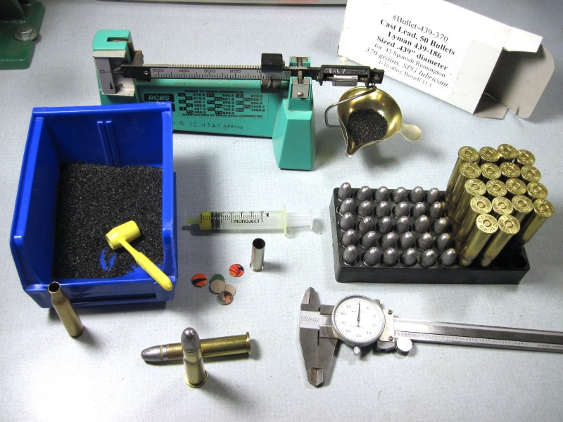

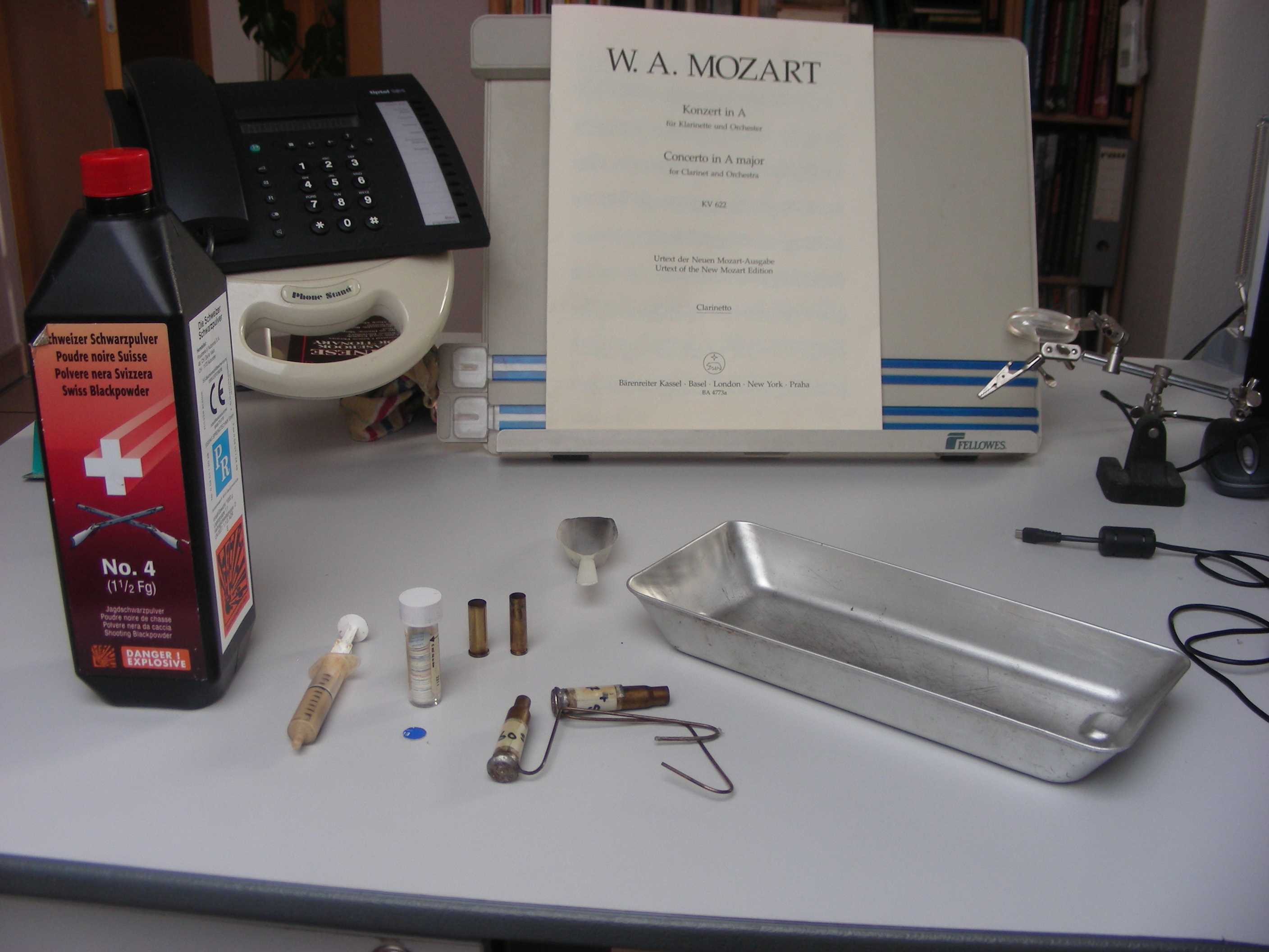

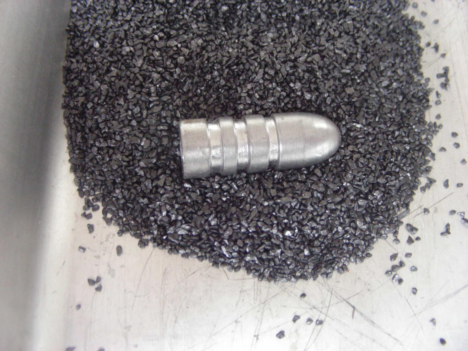

    First of all, here is a view of the equipment being used for the “desktop” part of this activity (i.e. not including the reloading press and dies). I am using an un-lubricated bullet for this, for illustration purposes.
    The powder is Swissicon No. 4 (1.5fg). No. 3 (2fg) would also be OK, but No. 2 (3fg) is a bit too fast for the long barrel of a military Rolling Block. It may produce too much pressure too early, thus unnecessarily straining the action.
    The grains look remarkably like model coal as used on HO model railroads. This is because they are indeed given a final coat of graphite during manufacture, to prevent electrostatic charge building up on the powder - a precaution that has been taken by powder manufacturers since way back in the 19th century.

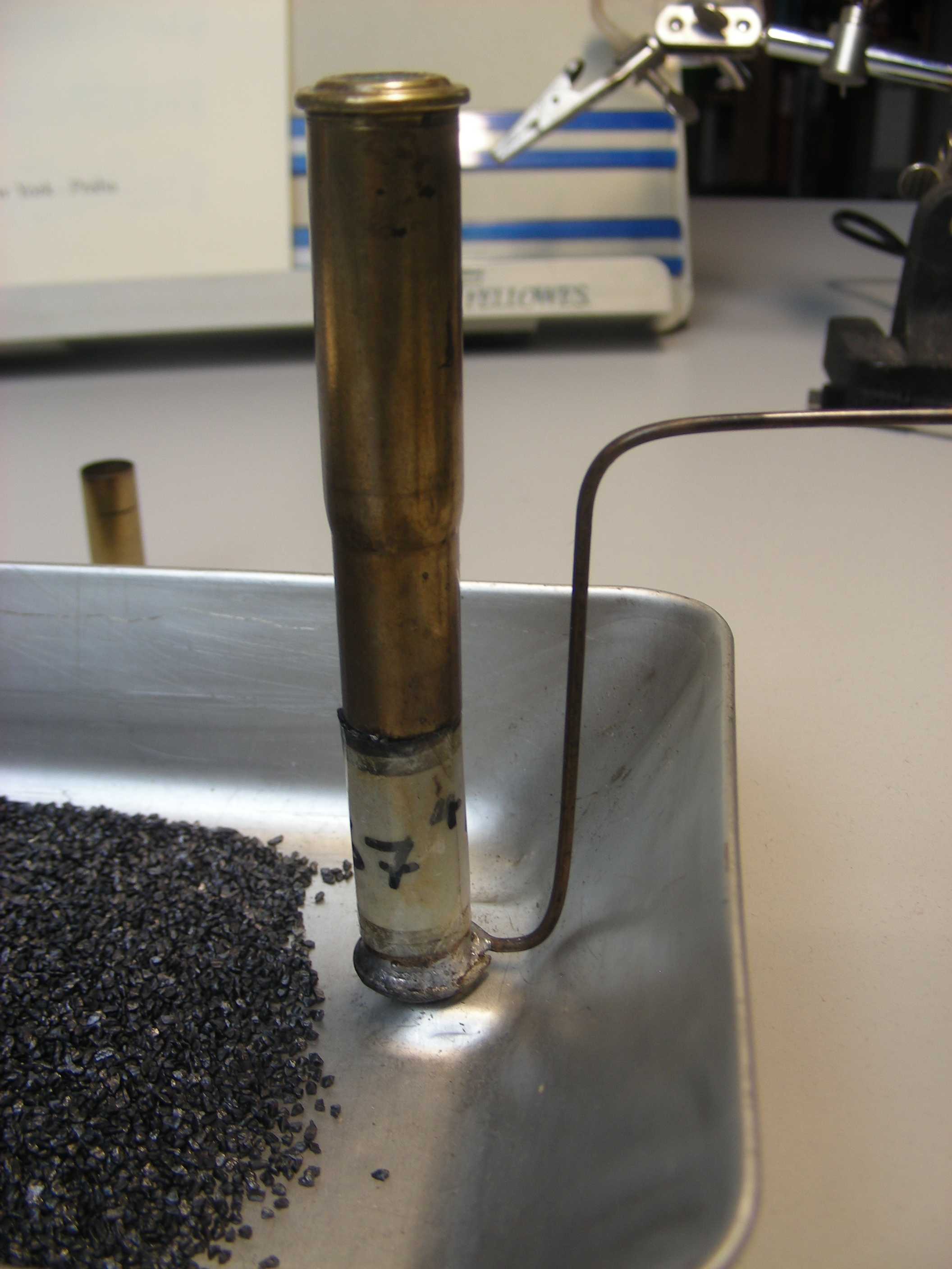

    How are we going to the get right quantity of powder into the case?
    Well, you can buy a commercial powder dispenser, but they perform poorly with such large grains. You can, with a bit of practice, get loads with a spread of 0.4 grains by using the following simple devices from the “pack-rat” school of engineering.

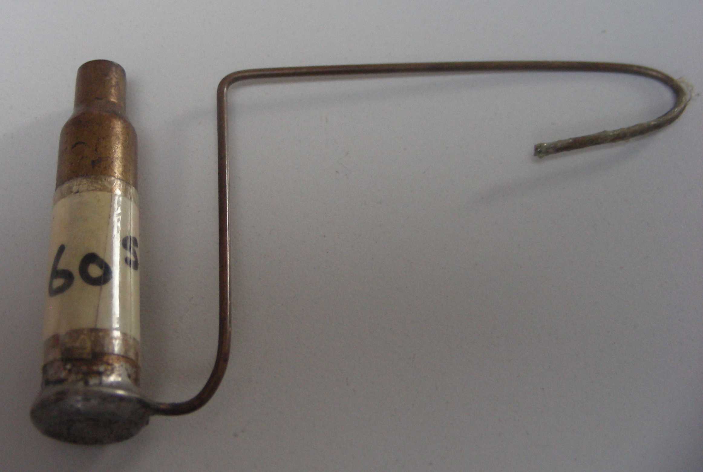

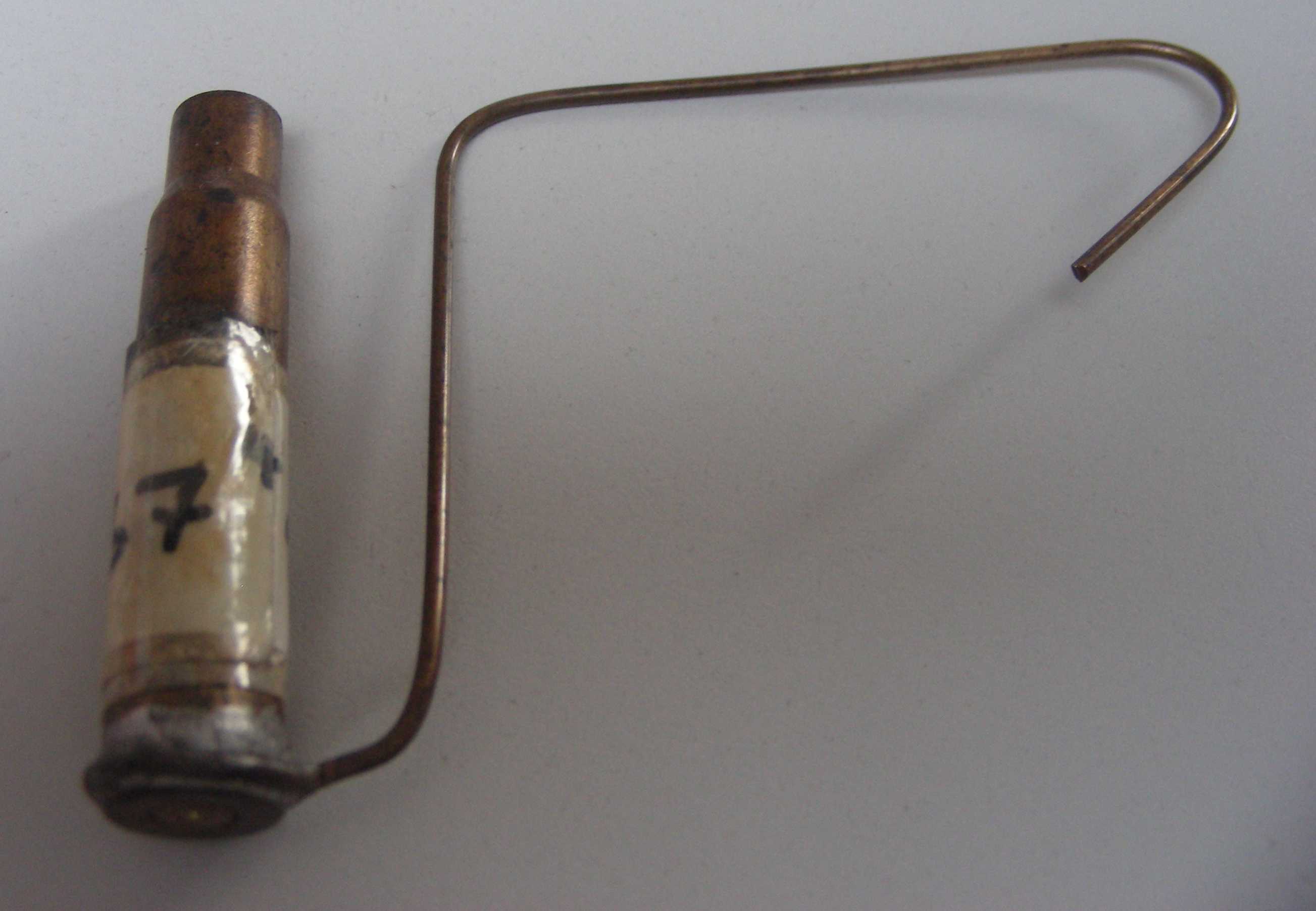

    This is a measure for 60.5 grains of Swiss No. 2.
    And this is a measure for 67.4 grains of No. 2.
    These powder measures are actually made from old cases, with a brass wire soldered on as a handle. The 60.5 measure is a 6.5x55 Swedishicon Mauser case, and the 67.4 measure is an 8x57IS case. So a few minutes pack-ratting at the range will provide you with a wide spectrum of potential powder measures!
    The powder weights were established as averages, after I had had some reloading practice. The weight values for other powders will, of course, be a little different, but that is unimportant. Standard practice for black powder is to load a constant volume of powder, not weight, so that the cases are filled to a constant level. A BPCR case should not have any air space when it is complete. OK, before someone points out that there is air between the grains, I should put that a bit more precisely and say that you should not hear the powder rustling around in the case if you shake the completed cartridge.

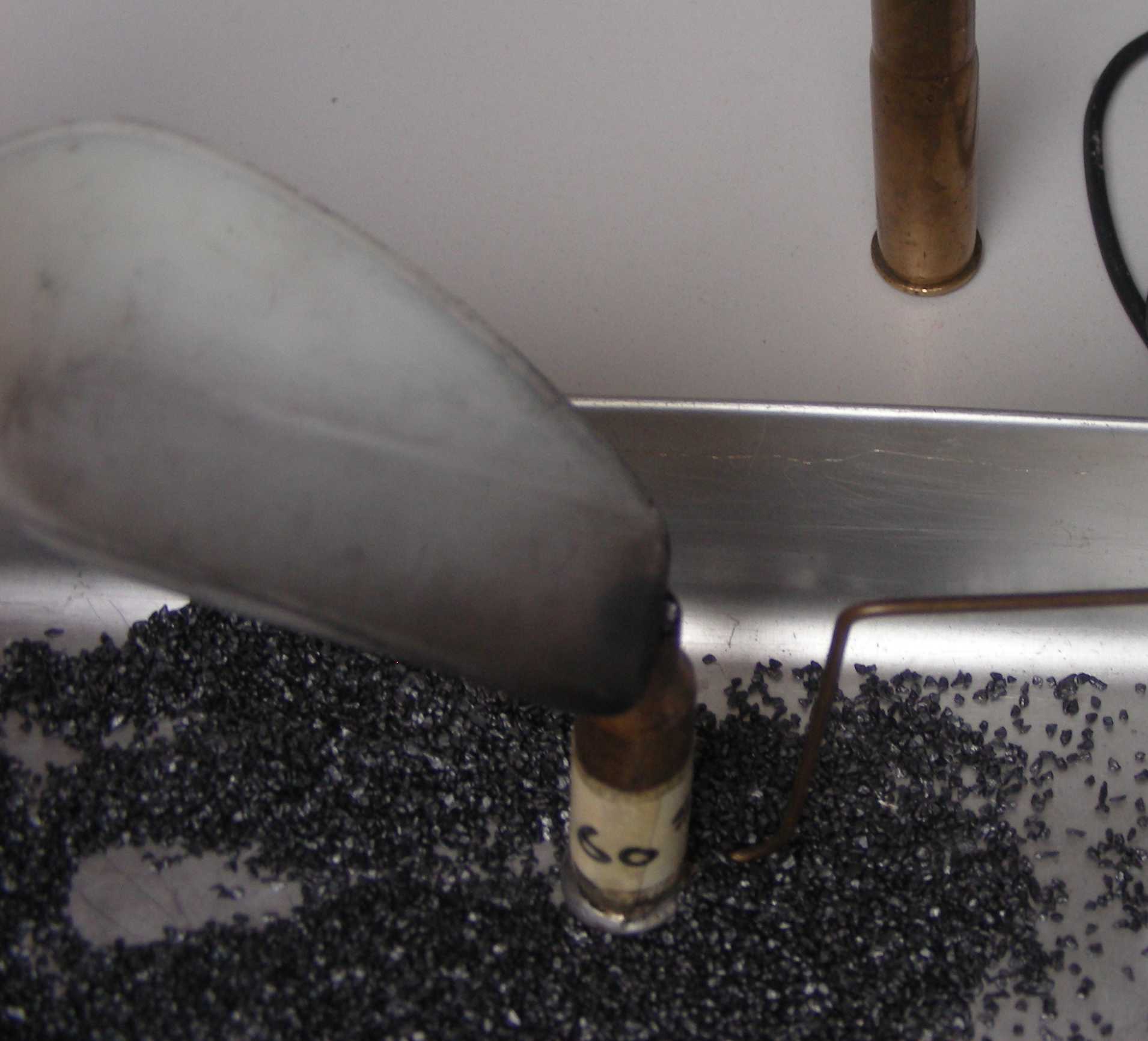

    Of course, the powder will settle after some time, especially if the cases are vibrated (like in the back of the car when you drive to the range). There are various schools of thought on this matter. Some say use a drop tube. Some say compress the powder 1/8” in the case. Some say 1/16”. But we are at the KISS stage of reloading at the moment - you can try out the other methods later, when you know that the rifle is worth keeping as a shooter - I am pretty confident it will be!

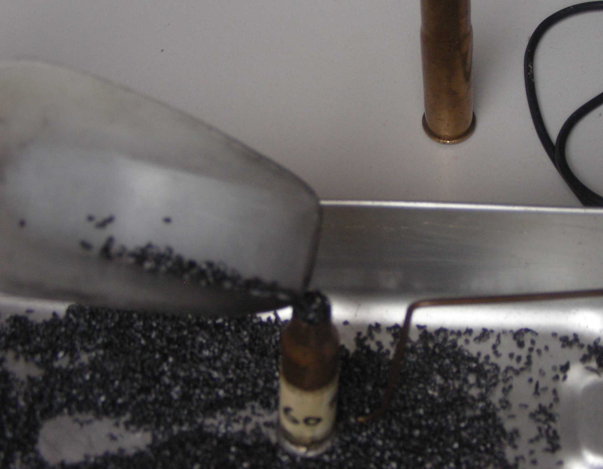

    To get a fairly constant weight in the case, the power must be poured in a consistent manner.
    The powder shovel [I have no idea where it came from] is loaded as shown in the next picture.
    The shovel is placed over the case mouth, the shovel it tilted until the powder start to flow, and the entire shovel-full is poured in, so that the powder overflows.
    I had to hold the camera to take these pics - normally the measure is held upright, not free-standing!
    The excess powder is stroked off the top of the case.
    With practice (always a similar amount in the shovel, always holding the shovel at a similar angle) you will have loads that are quite consistent.
    Now to get the powder into the case. This is where “Patrick’s Patent Powder Measures” really score.
    Simply invert the case over the powder measure
    Reverse the whole assembly, and the powder falls into the case without spilling a single grain. Tap the case on the bench a couple of times to make sure that nothing is left in the measure and that the powder is well-settled in the case. It is a good idea to do this in a tray, to keep every grain off the bench, as a couple of grains may have stuck to the outside of the measure, and these will be shaken off when you tap the case.

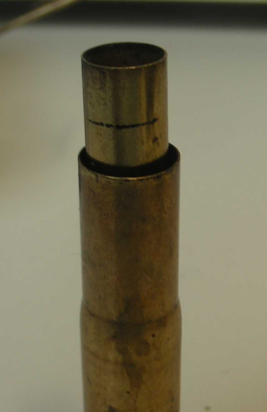

    Is there enough powder in the case?

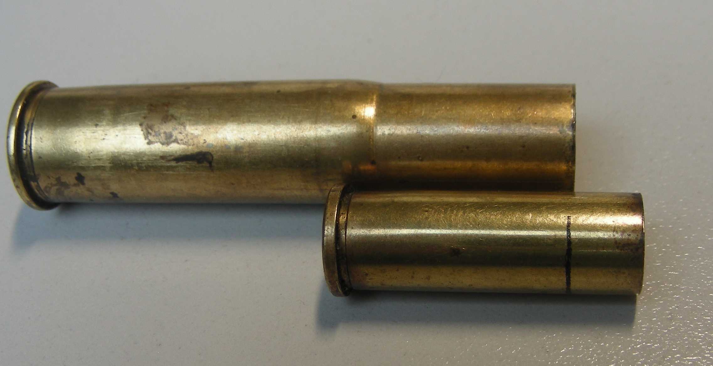

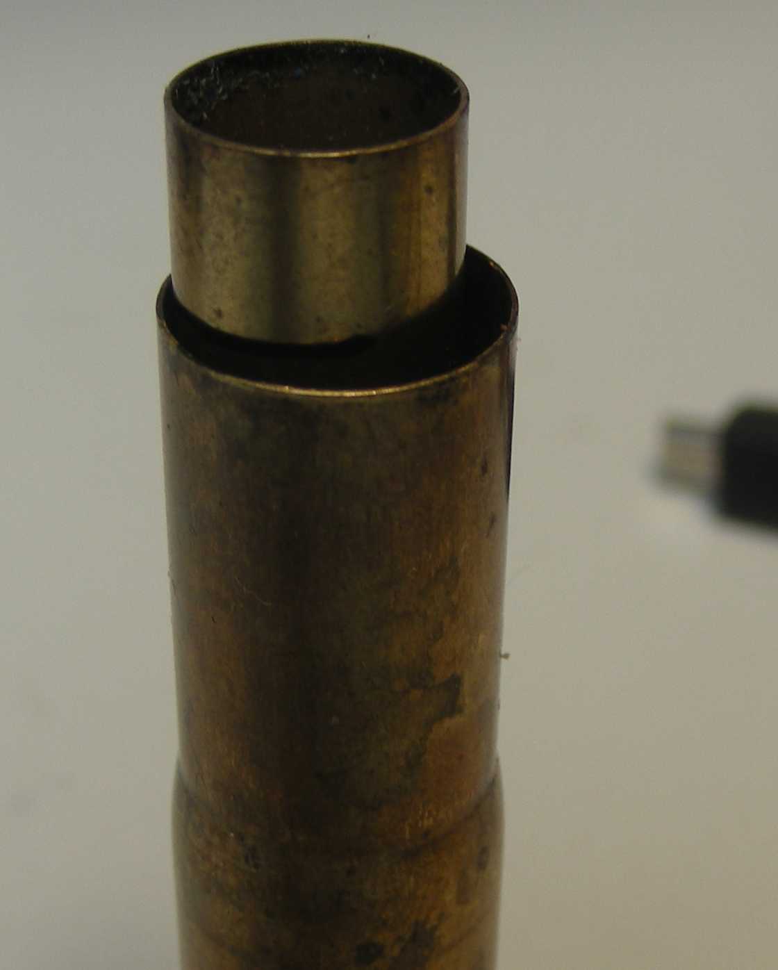

    To check this, put the 30M1 (or .357 or .38 special) case into the BP case so that it sits on the powder. Use a marker pen to mark the height of the BP case mouth on the 30MI case.
    Now place the marked 30M1 case next to an empty BP case, to see how deep the top of the powder charge is.
    That is not enough. The powder must come up above the shoulder, otherwise the card wad will become loose when it is pushed down. A load like this would require the use of a suitable non-rigid filler (semolina, dacron - there are various possible materials).

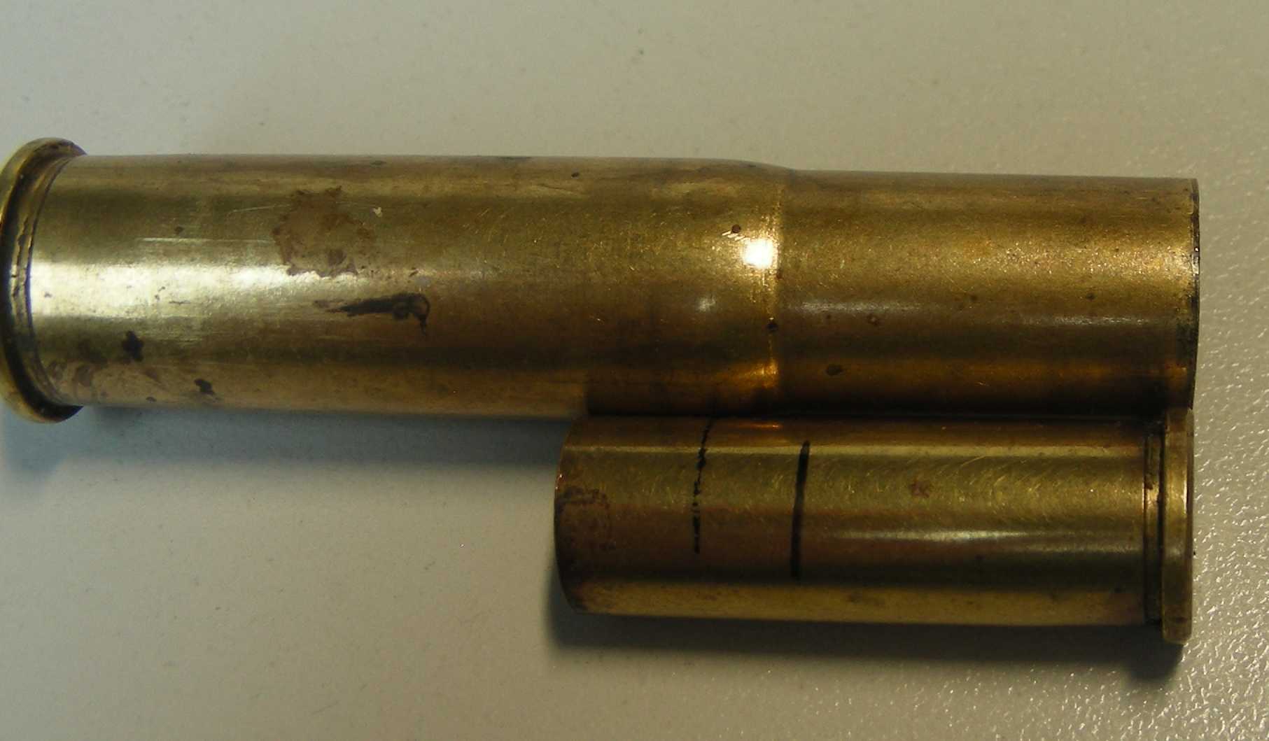

    So we do it again, this time with the 67.4gn measure. Once more, mark the level on the 30M1 case.
    And once more, check this with the empty case.
    This is sufficient. And is in fact precisely what I use for my (nearly) match-winning load. When you are tuning the load for optimum performance, you can get any load you need by using different measures, or by filing down the mouth of an existing measure. As an experienced pack-rat, you will have collected several cases!

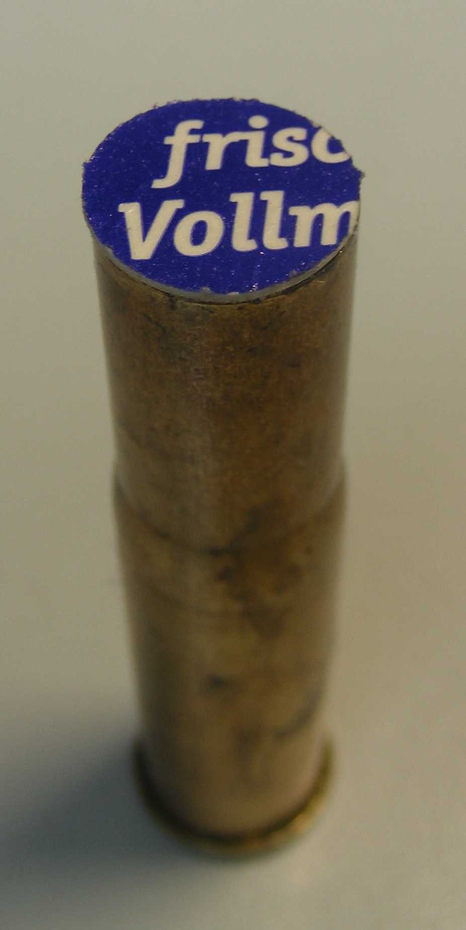

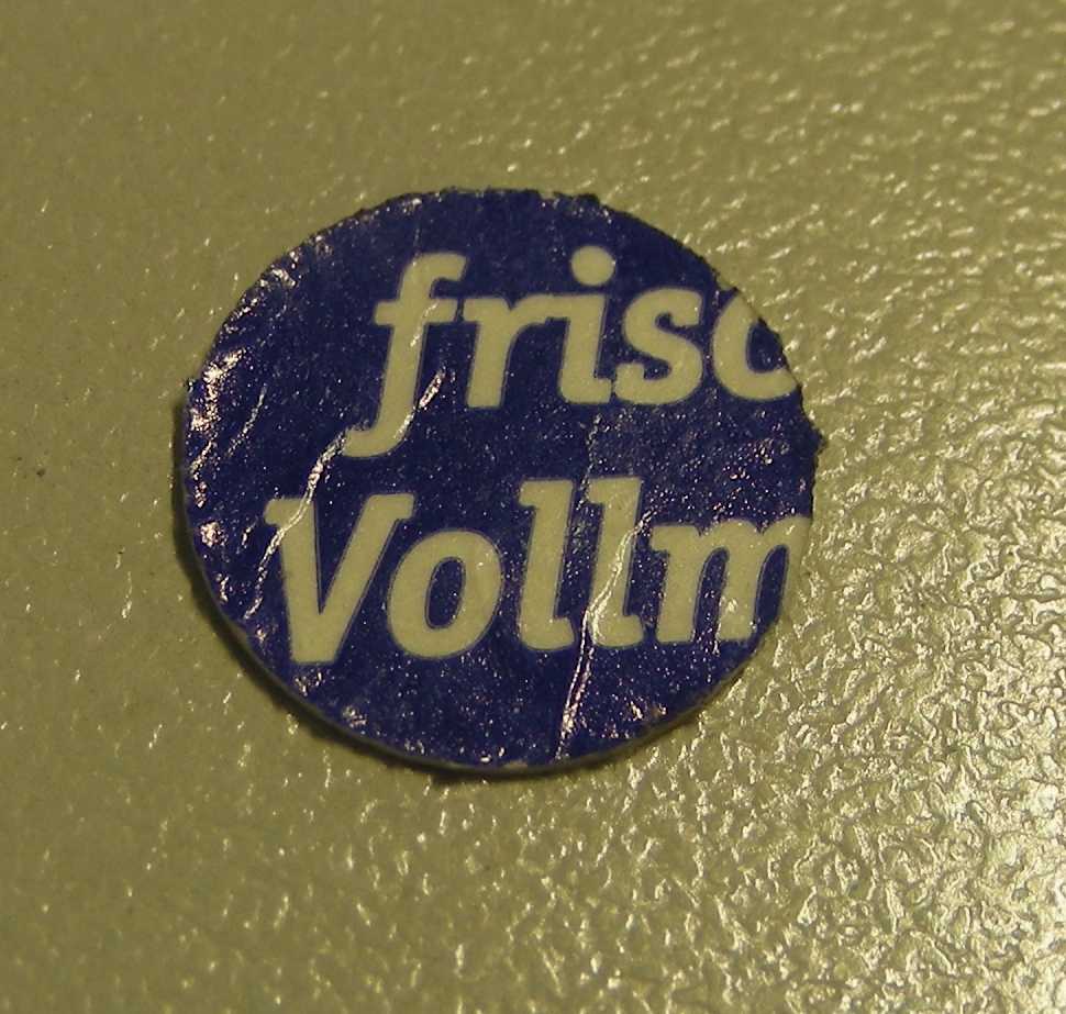

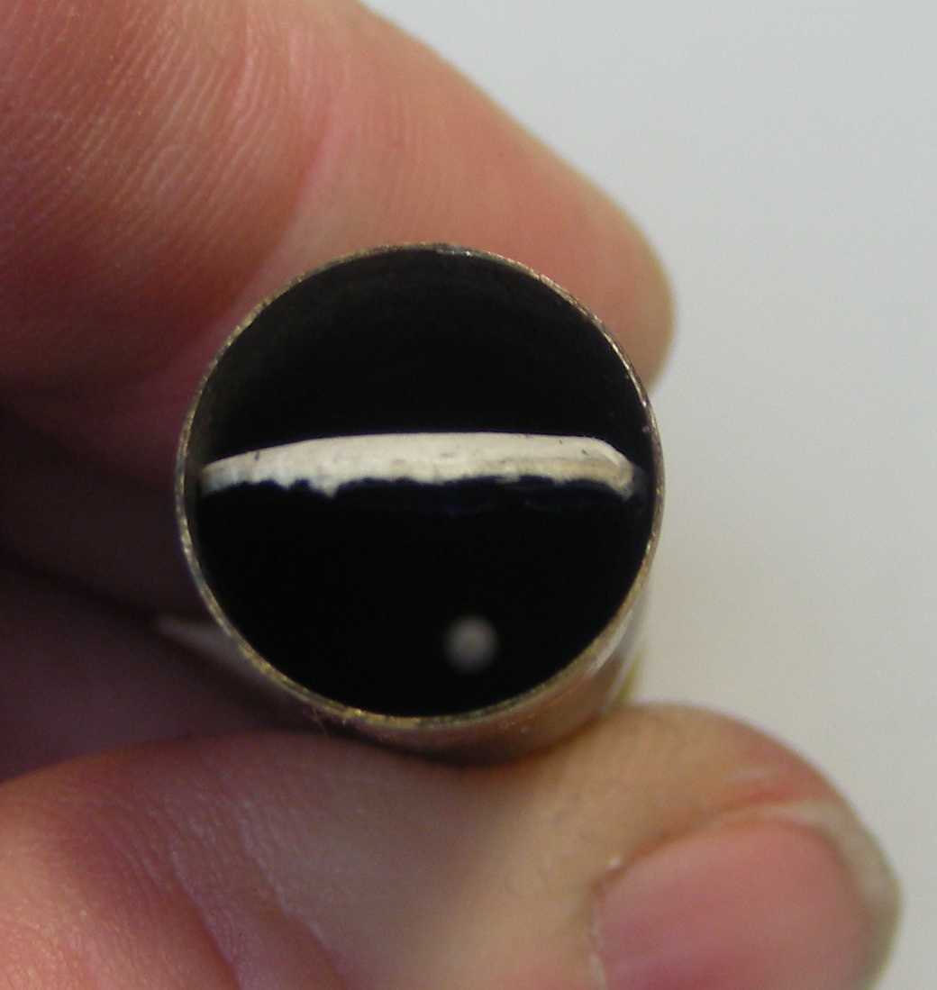

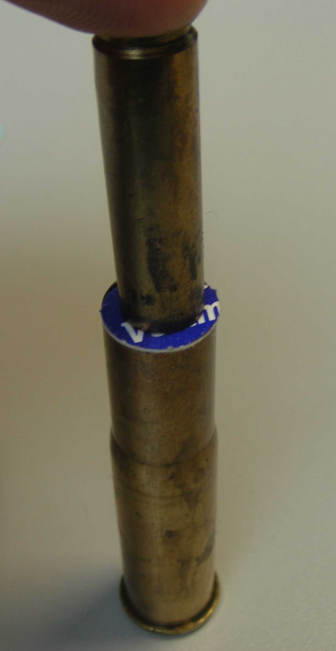

    Now it is necessary to ensure clean separation between the powder and any filler or, in this case, the grease cookie. Take a card wad - as you can see, it was punched out of an old (washed out!) milk carton.
    Since the wad was punched from the other (white) side, it is slightly rounded on that side, and the side you can see here has the sharper edge. The wad will be easier to push into the case if you preserve this orientation.
    Place the wad over the case mouth
    (some more one-handed pictures coming now!).
    Now place the mouth of the 30M1 case over the center of the wad,
    ... and press the wad gently into the case mouth. The wad may become slightly skewed. Just press a bit more on the side that is higher in the neck, and it will straighten out as it goes down. You might like to practice on an empty case a couple of times, before trying a case with powder in it. If you pull out the wad from the case, you will see that it is slightly dished. That is what keeps it tight!
    Push the wad down until you feel it sit on the powder.
    Repeat with a second wad.

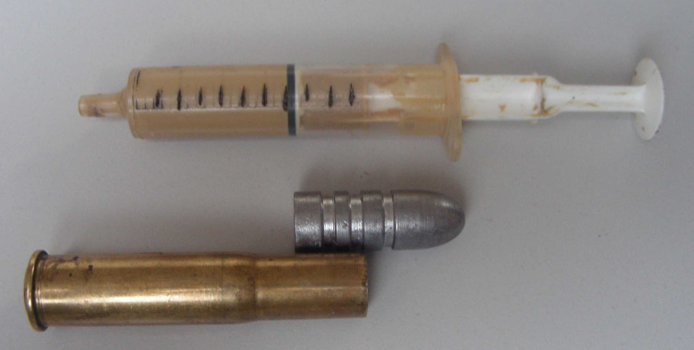

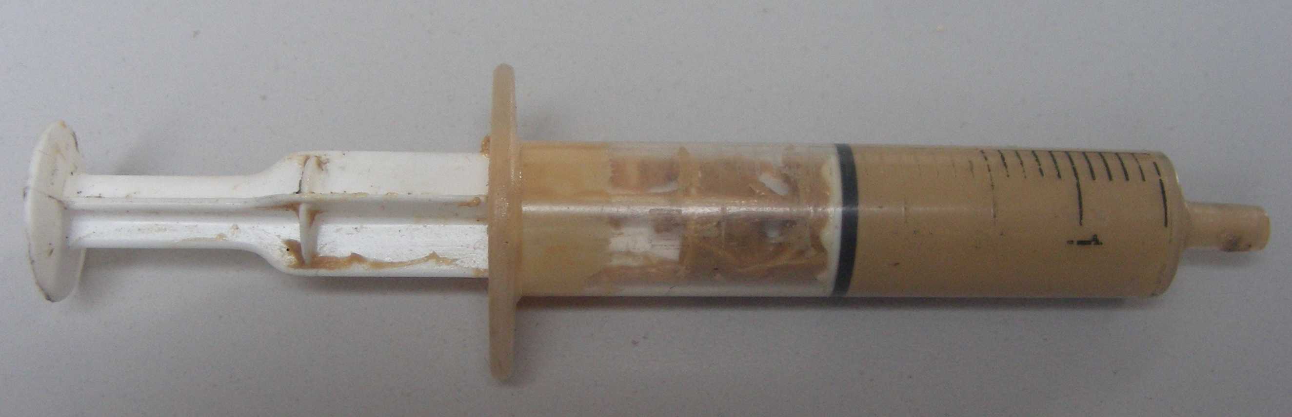

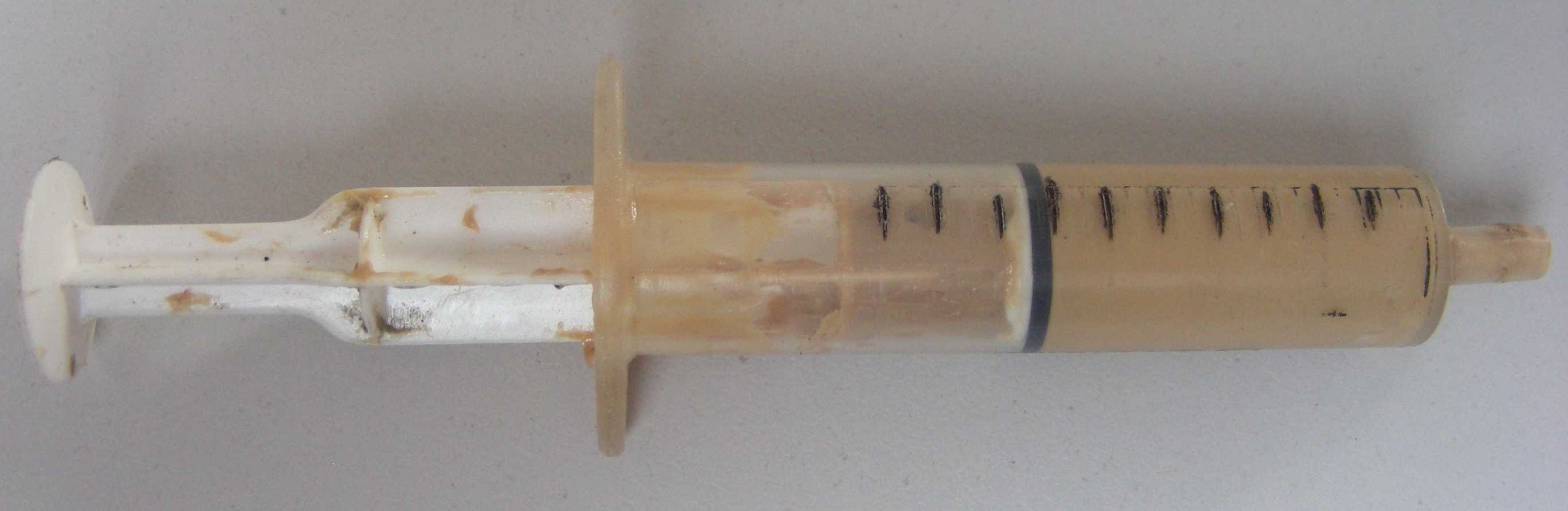

    The next stage is to insert the grease cookie. I call it cookie because many people like to do it this way: take a suitable tray-like object (a suitably deep lid off a glass jar could do) and fill it to the brim with the lube of your choice (I see you have some ready). Simply place the case mouth down on the lube tray, push down, twist and lift, and you have a defined amount of lube in the case mouth. You are using the case mouth like a cookie-cutter, hence the name grease cookie. At least that is the theory. It only works cleanly if the lube has a wax-like consistency. The lube I prefer is too soft for this method. And this is where the 5ml syringes come in...
    These syringes are marked in 0.2ml steps.
    As you can see, the original markings are gradually dissolved by the lubricant. I discovered by experiment that 0.4ml was not quite enough lube to get through a match target without fouling problems, and increased it to 0.5. The syringe has accordingly been remarked in 0.5ml steps.
    And if you look at the next picture, you can see that this amount of lube fits neatly in between the bullet and the card wads over the powder.

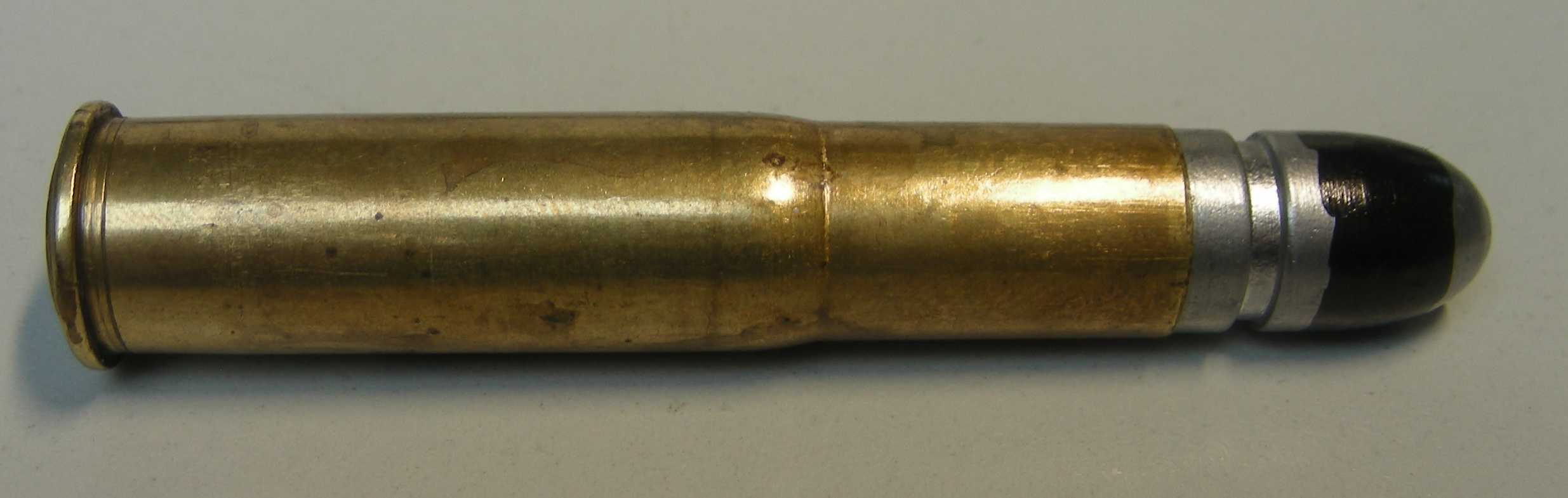

    Now squeeze a dose of lube into the neck of the cartridge, seat a properly lubricated bullet to the right depth, and you are done. I don't think it is necessary for me to tell you how to use a loading press, so I am pretty nearly done too!

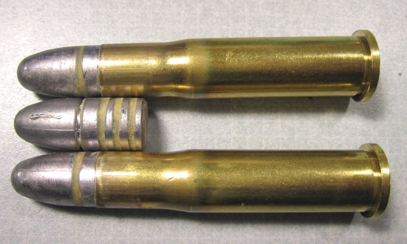

    One last point. Observant readers will note that I have made no mention of a card wad between the bullet and the grease cookie.
    - Firstly, the bullets are anyway lubricated in their grease grooves. So the bullet is not grease free to start off with.
    - Secondly, although some are worried about blobs of grease sticking to the base and throwing the bullet off course, I am not convinced that a wad sticking to the base is any better. It is going to peel off to one side or the other. Another small but unpredictable factor. And the soft lube I use has no chance of clinging to the base of a bullet doing about 350 meters/sec when it exits the muzzle. But I have seen wads more than 10 yards downrange.
    - Thirdly, you can find on the Pedersoli website a recommendation that you shoot the Gibbs percussion target rifle without a wad between powder and bullet base. And the Gibbs is quite simply the best you can get. Again, some worry about grains of unburnt powder sticking to the base, but is a sticking wad any improvement?
    - Fourthly, I have tried with and without such a wad, and not observed any difference.
    - And finally, true to the good old engineering principle “if you don't build it in, it can't go wrong” - an old-fashioned way of saying KISS - why add something of doubtful utility that takes up more time and space?.
    Mechanically, you basically have the length of the neck to play with when adjusting seating depth, powder volume and lube quantity. If you have followed this method carefully, you may not have the absolute best possible load for your rifle, but you will have a PDG first approximation.
