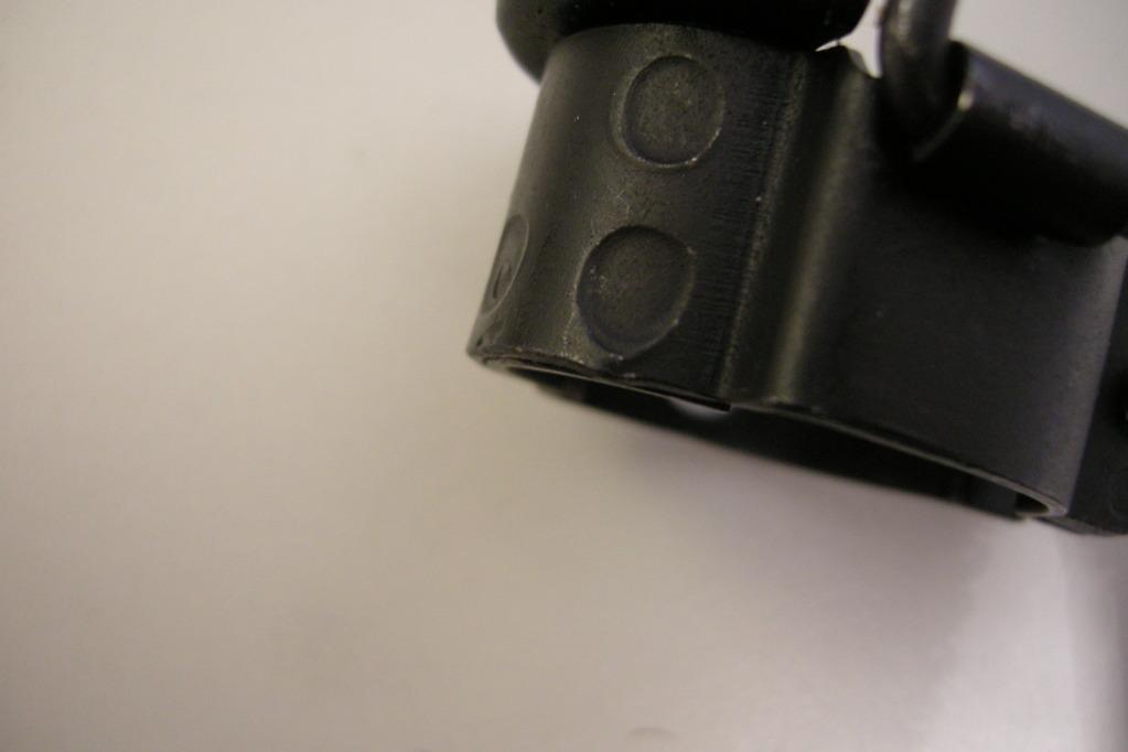

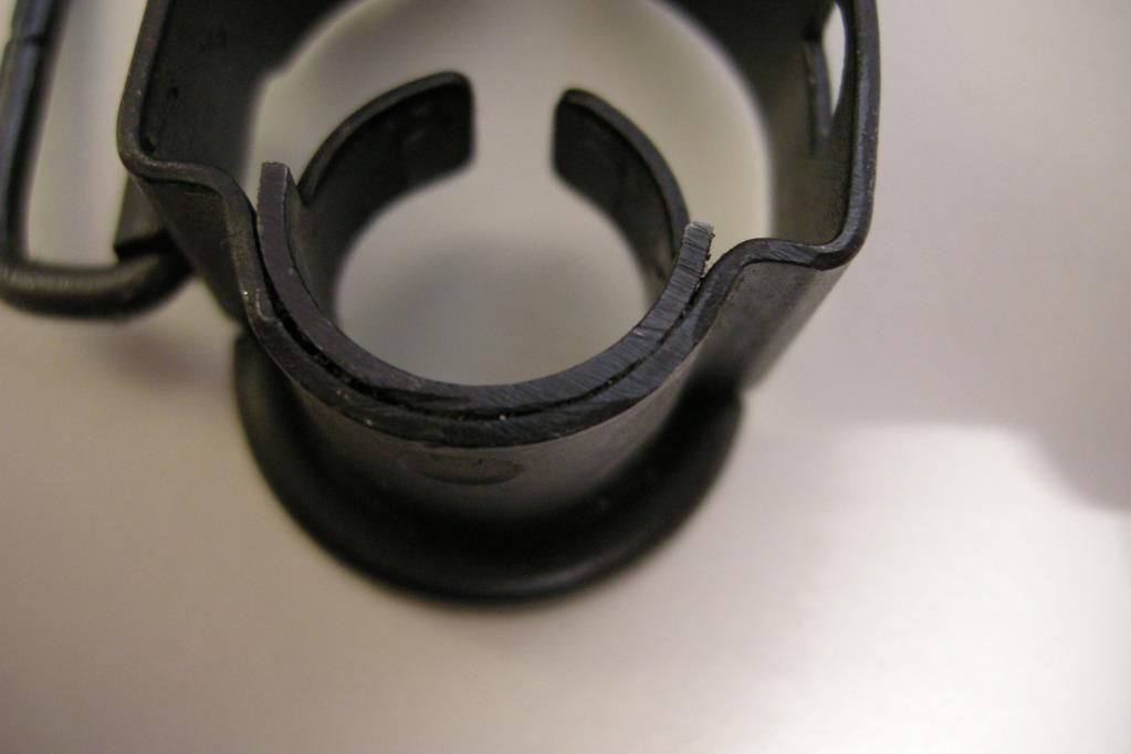

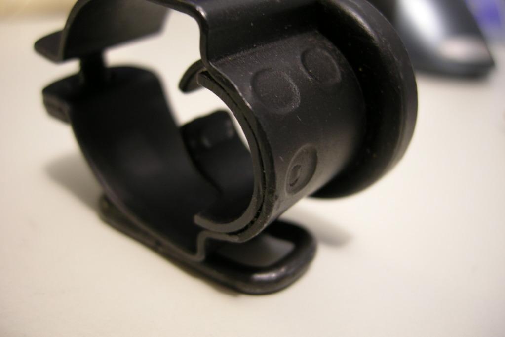

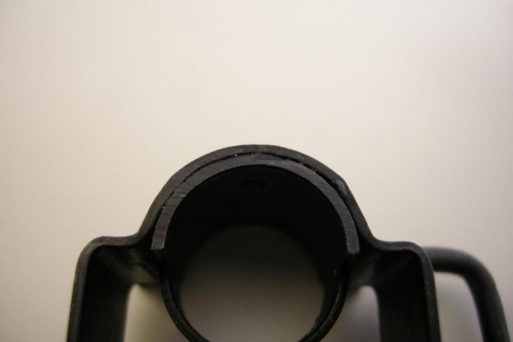

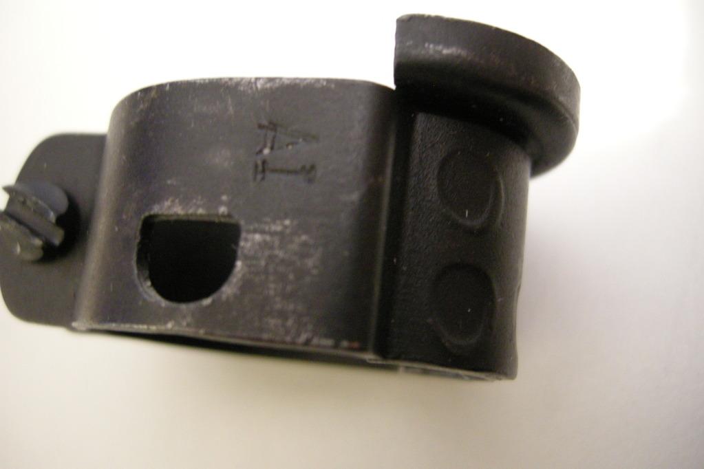

    Bhere I bought some piece hard to find here in Italyicon, and my dad bought this front barrel. Light in AMS was not so bright so trusting my eyes and the vendor he bought a type 2 AI barrel band. Home my dad discovered some signs (cutting or machining?) on the bb, so I ask you, what do you think?

    It looks to be a cut type III

    Another double struck AI - must be fairly common, at least on Type III's. - Bob

    Matteo M.
    In the last picture, you can see on the outter part where the saw got into it while cutting off the inside piece.

    Quote Originally Posted by Bubba-7 View Post
    yeah
