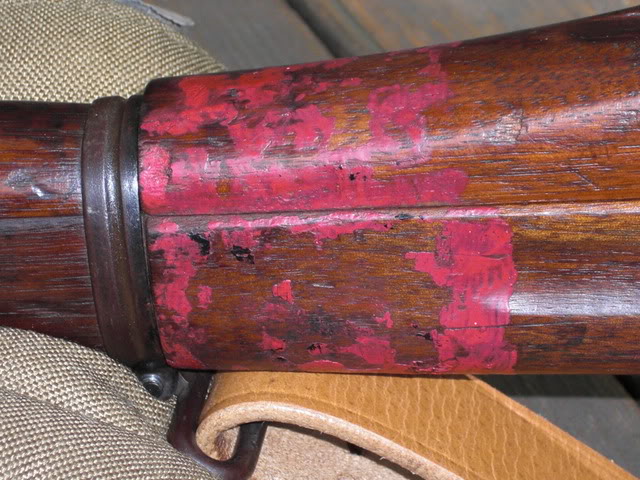

    Hello Nick, I'm a home guard memorabilia collector. This is just a possibility. The majority of U.S. rifles sent to the U.K. and adapted for home guard use were P-17 U.S. Enfields in 30-06. The red paint was required so the home guard volunteers wouldn't try to load .303 into 30-06 chambered weapons. Most just brushed it on with little effeort for a neat job. Several thousand Springfields were also sent. The red band painted at the handguard is a fair clue. Is there anything else painted on the stock? Rarely, some home guard units would also paint .30 cal or 30-06 or cal 30-06 on the butt stock - usually in white paint.
    *Just saw the pictures. I think the Britishicon crown marking is also a supporting clue. The 12/1941 date barrel throws me though. It's very late. Most of the U.S. goods showed up in 1941. Was it rebarreled in the U.K. later? I'm puzzled.
    Just checked - BNP under a crown is Birmingham nitro proof.

    LDVolunteer: No, the barrel is an original Rem barrel ("R.A."), w/ Rem proof dated 12/41.
    Here's a better pic of the paint on the left side of the handguard (opposite the bolt). It's very worn (not sanded) but you can still discern elements of black paint that once said either: "300" or "3006" - couldn't tell which it was on this one. The pics of still-intact caliber designations I've seen show it in black paint.
