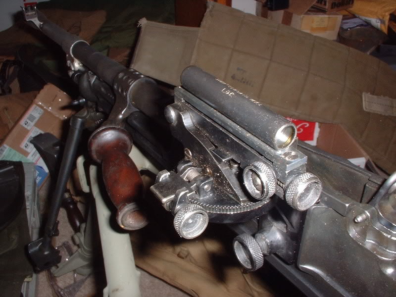

    Some of the early Mk1M guns still had the second dovetail. I have such a gun in my collection (dewat unfortunately). It would seem some of the mk1 features were still to be found during the changeover to Mk1(m).
    One could also remove the dial type sight as the dovetail was the same. This would not leave you an alternative if your scope (or indirect fire sight) got broken however.
    Edited to add that I see I spent too long looking for my photo and Kev beat me to the punch.

    THere were only ever two telescope mounts made for the Bren and both were destroyed early in the war during trials to formulate the bracketry for the No4T. So if you had one, it was definately a fake. The Bren version was a 'bracket' of sorts that screwed to another bracket that went into the rear dovetail. That's the answer Beerhunter, it went onto the rear dovetail. These pictures of it mounted onto the front dovetail are the wild imagination of the fairies. The eye relief would make it impossible to use!

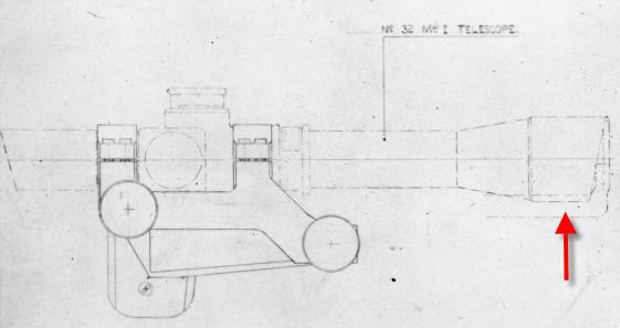

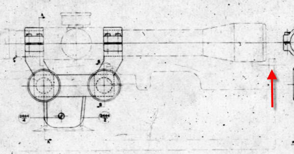

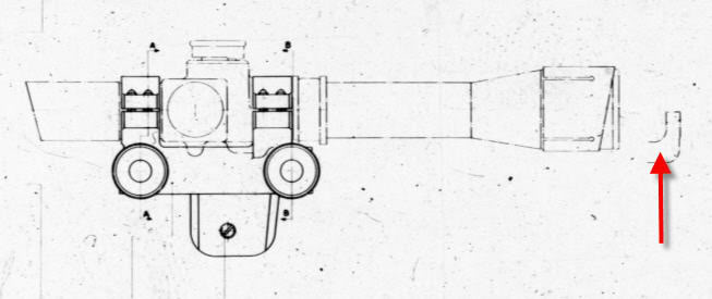

    The Bren version was a 'bracket' of sorts that screwed to another bracket that went into the rear dovetail. That's the answer Beerhunter, it went onto the rear dovetail. These pictures of it mounted onto the front dovetail are the wild imagination of the fairies. The eye relief would make it impossible to use.
    Peter all the drawing I have show it mounted on the front dovetail regardless of scope or mount type.
    These drawings DD(E)2444
    DD(E) SK No 316 and DD(E)2514 show the rear apperture sight in relation to the scope eye piece.Edited to say that the red arrow is indicating the drum sight arm.
    Was there a later drawing or ammendments ?
    ATB Kevin
