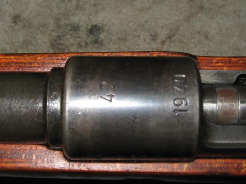

    I picked up a bubba'd 42 code, 1940 dated Mauser and have a few questions (to start anyhow!)
    Looks like every metal part is matching. The barrel serial number corresponds to the receiver serial number but also has the following:
    40Do463. This goes around the barrel and not across like the serial # does.
    Does anyone know what this code means?

    This is the "barrel band". This tells you the barrel was made in 1940. Do463 either made the barrel or provided the steel for the barrel. Not certain which, perhaps someone else will jump in.

    Here are some pics i got from the seller:
    How can i make them bigger?

    Your rifle is from 1940 so a laminate stock would be correct, the official order for laminate stocks was issued in 1937 although there are earlier examples. The waffenampts on the 42 code rifle changed in 1940 from "63" to "655". Some "no" letter rifles can be found with "63" proofs. A mixture of "63" and "655" proofs can be found on the same rifle until all of the "63" proof parts were used up. Flat buttplates were used until late 1940 when the cupped style was adopted to prevent the separation of the butt stock, also the sight hood was not used until late 1940. In 1941 the Mauser Oberdorf manufacturing code was changed form 42 to "BYF" and the reciever date was changed from a four-digit to a two-digit number. The 42 code 1940 rifle has a serial # range from 1660 to 5499gg. Luftwaffe marked 42 code rifles are reported but very rare. This one is mine, all matching except the bolt.
