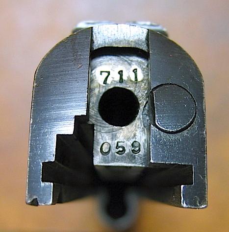

    Look under the firing pin stop plate to see if there is a serial number there.
